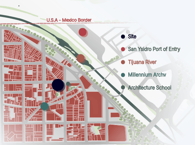

Step 7: Site Selection: Near the Border, Rooted in Opportunity
Once I chose Tijuana as the city, I knew I wanted my project near the U.S.-Mexico border—not just for proximity, but to send a message. The border is not only a line of division but a point of entry, tension, and hope. Some sites right along the line were too small for the scale I envisioned; I wasn’t designing for one household—I was designing a system to house many.
I remembered the first time I crossed into Tijuana and saw the tall steel arch rising above the city—a landmark known to many migrants. After researching its symbolic importance, I became convinced the site had to be nearby. Seeing that the San Ysidro border crossing—one of the busiest in the world—was just minutes away only confirmed that decision. Then I saw something unexpected: a school of architecture down the same street. That felt like a sign.
The site I ultimately chose wasn’t an empty lot—it was a dense, oddly shaped pocket of aging homes. Most buildings were one to three stories tall, made of worn brick or bare concrete, pressed tightly along narrow streets. Though not informal housing, the conditions often felt unregulated or overlooked. A few taller buildings—rising five or six stories—stood nearby, hinting at shifting urban pressures. The northern street was just wide enough for prefabricated module delivery and crane access, while the southern alley created a more discreet zone for services and mechanical systems.
It was space in need of love. And because of its constraints—awkward geometry, uneven density, embedded life—I knew the solution couldn’t be generic. I needed a model that had already made architecture out of constraint. That brought me to the vecindad.

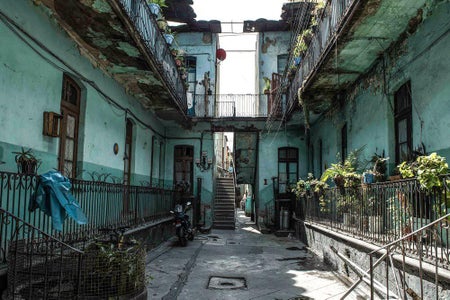

To root my project in Mexican housing traditions, I studied the vecindad: a historical model of urban communal living found across Mexico, especially in Mexico City and in northern cities like Tijuana. A vecindad isn’t just a building type—it’s a shared social infrastructure.
These complexes were typically arranged around central courtyards, with compact stacked units connected by open-air corridors. Kitchens and bathrooms were often shared, and units were modest—30 to 60 square meters—but life extended beyond the walls. Children played in the patios. Neighbors looked after each other’s kids. Elderly women cooked together, and informal economies formed between doorways.
Despite their richness, vecindades have often been dismissed in modern urban planning—viewed as overcrowded, underregulated, or tied to poverty. But these failures stemmed from neglect, not from the model itself. Their strongest principles—community trust, space efficiency, and everyday collaboration—remain deeply relevant.
This model didn’t just influence my thinking; it gave structure to the site. The irregular footprint and tight urban fabric demanded a design that could cluster units without losing life between them. The vecindad provided a system for organizing density while leaving space open and fresh—and for rooting the project in something deeply cultural, not imported.

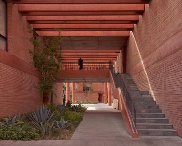

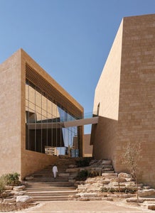

Atlas Soccer Team Academy (Guadalajara)
  1. Modular Grid and Structural Clarity:
The Academy’s clear column-and-beam grid organizes spaces and creates legible circulation paths, which inspired my structural assembly strategy and circulation-focused design.
  1. Blurring Interior-Exterior Boundaries:
Its use of open courtyards, shaded walkways, and landscaped plazas encourages community interaction and climate-responsive design, aligning with my walkways, planter cores, and passive cooling ideas.
  1. Material Honesty and Local Context:
The use of local red brick tones and pigmented concrete ties the building to regional identity and climate, inspiring my material palette and environmental integration with recycled water and greenery.

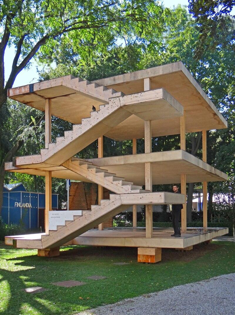

Le Corbusier’s Dom-Ino House (1914)
  1. Modular Structural System:
The Dom-Ino House introduced a simple, repeatable structural framework of slabs and columns without load-bearing walls, enabling flexibility in floor plans and future adaptation—directly influencing my modular prefab unit logic.
  1. Open, Flexible Spaces:
By removing walls, the design creates open, uninterrupted interior spaces, promoting versatile usage and circulation, inspiring my approach to spatial fluidity and multipurpose living cores.
  1. Prefabrication and Industrial Logic:
The Dom-Ino concept anticipated mass-produced, industrialized housing, mirroring the project’s goal to create an efficient, scalable, and prefab modular housing system.

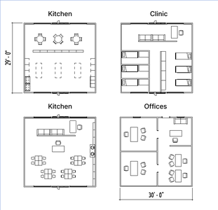

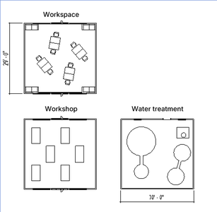

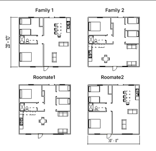

The design centers on two residential module types and a flexible suite of community modules—all crafted as Revit groups for rapid replication and adaptation:
  1. The Family Module accommodates four residents with defined private and shared spaces.
  1. The Roommate Module efficiently houses up to three adults with semi-private zones and shared amenities.
Complementing these are swappable community modules—clinic, daycare, water treatment, kitchen, workshop, storage, and administrative offices—that enhance livability and can be tailored to each site’s needs and budget. Prefabricated in two sections, modules are joined on-site and craned into place within the concrete frame.

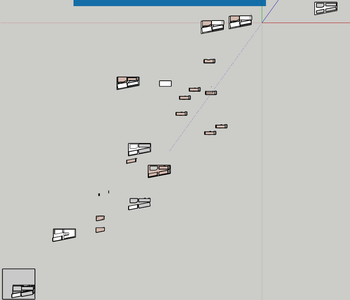

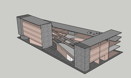

Step 18: From SketchUp to Revit: Shifting Gears, Scaling Up
This was the first time I let myself explore what the space could offer without overthinking the details. In the first SketchUp iteration, I created a loosely defined O-shaped layout—an enclosed ring that revealed its scale only after passing through a narrow, understated entrance. Inside, a partially formed structure sat at the center, not quite a building, more of a spatial anchor. To balance the quiet entry, I added a second, more open access point near what was imagined as the public-facing community center.
In the second iteration, I experimented with giving the smaller entrance a formal gateway, but ultimately removed it—the view into the courtyard felt more powerful without it. I also gave the central anchor more definition, evolving it into a formal building.

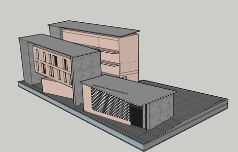

Step 19: Iteration 1–2: Unlocking the Site, Testing the Massing
The initial U-shaped massing framed shaded communal courtyards, balancing privacy with openness, yet felt too monolithic. By Iteration 2, adding a second floor and prefab stacking introduced modular rhythm, but the design still sought greater spatial variety and stronger ties to the site’s climate and community needs.

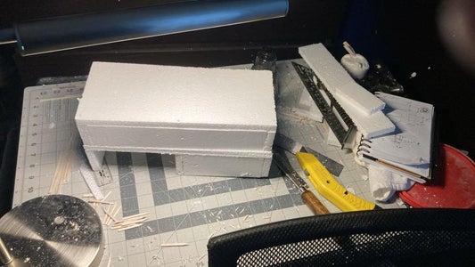

Step 24: Physical Models Part 1 — Early Massing Studies and Conceptual Exploration
I didn’t create just one physical model for this project—instead, I developed a series that documented the evolution of Fundamento Modular’s design, starting with early massing studies that helped clarify form, shadow, and spatial relationships.
The first two models, “Massing 1” and “Massing 2,” were built at a small scale using scrap wood and tools from my father’s workshop. Massing 1 translated an early SketchUp massing into a tangible form, allowing me to study sunlight and shadows across the site. I experimented with texture and height variation by cutting unique, randomized layers rather than stacking uniform floors, emphasizing overall mass rather than architectural detail. This tactile process confirmed the fundamental volumetric ideas and earned approval from firm I work at principal, giving me the confidence to continue.
Massing 2 refined the design, addressing issues like poor natural light penetration on ground floors. By testing reconfigured openings and building orientations, this model balanced passive cooling goals with livability. It translated digital problem-solving into physical form, clarifying how design decisions shaped the environment.
These early models were never meant as final presentations—they were experimental tools that shaped the design’s spatial and environmental logic through hands-on iteration. Together, they chart the project’s initial architectural journey, showing how physical modeling complemented digital work to solve complex challenges.

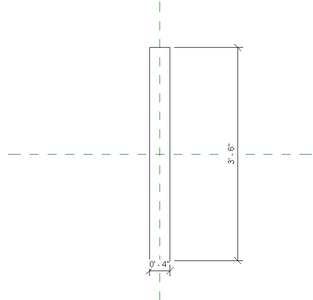

Step 28: Adaptive Facades Through Custom Parametric Families
The facade demanded adaptability to evolving design changes and site-specific conditions. To achieve this, I created a single parametric window family capable of resizing dynamically, eliminating the need to duplicate multiple window types as the facade proportions shifted. Inspired by Mexican brick patterns I discovered on Pinterest, I developed a custom curtain wall family composed of brick-patterned panels. This design cleverly balanced light penetration, ventilation, and privacy while reinforcing a cultural connection through its patterning. For the railings, rather than opting for traditional balusters, I engineered a custom railing profile that reads more like a low, solid wall. This minimalist design maintains compliance with safety codes while enhancing the building’s architectural language. The railings’ modular profiles were embedded into families, enabling easy reuse and integration throughout the project, thus maintaining consistency and efficiency.

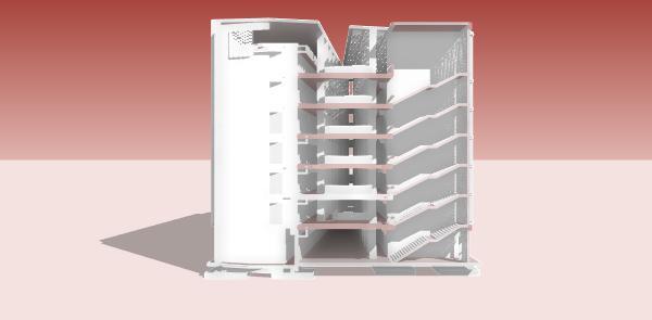

Step 30: Clarity Through Sections, Color, and Selective Emphasis
Clear communication of the complex program and structure was vital. I created section views that combined orthographic precision with perspectival depth to reveal spatial hierarchies. By applying halftone shading to less important elements, I visually de-emphasized them, while selectively highlighting key floors, program zones, and structural components using bold fills in the project’s signature blue. To avoid clutter, I substituted verbose labels with translucent color overlays paired with a concise keyed legend, improving legibility without sacrificing information. This graphic clarity extended into 3D views, which I tailored to highlight critical elements like stair circulation and the solar chimneys, allowing judges and collaborators to quickly grasp the design’s spatial and environmental strategies.

Step 38: Site Plan Development in Revit and Illustrator
The site plan’s foundation was developed in Revit, where I created precise hatch patterns for roads and buildings to capture the project's urban context accurately. These Revit-generated patterns were then exported and brought into Adobe Illustrator for advanced layering and refinement. In Illustrator, I traced over the base maps, adjusted colors, and added greenery, shadows, tags, and pins using separate layers. This two-step process combined Revit’s technical precision with Illustrator’s graphic flexibility, resulting in a clear, visually compelling site plan that effectively communicates the project's relationship to the surrounding environment and the border.

Step 43: Floorplans 1-4
Step 44: Floorplans 7&8
