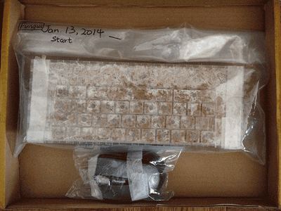

Step 3: Clean the Mold and Let the Mycelium Grow
- CLEAN the mold with 70% isopropyl alcohol! Sanitation prevents contamination.
- Then press mycelium materials into the mold, and tape it.
- Put the mold in a self-contained enclosure without direct air flow. I used a ziplock with small holes. Ecovative said "The mycelium grows best around room temperature (70 to 76 F)".
- Wait for 2 weeks. Patience.
