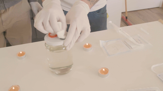

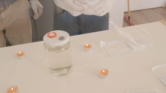

The lid of the jar will have two holes. They will be filled with two plugs.
The first stopper is self-closing and will allow the insertion of the syringe needle. The second is a filter cap for the respiration of the mycelium in the jar.
  • Take a jar and make the two holes using a drill (be careful, the diameter is not the same!).
  • Place a light dose of silicone gasket all around the hole of the filter cap
  • Arrange the plugs in the holes with the appropriate diameters.
  • Let the seal dry for a day
Your jar is ready for liquid inoculation!

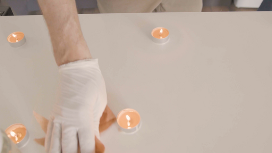

  • In your kitchen, turn on your hood and clean your worktop with alcohol.
  • Place tealights all around your work area.

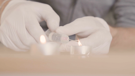

  • Light the candles and take your syringe of liquid mycelium out of the refrigerator, clean (alcohol 70°) and place it in the center of the work area.
  • Take your syringe and needle out of their bag. Insert the needle.
  • Take your jar of liquid culture, clean the outside of this jar with 70° alcohol and place it in your work area.
  • Take two sterile compresses and soak them in alcohol.
  • Place the needle of your syringe on the flame of one of the candles and wait for the tip to turn red.
  • Then place it between the two compresses soaked in alcohol.

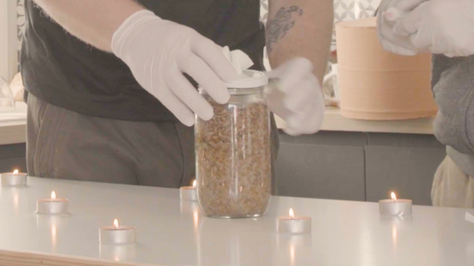

The liquid inoculation is carried out on the clean substrate. Either the substrate is in a jar (as in the pictures) or the substrate is contained in a grow bag. In both cases, the mycelium must be able to breathe.
  • If you choose a jar, pierce its lid and clean it with 70° alcohol. Then place a sterile compress in the hole.
  • In your kitchen, clean your worktop with alcohol.
  • Turn on your hood and place tealights all around your work area.

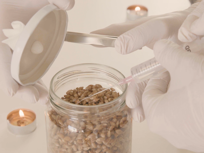

  • Take your bag/jar of sterilized grains, clean the outside of this bag/jar with 70° alcohol and place it in your work area.
(Be careful that the filter/compress does not touch alcohol)
  • Open your bag/jar in the work area and completely empty the mycelium from your syringe onto your seeds.
  • Close the bag/jar immediately by folding the top and attaching your clothespins.
