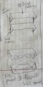

Upon consideration of my problem statement, I constructed 3 different design concepts shown in order from left to right, to solve my given problem.
Concept 1 was simply a fully 3d printed wall mounted shelf in which I can place either my Funko pops or other action figures that I have on them and save space from them being scattered across the floor. I wanted this to be a unique design from all the basic rectangular and flat pieces commonly found on amazon.

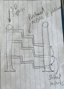

Concept 2 was a more intricate idea as I would buy acrylic Z platforms and insert them in the holes of a 3d support bracket which not only saves more room as it has 9 different spots to place things but also looks unique.

To choose a concept design, a decision matrix was constructed to figure out which concept fits my needs best and I scored it accordingly. The original "design" or solution was just putting my Funko pops on the floor which took up too much space and overall unpleasant to look at. Thus, out of the concepts I sketched up previously, the decision matrix pointed me to design my 3rd concept in which I have 3d printed supports with wood planks inserted in them.
