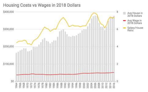

With the rise of housing prices, many are forced to turn to smaller and smaller living spaces to afford rent. As a result, micro apartments are becoming more and more prominent in large cities like New York, and they require a lot of things to be taken into account. This instructable will examine the steps taken in creating, designing, and rendering a micro apartment room.

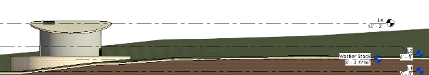

Step 2: Creating the Model
I used Revit to model the building, as I’m much more familiar with it than other architectural softwares. To begin, I planned out all the levels of the model so I could fit everything in its place. I added a second floor 6’ 9” above the ground level so that the first floor would be comfortable to walk around in.

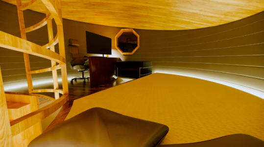

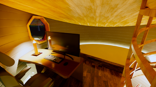

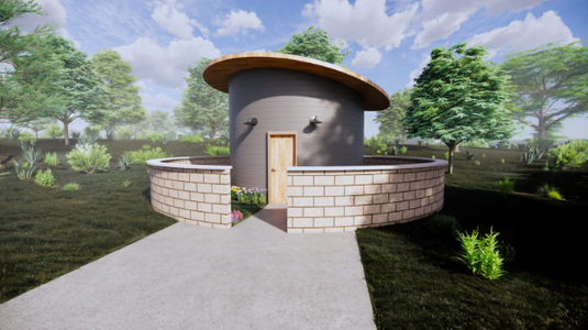

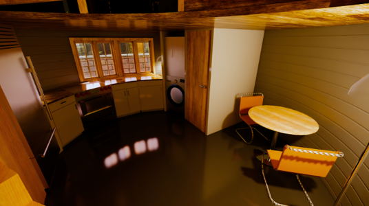

Step 3: Rendering
Before I could make my rendering, I made sure to do some landscaping around the house to make it look more natural from the ground level. I then used Enscape to add a significant amount of greenery to the surrounding landscape, primarily bushes, trees, and patches of grass. I picked a handful of angles that captured key aspects of the house and changed Enscape’s settings for brightness, fog, color, etc. to make the rendering look as realistic as I could.

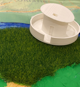

Step 4: Physical Model
In order to make the physical model, I created a version of the project that only included the house and outer wall and made it into an STL file, which I then uploaded to one of my high school’s 3D printers for creation. I got my print and placed it on a small patch of fake grass near a play-dough river.
