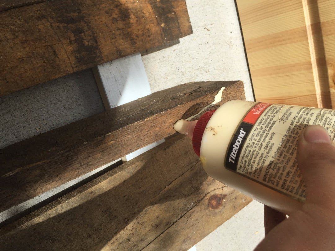

Anways, so first what I needed to do what glue together the piece of pallet wood to match the table's dimension. But I didn't have clamps so what I did was I make myself homemade clamps which I saw on YouTube a while back.
(YouTube)<--link. If you're too lazy to click on the link, the clamp basically consisted of two long piece of wood, and two rectangular/square piece on each end of each wood piece. The table top pieces are laid on top of the two pieces of clamp wood and the square pieces are screwed into the clamp wood at the edge of the table top pieces, but leaving a bit of space. The extra space is there so you could hamper pieces of angle smaller pieces of wood, resembling a door stopper. It easier to understand if you just click on the link :D
I tried to glue the pieces of wood together but when I went to pick it up a while later, the glue didn't hold. So I took it apart and ran the edges through a table saw and glued it together again. The reason why it didn't hold the first time is:
a. I didn't let it rest long enough
b. I didn't stripped the crusty wood edges that's been exposed to the element which made it harder for the glue to penetrate the wood pores and bond to the other piece.
