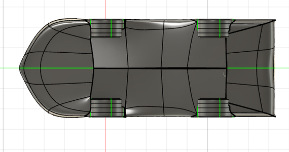

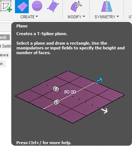

First, Edit Form and click onto the XY axis. Create a rectangle 400x200mm big.

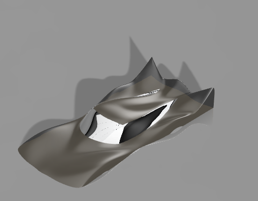

Step 2: Creating the Main Body
Then edit the rectangle, making a shape like the one shown above. You can do this by selecting panels and pulling them out with the edit form tool. Do not make a new T-Spline, or a new face, because then it won't work the way it's intended to. You will also need to learn how to make T-Splines, so check youtube for this.

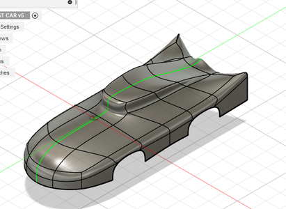

Step 3: Creating the Fenders
Then make the wheels by taking out panels. This will give it a curved feel. We'll get to making the chassis closer to the ground in a few steps.

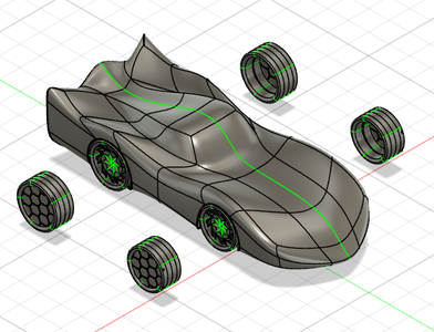

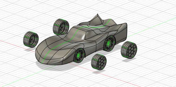

Step 4: Creating and Adding the Wheels

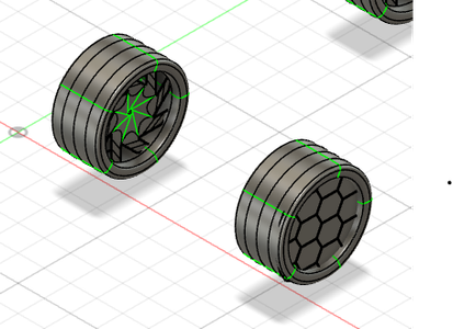

Make some wheels, it doesn't need to be very detailed. Here I made 5 spoed wheels, but I also made 8 spoked ones and hexagonal bee type ones. One mistake I made was that I took out the line connecting the windscreen and the bonnet. I've added some of the new wheels I made, and personally I made the back wheels a bit bigger than the front ones.

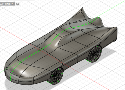

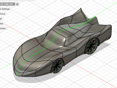

Step 5: Lowering the Car
Now bring the whole car down. It should be lowered so it looks like the wheels push the fenders up. Make the nose pointy, as well as the back spoiler. If you are wondering, I did make another wheel 👌

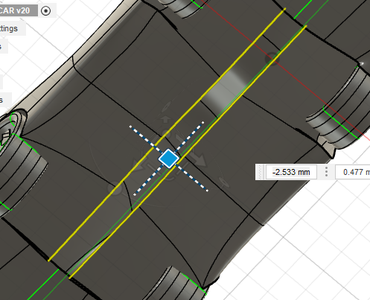

Step 6: Underside of the Car
Now you need to make the underneath of the car. It shouldn't connect fully because that will create an error when finishing the form. Use the above pictures to help with alignment.

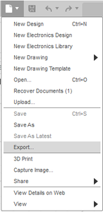

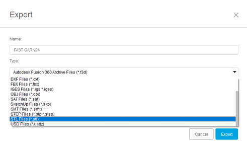

Step 7: Exporting From Fusion 360
These images show you what you should do. In tinkercad, please see the next step.

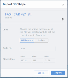

Step 8: Importing to Tinkercad
Follow the steps shown in the images. It should eventually load, just that unpacking a compressed file would mean that not all curves will be shown well, etc. Tinkercad can only be used to some extent, but it can't be used for making curve-heavy objects.

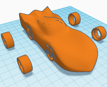

Step 9: End Product
The end product! Yours will most likely be very different from mine, but it will be a basic car.
