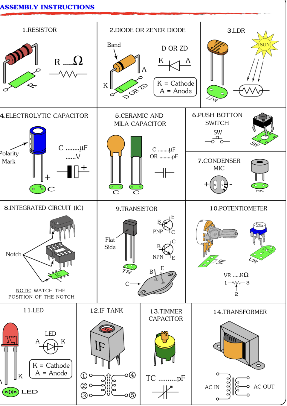

Step 1: Annotating and Preparing All Components
  1. Lay out all the parts on a white piece of paper
  2. Label resistors, check color codes, and the value of each resistor.
  3. Mark capacitor +/– polarity and diode orientation.
  4. Keep all the components organised before soldering. (All Images from Future Kit)

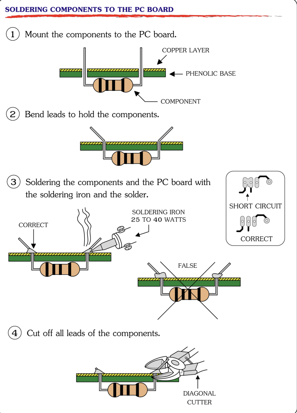

Step 3: Soldering the PCB (LOWEST TO HIGHEST COMPONENTS)
  1. Start with the lowest, smallest components then move on to the larger components gradually.
  2. Insert resistors, bend legs slightly to hold them in place, and trim leads after soldering each resistor.
  3. Insert diodes (check polarity), and solder.
  4. Insert small capacitors (ceramic + electrolytic), check polarity, solder.
  5. Insert transistors (C1815, C9012), solder.
  6. Insert photo-resistor + LED (long leg = +), solder.
  7. Insert trimmer potentiometer (104), solder pins.
  8. Solder wires for speaker and 9V battery holder.

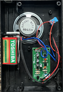

Step 5: Preparing the Box for My Project
  1. Find a box that fits PCB, speaker, and battery.
  2. Use a hand drill and drill a 5 mm hole for photo-resistor, 6 mm hole for switch.
Step 6: Inserting Components Inside the Box
  1. Insert photo-resistor + switch into drilled holes.
  2. Hot-glue speaker to box wall.
  3. Fix PCB + battery holder with double-sided tape.
  4. Extend LDR with male/female jumpers if short.
  5. Add heat shrink to battery/switch wires.
Step 7: Final Assembly and Testing
  1. Close box carefully.
  2. Reconnect battery.
  3. Cover LDR = silent, light on LDR = alarm.
  4. Replace oversized battery holder with smaller clip if it doesn't fit.
  5. Optional: seal box with hot glue if you want to shut it at all times.
