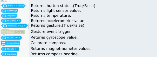

There are multiple onboard sensors on Futureboard.
Step 1: Onboard Sensors Blocks
Please check out.
