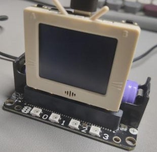

The FutureBoard can be used with a Robotbit to add powered functions to your creations.

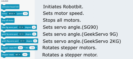

Step 1: Robotbit Blocks
Please check out

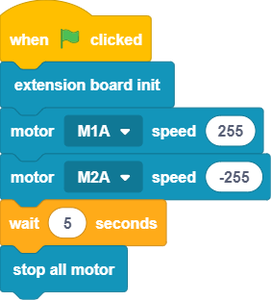

Step 2: Sample Program: Motors

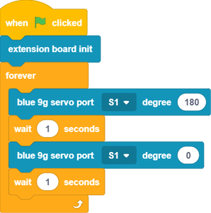

Step 4: Sample Program: Servos

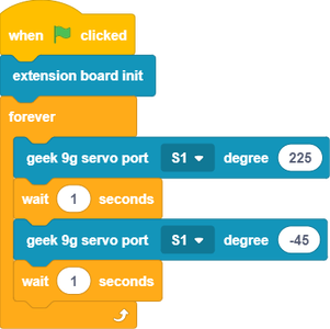

Step 5: Sample Program: GeekServo 9G

The FutureBoard will stop running any code that has Robotbit code when it is not installedon a Robotbit.
