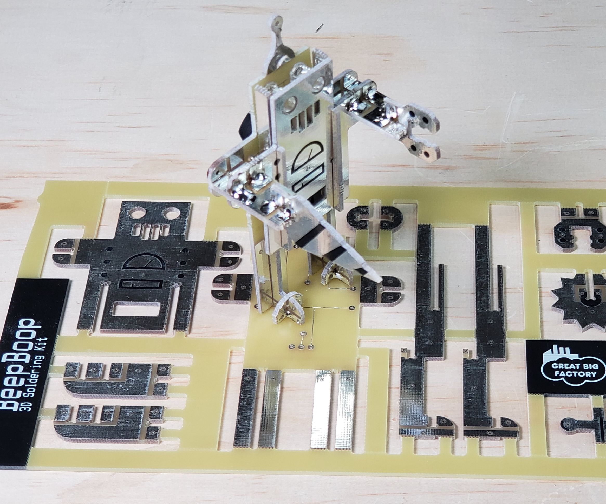

Step 1: Snap Out the Parts
There are "mouse bites," or little rows of holes, anywhere that you're supposed to snap the boards apart. Some people can do it with their hands but we suggest using a pair of pliers and gripping as close to the mouse bites as you can. Just bend or twist the connection to snap them apart. You should end up with two halves to a rocket.
Step 2: Fillet Soldering
Now you can slide the two halves of the rocket together, but there is a wrong way and a right way! Make sure that yours matches the pictures here such that the oval-shaped footprint for the battery holder is underneath the rectangular cutout. That way, the battery will fit through.
Next, fillet solder the two sides together using the semi-circular pads near the top of the rocket. It helps to put a little dab of solder on the tip of your iron to transfer the heat, then you can use that to heat up one pad and add a big glob of solder to that. Once you have a glob of molten solder on one side of the fillet, just drag your iron into the corner to jumper the two pads and make your connection!
Repeat this step for at least two opposite corners and the structure is finished, now let's move on to the electronics...
