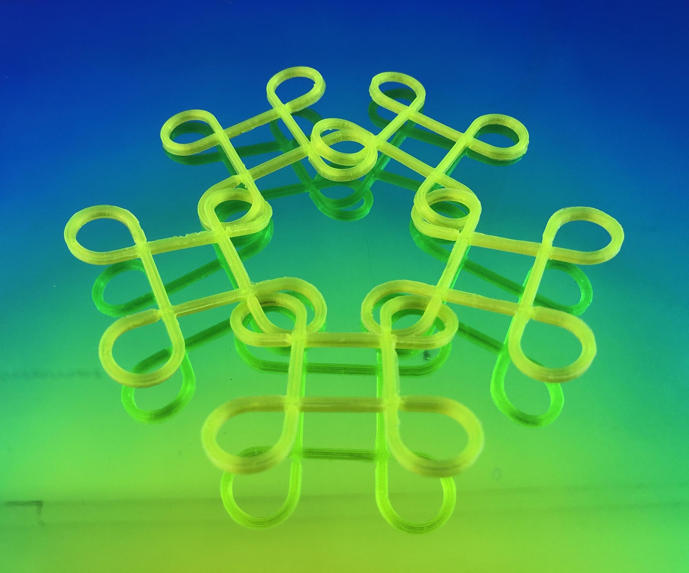

Step 2: 3D Printed Fabric

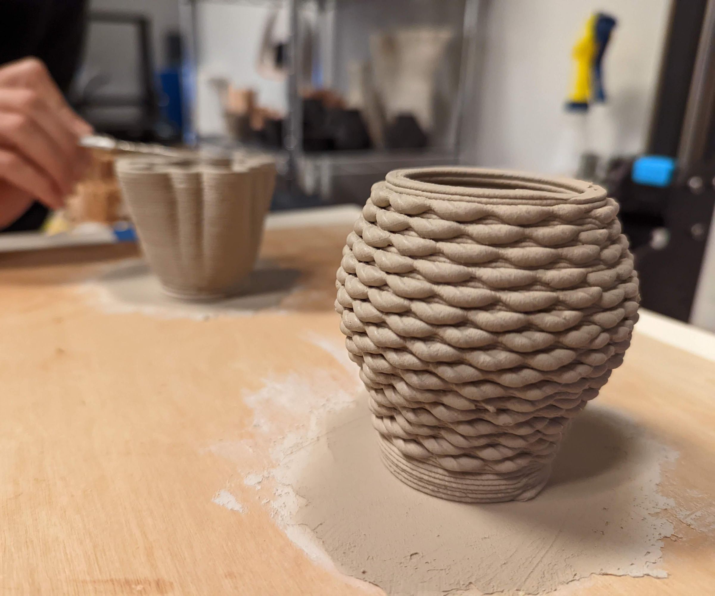

Next, I tried the printedFabricSimplified.gh and printedFabricComplex.gh examples. I added more pillars and more height. I shrunk the corner pillars to see if I could save time and filament, which worked fine on the first smaller swatch, but began to gradually fail on the larger swatch. It still held it's structure, and didn't show after I trimmed the supports off. I should have attempted to generate more complex weavings, such as over one under two, but I kept exploring other code examples.

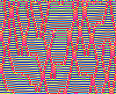

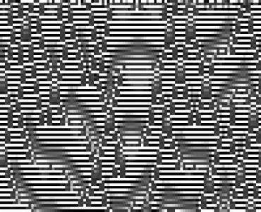

I had an idea to attempt to generate cellular automata with an online generator through Wolfram, and then I imported that image onto a form through an online lithophane generator. I was happy with this form, and attempted to slice it with SimpleSlicer.gh, but it was such a large mesh that Grasshopper kept crashing. I gave up after many instances of staring at the beach ball of doom, and decided maybe someday I will try to slice the STL in Cura. I added some images of the model rendered in Blender to help visualize.

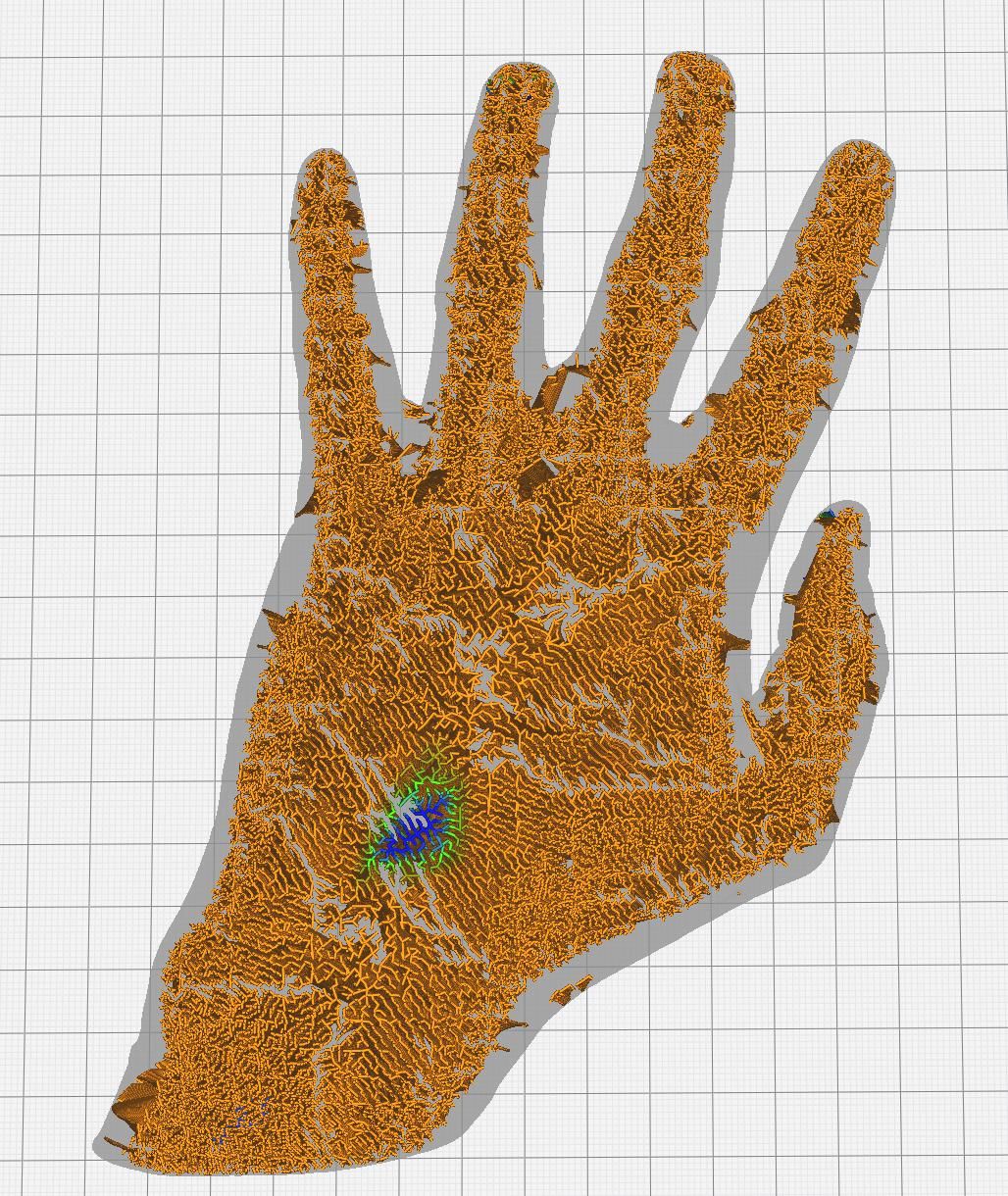

Step 5: Failed Fabric
I attempted to import one of my STLs from Week 1, and transformed it into a fabric through an array modifier. I made 10x10 and 4x4 iterations, but they were both very large files that took a long time to process. Even just trying to reimport the 10x10 STL crashed Rhino. I was able to export G-code of the 4x4, but it totally failed on the print bed. The extruder was tracing tiny little pathways that did not adhere to the print bed and just lumped up on the nozzle, rather than laying the entire pattern layer by layer. Again, I didn't know how to solve this with just G-code, and decided to try again with Cura at a later date.
