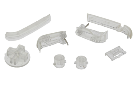

GBA clear frame: https://www.aliexpress.com/item/32727101340.html?s...

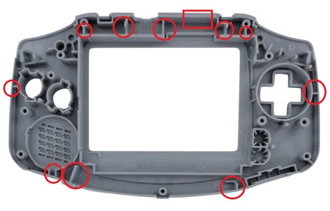

3. Use the pliers to remove the plastic tabs on the shell indicated by a red circle. For the power switch hole, i'd recommend using a drill first, the using a sharp blade to give a nice finish
4. (optional) Use a bit on sandpaper on the clear sides of the GBA case to get a better lighting diffusion.

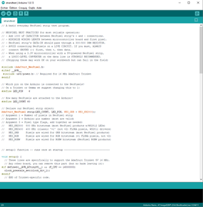

Step 2: The Code
For this part, you don't need to know how to code. I don't.
Start by downloading the Arduino IDE and install it: https://www.arduino.cc/en/software
Then, download the Adafruit Neopixel library: https://learn.adafruit.com/adafruit-neopixel-uberg...
Open the Arduino IDE. We'll be loading the code from the Adafruit Library. In order to do that go to
File > Examples > Adafruit Neopixel > strandtest.
Edit the following lines:
#define LED_PIN 6
#define LED_COUNT 6
That's it for the code! You'll get multiple light effects from this code that will cycle automatically!
Now we'll upload the code to the arduino. Before connecting the Arduino to your PC, on the Arduino IDE go to Tools > Port and check what COM ports are available. Now connect your arduino nano, go to Tools > Board, select Arduino Nano, once again to Tools > Port, and you should see a new COM port. That's your Arduino. Select it.
Now you just need to upload your code to the Nano. press the 2nd button (under Edit) to upload your code.
If you get an error, under Tools > Processor change it to the ATmege328P (old bootloader) and upload it once again.

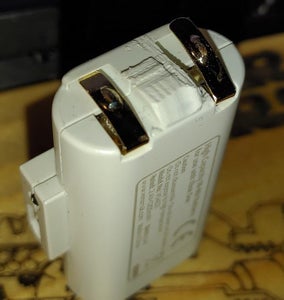

Step 5: Rechargeable Battery (BONUS)
You might have noticed that my GBA is equiped with a rechargeable battery. This mod is very simple.
For the battery, I'm using this XBOX One Controller battery . As you can see in the picture, you will need to remove the positive pad from its lodging in order to make contact with the positive pad on the GBA. You need to remove some plastic on the shell too.
Now you need to cut a slot on the battery cover in order to close it and voilà! A rechargeable GBA
