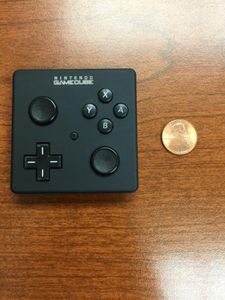

First I want to tell you guys about my motivation for completing this project. In the last couple of years i have been wanted to become an electrical engineer, and have since been taking classes at FIU (Florida International University) to pursue that dream. In my spare time I got sucked into the portabilizing world (you can find out about it on this website) Bitbuilt and ended up making a Wii laptop that I could play wherever I wanted. It also aligned with a lot of the practical engineering skills i was learning about in the classroom. I found however that even though I loved the feel of my OEM controller, it was super bulky, and I often would end up playing Gameboy games on my phone instead of packing all the stuff that I needed to play the Wii laptop. My original plan was to somehow embed the controller somewhere onto the laptop so it could be one unit, and then I could remove it when I was ready to play but that became too complex too fast. I then decided to try and just make the smallest GameCube controller I could that still had a form factor that was comfortable.
The Gameboy SP was my childhood Gameboy, so I thought it would be the perfect form factor for a mini controller. So with this general idea in mind I created the below goals that I wanted to meet with my controller:
  1. To have a full featured GameCube controller minus rumble using a pic micro controller
  2. To use 3ds sliders as they are the flattest joysticks i could find
  3. To utilize the DS Lite buttons, membranes, shoulder buttons, shoulder tact switches, springs, screws, and the trimmed motherboard to use as the contacts.
  4. To simulate the analog triggers with a dual tactile switch system
  5. To design the shell in a CAD program like Fusion 360 and to 3d print it.
  6. To make the size in all dimensions as small as possible. (it ended up being 63mmx63mmx12mm)
  7. Minimal amount of hot glue!
  8. For it to look good. I like the all black look.

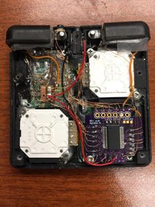

Step 6: GC+ Micro Controller
This part was a whole new world for me, I had never flashed a pic micro controller before. This part was crucial though to get everything in the small form factor that I needed.
First you are going to want to populate the board with the proper components. Since we will not be implementing the rumble feature in this build, we are able to leave off some of the components. I have those circled in red. You will want to populate the rest of the passive components as these are the pull up resistors and smoothing cap for the power supply.
Having a hot air station is helpful for this, but you can also use a soldering iron with a fine tip or do some drag soldering with some flux. I watched a couple YouTube tutorials and did the drag soldering method, it turned out well! Just make sure you clean up your board with some IPA afterwards as the flux can leave some residue
Once you have the board soldered up, it is time to flash the PIC chip! I followed the below instructions on the bitbuilt website:
https://bitbuilt.net/forums/index.php?threads/how-to-program-your-gc-board.2541/
You will need to use the hex file found at this Github:
GC+ Github https://github.com/Aurelio92/GCPlus
After you have confirmed that is successfully flashed, you will then want to trim the board so that it will fit in the 3D printed enclosure. The picture I have here has the top right part trimmed out, I wouldn't recommend doing that if you guys tackle this project.
Step 7: Assembly
Now we get to put it all together!
First you are going to want to place the buttons, D-pad, start button, their respective membranes and screw the trimmed motherboards into place with the left over screws from the DS lite.
Then you will want to put in the 3ds caps and Sliders and screw those in too. You will need to cut off the flex pcb coming of the sliders as we will be soldering to those eyelets. You will also need to sand the main stick slider a little bit so that it will fit in the overhang where the screw to close the case goes
if anything is loose, feel free to secure it down with some hot glue.
next we are going to screw in that cross bar that is over the D-pad pcb and will hold the microcontroller pcb.
After that we will screw in the little bracket over the ABXY button board that will allow us close the case.
You can then plop in the SMD audio jack and secure it in there with a little glue. the little bracket is then glued and screwed into it to secure
Next we will want to super glue in the clicky tact switch trimmed from the ds lite and the grey squishy tact switch in their respective places as shown in the pictures. you will want to also to cut off two of the legs and get them as flush as possible.
You will also want to cut off the little post inside the trigger that used to actuate the switch on the DS lite. there will be some trial and error but you will put some tape in its place until you have the correct action, a half press that triggers the grey squishy switch and a full press that actuates the clicky switch.
After you wire the trigger buttons, you can then place the triggers with their metal rod and spring just like it was in the original DS Lite
Step 8: Wiring
Next is wiring all of the contacts to the microcontroller! Most of the buttons are referenced to ground, so you will connect one end of the switch to ground, and the other to its respective pin on the micro controller.
you can see in my final wiring picture that I scraped off some of the solder mask on the ground plain to give more areas to connect to ground. Wire management is key here! Using your tweezers will help getting the cleanest outcome.
You will need to refer to this link when wiring the contact and what each pad does.
https://bitbuilt.net/forums/index.php?threads/gc-documentation.695/
"L" and "R" are referenced to 3.3V so make sure you wire that up correctly. For example, the grey squishy tacts will have 9ne leg connected to L and the other to 3.3v
Also, since this orientation of the 3ds sliders is not the normal, we will have to swap the x and y axis to their respective pads. The picture shows what is traditionally the pinout, in our circumstance we need to make sure that:
x-axis on main stick slider -> SY on GC+ pcb
y-axis on main stick slider -> SX on GC+ pcb
x-axis on c stick slider -> CY on GC+ pcb
y-axis on c stick slider -> CX on GC+ pcb
We will be able to adjust the stick settings later in the Wii homebrew configurator included in the GitHub
Also we are wiring up this audio jack in a very unorthodox way. I decided on this convention so that the 3.3v doesn't accidently get shorted to any of the other lines when you are inserting the custom GameCube cable that we will be making later on.
I have also provided a picture of my finished wiring and what you can expect yours to look like.

Step 10: Configuring the Controller
Since 3ds sliders are not the typical joystick for the GameCube, the creator of GC+ Made a Wii homebrew application to configure the joy sticks. I won’t get to much into this as there is so much information about Wii homebrew, but essentially you will want to hack your Wii to get the homebrew channel, and then add the firmware from the GitHub to then tweak the settings.
After all of this, you should have a fully functioning mini GameCube controller minus the rumble to play anywhere you want!
