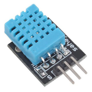

  • DHT11 Temperature & Humidity sensor

  • Connect DHT11 Sensor pin [VCC] to Arduino pin [5V]
  • Connect DHT11 Sensor pin [GND] to Arduino pin [GND]
  • Connect DHT11 Sensor pin [S] to Arduino digital pin [2]

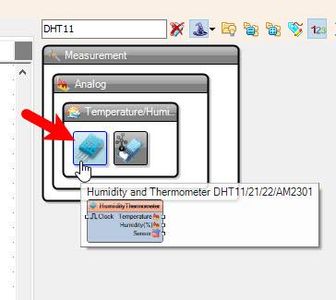

Add "DHT11" component

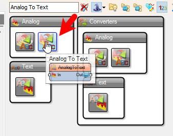

Add 2X "Analog To Text" component

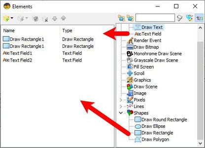

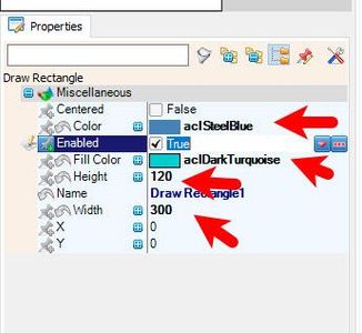

  • Double click on the "Display1" and in the "Elements" window drag "Draw Rectangle" to the left side and in the properties window set "Color" to aclSteelBlue, "Fill Color" to aclDarkTurquoise, "Height" to 120, "Width" to 300

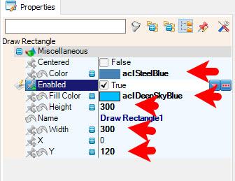

  • Drag another "Draw Rectangle" to the left side and in the properties window set "Color" to aclSteelBlue, "Fill Color" to aclDeepSkyBlue, "Height" to 300, "Width" to 300, "Y" to 120

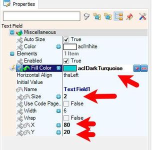

  • Drag "Text Field" to the left side and in the properties window set "Size" to 2, "Fill Color" to aclDarkTurquoise, "X" to 80, "Y" to 20

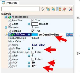

  • Drag another "Text Field" to the left side and in the properties window set "Size" to 2, "Fill Color" to aclDeepSkyBlue, "X" to 80, "Y" to 125

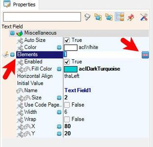

  • For both Text Field elements in the properties select "Elements", click on the 3 dot button and in the "Elements" window drag "Font" to the left side and in the properties window set "Font" to Adafruit\FreeMonoBold18pt7b or any other font
  • Close all the windows
