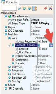

Select TTGO T-Display ESP32 board and in the properties window expand "Modules>WiFi>Connect To Access Points
  • Click on the Connect To Access Points 3 Dots

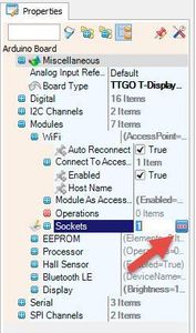

Select TTGO T-Display ESP32 board and in the properties window expand "Modules>WiFi>Sockets
  • Click on the Sockets 3 Dots
  • In the "Sockets window" drag TCP/IP Secure Client (SSL) to the left
  • In the properties window set Host to: api.openweathermap.org/
  • Close the "Sockets window"

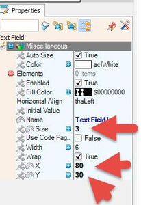

  • In the "elements window" drag "Text Field" to the left side and in the properties window set size to 3, "x" to 80 and "y" to 30

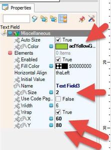

  • In the "elements window" drag "Text Field" to the left side and in the properties window set size to 2, "x" to 90 and "y" to 60 and color to "aclYellow"
  • In the "elements window" drag "Text Field" to the left side and in the properties window set size to 2, "x" to 60 and "y" to 80 and color to "aclYellowGreen"

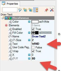

  • In the "elements window" drag "Draw Text" to the left side and in the properties window set size to 2, "y" to 80 and text to "WIND"

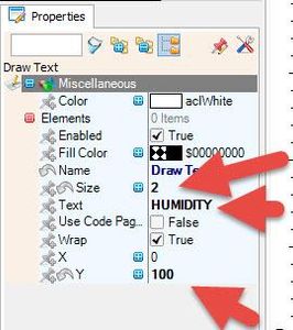

  • In the "elements window" drag "Draw Text" to the left side and in the properties window set size to 2, "y" to 100 and text to "HUMIDITY"

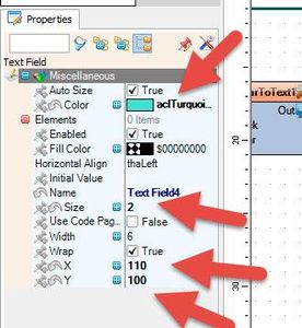

  • In the "elements window" drag "Text Field" to the left side and in the properties window set size to 2, "x" to 110 and "y" to 100 and color to "aclTurquoise"

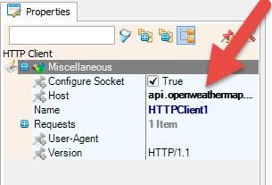

  • Add "HTTP Client" component
  • Select "HTTPClient1" and in the properties window set Host to api.openweathermap.org

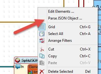

With the mouse right click on the "SplitJSON1" and in the menu click on the "Parse JSON Object.."
In the "JSON Object" window paste this sample code(avalible on https://api.openweathermap.org/data/2.5/weather?q=Berlin&units=metric&APPID=YOURAPIKEY
Replace YOURAPIKEY with your API key that you got in your account
Or copy paste the following:
{"coord":{"lon":13.4105,"lat":52.5244},"weather":[{"id":800,"main":"Clear","description":"clear sky","icon":"01d"}],"base":"stations","main":{"temp":25.91,"feels_like":25.5,"temp_min":24.99,"temp_max":27.16,"pressure":1010,"humidity":36},"visibility":10000,"wind":{"speed":1.79,"deg":303,"gust":7.15},"clouds":{"all":0},"dt":1624722776,"sys":{"type":2,"id":2011538,"country":"DE","sunrise":1624675484,"sunset":1624736011},"timezone":7200,"id":2950159,"name":"Berlin","cod":200}
Close the "JSON Object" window
"SplitJSON1" component will now create new pins
