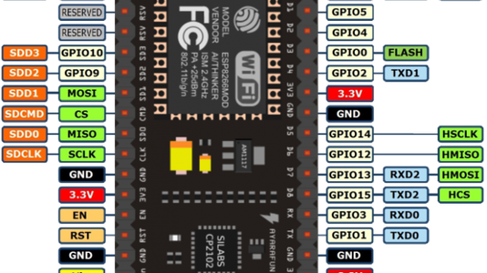

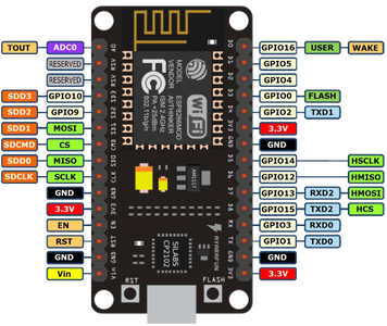

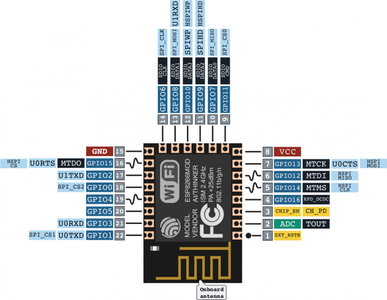

Step 8: Pin Map for ESP-12E Board
Above Images Show the Pin Map for ESP-12E Board
Step 9: NodeMcu Development Board:
An open-source firmware and development kit that helps you to prototype your IOT product within a few Lua script lines. Open-source, Interactive, Programmable, Low cost, Simple, Smart, WI-FI enabled

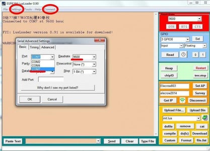

Step 11: How to Use Lua Loader? Step-1
*Open the LuaLoader, click the menu “Setting”, choose the “Comm port Settings”, and it will popup a “Serial Advance Setting”, set up the right port here then click the “Connect” button on the top of the menu.
When the information “Connected to COMX at 9600baud” is displayed on the debug window, it means connection is successful, and you can input command statement into the below edit box. (Follow in Step-2 of How to Use Lua Loader)

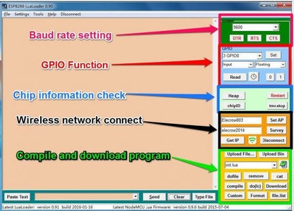

Step 12: How to Use Lua Loader? Step-2
When the information “Connected to COMX at 9600baud” is displayed on the debug window, it means connection is successful, and you can input command statement into the edit box shown in the image
Also, you can use some of the function which display on the right side of Lualoader interface.
- Baud rate setting: set the baud rate that you need , normally set at 9600.GPIO
- Function: Choose different GPIO port, set its mode(Input, Output or Interrupt ),set GPIO Pull up resistor (Floating, Pull up or Pull down), and “Read” or “Write” operation to the GPIO port
- Chip Information: Check the information about the chip or restart the NodeMCU.
- Wireless network connect: Enter the wireless network account and password, you can connect it and get the IP.
- Compile and download program: First, click “Upload File…”upload the .lua file that you want to download. Secondly click “compile” to compile the .lua file, through the compile can click “Download” to download the program.
