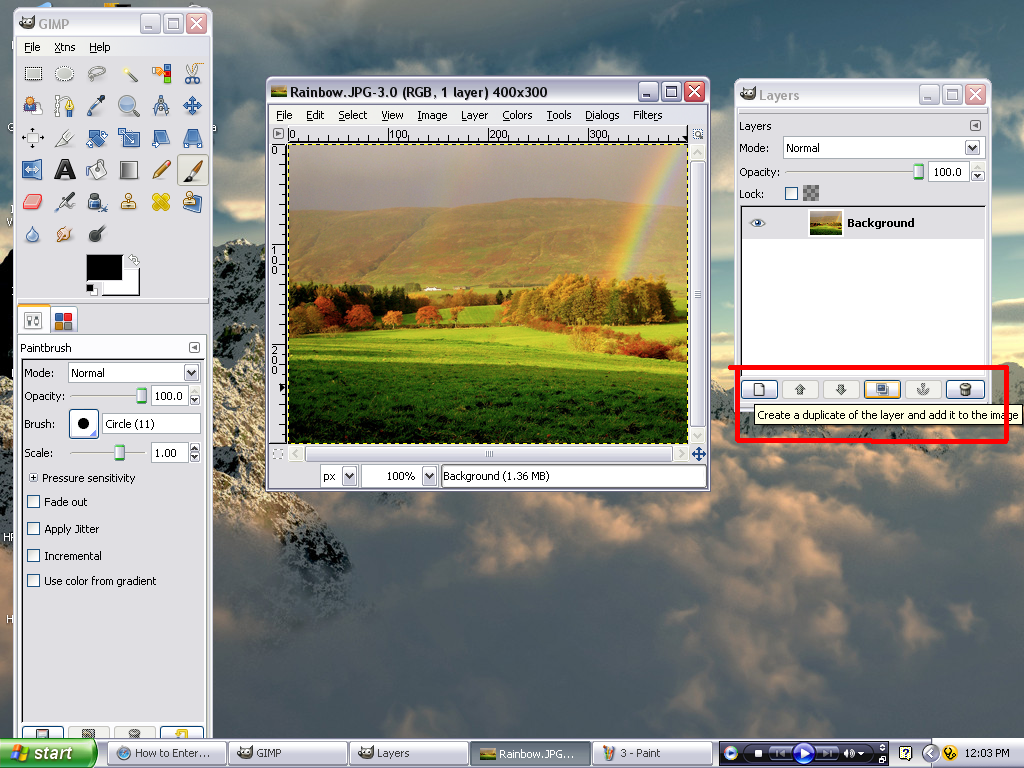

Step 2: Duplicate the Image.
Now in the Layers menu click the button that duplicates the image.
If your Layers menu isn't open:
1. Click File
2.Go to Dialogs
3. Click Layers
Or do Ctrl+L
