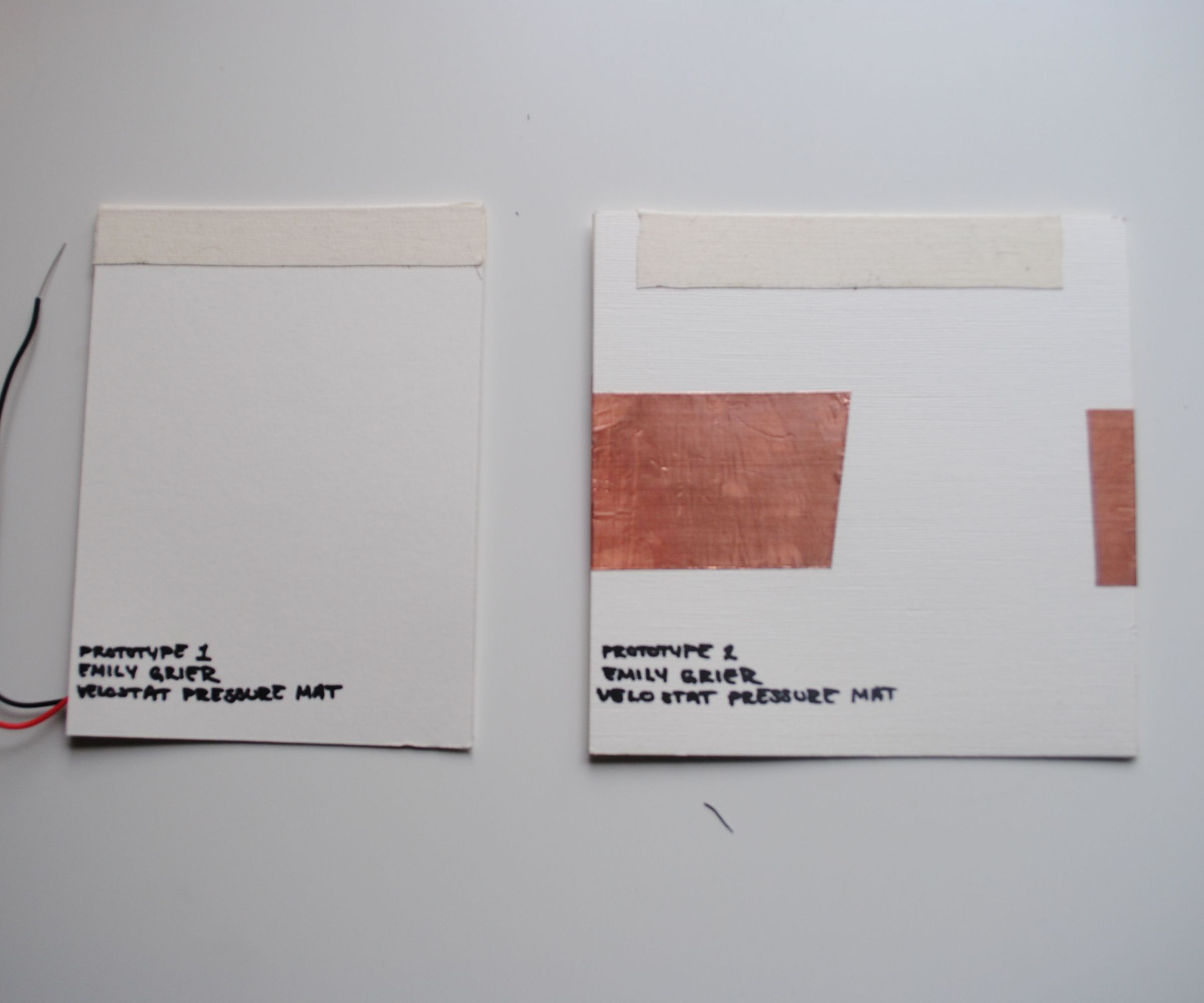

The best thing about velostat is that it's super easy to make things with. I did a bunch of testing on how to best attach all my sheets together but in the end decided taping was the best option. As my mother would say, "keep it simple, stupid." My mother loved me very much, evidently.
I used black electrical tape, and just taped along the edges of each of the sheets until it was one big ol' sheet o' velostat.
Now is the time to get your copper on your mat. The best technique I found was to apply the tape little by little, only peeling a few cm of the backing off at a time. Otherwise it curls back on itself and sticks to everything, which will make you want to give up on doing the whole darn thing in general.
A more extensive explanation of the technique is available on my Homemade Pressure Sensor instructable if you want additional tips.
It's not pictured, because I was running out of tape, but you'll want to cover most of the mat and vinyl in copper tape. Make sure it's not wider than the velostat, but it should cover a good majority of it. This is because even though the velostat is all taped up, they're still separate pieces, so you want at least a bit of copper from each side of the mat to be touching the velo.
Once that's all done, pick a side to tape your velostat sheet to! Make sure it doesn't go over the sides of your mat. I found that I had to cut mine a little to get it just smaller, leaving a little of the mat and vinyl overhanging.
