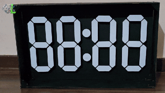

This clock Three o'clock is designed as a fully custom, modern 7-segment digital display built using NeoPixel LEDs Horizontal traffic light and an ESP32 microcontroller. Each of the seven segments for every digit is individually 3D-designed and printed to form a modular, easy-to-assemble display structure. The segments are shaped to match the traditional 7-segment layout—a, b, c, d, e, f, and g—and each piece is printed in black to minimize light leakage.
To create a smooth and even illumination effect, every segment is fitted with a 3D-printed white diffusing cover. This cover softens the LED brightness, eliminates hotspots, and gives the clock a clean, professional appearance when lit.
The electronics are driven by an ESP32, which controls the timing, animations, and color effects of the NeoPixel LEDs. Power is supplied through a buck-boost converter, ensuring the LEDs and microcontroller receive a stable voltage regardless of input supply variations.

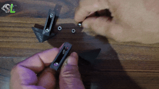

For the physical enclosure, a frame and base are built from MDF sheet, cut into four pieces to form a rectangular body around the display. These pieces are connected using 3D-printed corner brackets and secured with screws, giving the structure strength and ensuring precise alignment. The combination of MDF and 3D-printed components results in a robust, clean-looking frame that highlights the glowing digital segments.
Overall, the design blends 3D printing, electronics, woodworking, and LED diffusion techniques to create a bright, attractive, and highly customizable digital clock suitable for any workspace or home setting.

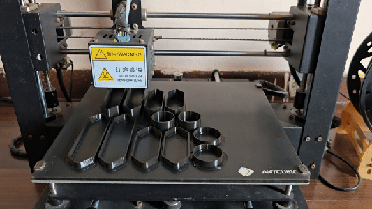

Step 2: 3D Printing the Segments
Each of the seven segments—a, b, c, d, e, f, and g—was first designed in Autodesk Fusion 360.
The shapes were modeled to match the proportions of a traditional 7-segment display, with hollow interiors to house the NeoPixel LED strips. Mounting slots and alignment edges were added to ensure that each segment fits together accurately when assembled.
Person cartwheelingActions required:
Using the provided 3D design files, start by printing all the segment pieces in black PLA. Black works great because it prevents light from leaking out of the sides and keeps the glow focused through the diffuser.
For the segment sizes:
  1. The b, c, e, and f segments are all the same size. I used Segment.stl for these.
  2. The a, g, and d segments are also the same size, but slightly smaller than the others. For these, I used SmallSegment.stl
  3. For the colon dots (: ), I used a circular piece with a diameter of 29mm, which matches nicely with the digit proportions and the file is dotBody.stl
Feel free to use the same dimensions or tweak them based on how big or small you want your digits to be. Larger digits look impressive but require more LEDs; smaller digits are easier to mount and power.
Each segment also has a matching white diffuser designed to soften the LED brightness and give a clean, uniform glow. Print these diffusers in white or translucent PLA.
Similarly for the diffusers the files are whiteCover.stl and SmallWhiteCover.stl

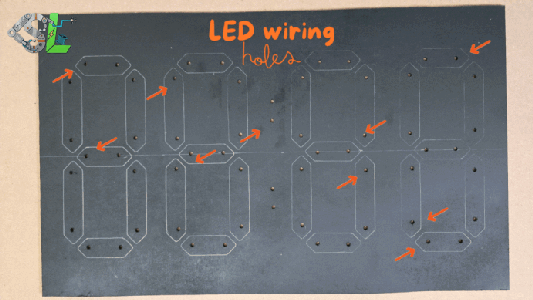

Step 5: Drilling and Spray Paint
Take your 7-segment stencil(we printed in previous section) and begin marking the layout of the four digits on the board. Be sure to measure accurately and maintain consistent spacing between the digits for a balanced and clean appearance. Also mark the positions of the two circular colon dots that will sit between the hour and minute digits.
You can also use the DXF file for the project as a reference to and dimensions to take reference.
Then we can mark Dots using the marker at the end of each segment to drill the hole for the LED wiring, basically there will be two holes for each segment and each dot of the colon (from one the led wire will go in and from one the led wire will come out).
Then use a drill with 3-4mm drill bit to drill the hole at each marked position.
Once this cutting and drilling are done, apply a coat of black spray paint. Spray evenly across the surface to avoid streaks, then allow the paint to fully dry. A smooth, matte-black background helps enhance the visibility of the illuminated 7-segment display.

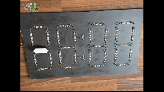

Step 6: Alternate Base (Optional)
If MDF is not available, feel free to use cardboard. Cutting cardboard is much easy than MDF, no doubt but if you want a sturdy structure for your clock, I would prefer MDF or even plywood of 3 to 4 mm thickness.
And follow the same actions in the step 5.
I have prepared the base of cardboard sheet as well to check if the Clock looks good and if it is functional. So, yes, the cardboard base should also work if you don't want to go the long way.
1) Do the marking for the same dimensions.
2) Black Spray Paint
3) Use the Stencil to do the marking of the digits locations
4) Stick the LED Strips
5) Make the holes for the LEDs (This is a cardboard so you can use scissors or simple screwdriver as well)

Step 10: LEDs Assembly
Since, the strip comes in inbuilt adhesive method, do not worry about sticking them on the base.
Before placing any LEDs, begin by planning the path of data flow across the 7-segment digit. Using a pencil or marker, lightly map out the direction of the data transfer directly on the painted MDF base. This step ensures that all LED strips will be connected in the correct sequence and that the data flows smoothly from one segment to the next. You can refer to the reference images for proper orientation.
For this design, the data will flow in the following order:
g ➡︎ b ➡︎ a ➡︎ f ➡︎ e ➡︎ d ➡︎ c
This sequence is chosen to simplify wiring and maintain a clean layout on the back side.
Next, pay close attention to the DIN (Data In) and DOUT (Data Out) markings on each LED strip. These arrows indicate the direction in which the data can travel. Align each strip so that the DIN of the next segment correctly receives data from the DOUT of the previous one. Begin pasting the LED strips to the base following this exact order.
For best illumination, try to place every LED strip exactly in the center of each 7-segment block. Proper centering ensures even brightness and prevents hotspots or dim edges when the diffusion covers are placed on top.
Start with the first segment by placing the LED strip labeled “g”. This will serve as the starting point of the entire digit, ensuring that data enters the LED chain in the correct order. Make sure to connect both the data line and power wires correctly as you begin this first segment.

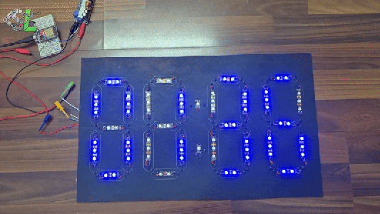

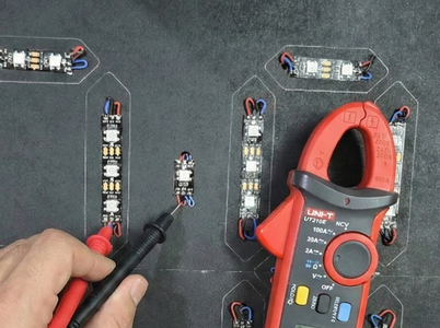

Step 11: LEDs Wiring
For each of the InOut terminal - +5V, GND and Din/Dout I have used 3 connecting wires of approximately 5 cm.
Once all the LED strips are positioned on the base in the correct sequence, the next step is to begin soldering the electrical connections between each segment. Every NeoPixel strip includes three terminals:
  1. 5V (VCC) – for power
  2. GND – for ground
  3. DIN / DOUT – for data flow
Start by connecting the DOUT of one segment to the DIN of the next. These connections must follow the exact data flow path you mapped earlier. Using short, flexible wires for these data links keeps the backside of the MDF board clean and prevents clutter. When soldering, aim for joints that are shiny, smooth, and fully bonded to the copper pads. A dull or lumpy solder joint can create poor connections that lead to unpredictable LED flickering or failures. Good soldering now will save you from future troubleshooting.
And don’t worry if it isn’t perfect on the first try—I didn’t get the wiring correct in one go either! I myself did the soldering twice or thrice.Loudly crying
After the data connections are complete, move on to soldering the 5V and GND lines. These can be connected using a power bus, where all segments share a common positive and ground wire. This method ensures consistent brightness across the entire digit and reduces chances of voltage drop.
If you prefer, you can solder all three lines—5V, GND, and Data—at the same time. I also used this approach, and it turned out to be much faster and more efficient. Just make sure to use different colored wires for each connection (for example: red for 5V, blue for GND, and black for Data, like I did). Color-coding your wiring will make it easier to track each connection, especially when you’re working with multiple segments and yes, it looks better.
Once all wires are soldered, verify your work using a multimeter. Check continuity from DIN to DOUT across every segment and confirm that each LED strip is properly connected. This quick test ensures that everything is wired correctly before powering it up with the ESP32 and you won't have to waste time in fixing wiring issues later.

Step 14: Testing
Alright—once all the LED strips are wired, the power circuit is in place, and the ESP32 is connected, it’s time to test everything. This step makes sure your wiring is correct before you fully assemble the clock, so you don’t have to tear things apart later.
1. Do a Quick Visual Check
Before powering anything:
  1. Make sure no wires are touching or crossing accidentally
  2. Verify that all solder joints look clean, shiny, and solid
  3. Check that 5V, GND, DIN, and DOUT wires haven’t been mixed up
  4. Confirm your power bus lines run correctly to all segments
This is your last chance to catch a loose or ugly solder joint without powering things up.
2. Verify Continuity with a Multimeter
Set your multimeter to continuity mode and do a quick run-through:
  1. DIN → DOUT: check that each segment passes the signal forward
  2. 5V line: confirm all segments are connected to the positive bus
  3. GND line: confirm all grounds are common
  4. No shorts: check that 5V and GND are NOT accidentally connected
If you hear unexpected beeps between 5V and GND—stop and find the short.
3. Power On the Buck-Boost Converter Alone
Before connecting the LEDs:
  1. Power the converter
  2. Confirm the output still reads 5.0V
  3. Check if anything heats up (it shouldn’t!)
If voltage looks stable, move on.
4. Connect the LED Power Bus
Now plug the LED strips into the 5V and GND lines.
Power up again:
  1. All LEDs should remain OFF (this is normal)
  2. If any LED flashes randomly or stays lit, it may mean a wiring issue
If all looks calm, you’re good to proceed.
5. Upload a Simple LED Test Code to ESP32
Use a basic NeoPixel test sketch—like:
  1. Turn all LEDs red
  2. Then green
  3. Then blue
  4. Then a rainbow sweep
This makes it VERY easy to identify a bad segment.
You don’t need your final clock code yet—just a simple check pattern.
6. Watch the LEDs Carefully
As the test runs, look for:
  1. A segment that doesn’t light up
  2. Wrong colors
  3. Flickering
  4. LEDs lighting in reverse order
  5. The signal stopping partway through (common DIN/DOUT mix-up)
If the first few LEDs work but others don’t, it almost always means:
  1. A bad solder joint
  2. A reversed DIN/DOUT connection
  3. A wire broke during bending
Touch these wires lightly—sometimes the behavior changes and reveals the fault.
7. Check Power Stability
While your test animation is running:
  1. Measure voltage on the first and last LED strip
  2. It should be close to 5V everywhere
  3. If the last segment is significantly lower (e.g., 4.5V), add another power injection point
Stable power = stable colors.
8. Stress Test (Optional but Helpful)
Set all LEDs to full white brightness for a few seconds.
This draws maximum current.
Check for:
  1. Dimming
  2. Color shift
  3. ESP32 randomly resetting
  4. Wires heating up
If everything stays stable—you’re golden.

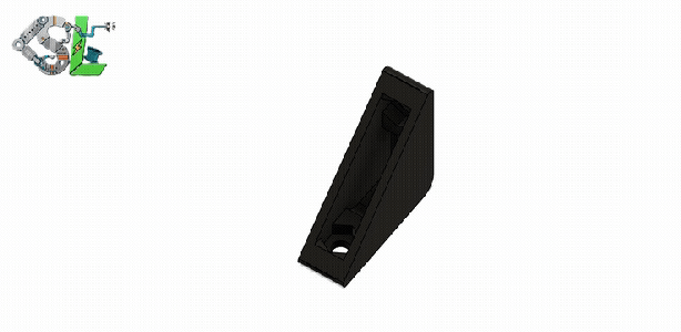

Step 15: Frame Joints Preperation
In this step, you’ll be assembling the 3D-printed corner brackets that will hold the MDF frame together. Start by taking one of the brackets and locating the small recessed slot designed to hold a nut. Insert the nut into this pocket—make sure it sits flat and properly aligned so the screw can catch the threads.
Next, take a screw and insert it through the hole on the opposite side of the bracket. As you tighten the screw, it will pull the nut securely into place inside the slot. You can tighten it by hand at first and then snug it down with a screwdriver to make sure it’s firm.
Repeat the same process for the remaining brackets. Once assembled, these corner brackets will act as strong connectors that you’ll use later to fasten your MDF frame pieces together cleanly and securely.
Step 16: Final Assembly
In this step, you’ll be running a full-segment test on your LED digits—this is important to confirm that all your wiring, solder joints, and data connections are correct before closing everything up.
To do this, upload a simple test code (like an “all-on” or “88:88” pattern). When the code runs, the ESP32 will send data into the DIN of the first segment, and the signal will travel through each DOUT → DIN connection you soldered earlier.
You should see the display show 88:88 first. This pattern lights up every segment (a–g for all digits plus both colon LEDs). This lets you check:
  1. All solder joints are connected properly
  2. No segments are swapped or wired backwards
  3. The entire data chain is flowing smoothly
  4. Brightness is even (meaning your 5V and GND rails are stable)
After that, the display will cycle through a few different numbers. This helps you check whether individual segments respond correctly when only certain LEDs are supposed to be lit.
If something looks off—like a dim segment, flicker, or a digit not lighting—this is the perfect time to fix it. It’s much easier now than after assembling the frame.
By the end of this test, once you see all segments light smoothly and consistently, you’ll know your LED wiring is solid and ready for final assembly.

1. Prepare the MDF Base & Frame
  1. Make sure the MDF base (50 × 30 cm) is fully dry after painting.
  2. Align your 3D-printed segments (a to g + colon dots) on the marked outlines.
  3. Do a quick dry placement:
  4. Check spacing between digits
  5. Ensure wires have enough space to route beneath
  6. Confirm colon dots line up nicely in the center
If everything looks good, move ahead.
2. Mount the 3D Segments
  1. Take some screws and mount on both corners of the segmenet such that the segment can snug fit on both the screws.
a. Attach the Black Segment Bodies
  1. Use hot glue or double-sided tape (foam tape works best).
  2. Press each piece firmly onto the MDF so it doesn’t move while wiring underneath.
b. Insert the Diffusers
  1. Once LEDs inside each segment are working, snap or press-fit the white diffusers onto each segment.
  2. If they feel loose, add one tiny drop of glue on a corner only, so you can still remove them in the future.
Your digits will now look like an actual digital clock!

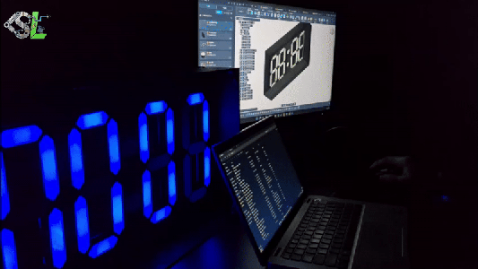

Start loading the finished clock code onto the ESP32 and verifying that everything works exactly as expected. Start by connecting your ESP32 to your laptop via USB. Open your Arduino IDE or preferred coding environment and upload the final program that handles timekeeping, LED updates, brightness control, and colon blinking.
Once the code is uploaded, place the clock in a dark or dim environment to clearly see how each segment illuminates. Check the digits on the physical clock while referencing your design files or simulation on the screen. Ensure the numbers are properly aligned, all segments light evenly, and no LEDs flicker or misbehave.

Step 20: The Result
Person cartwheeling No further Actions required Rock:
The final build works exactly as intended: the 7-segment digital clock lights up with bright, evenly-diffused LEDs, and all four digits update smoothly in real time. The white diffusers give each segment a clean, professional look, and the colon LEDs sync perfectly with the main display. Thanks to the stable 5V power circuit and the correct DIN→DOUT wiring sequence, the animations run without flicker, lag, or brightness drops. Overall, the clock is solid, accurate, visually appealing, and ready for everyday use.Rock
