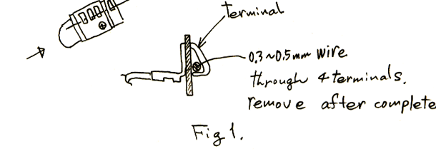

The "Safety Pin" idea:
I don't have assembly drawings yet but Mr. Naoya in Japan sent me a great idea that makes assembly much easier. I call it the "Safety Pin" idea because a fellow in Kansas borrowed a safety pin from his wife and told me it worked really great! Here is the drawing Mr. Naoya sent to me:
Thanks very much Mr. Naoya. A couple of professional cable manufactures told me this idea has made assembly much easier!

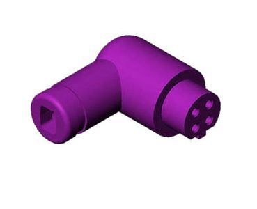

Step 2: ETrex
The pFranc-connector for eTrex comes as a do-it-yourself assembly kit.
In the kit you will find 3 plastic parts, one screw and a metal strip with pins on it.
Gently bend the individual pins so they break loose from the rectangle piece of metal, so you will end up with 4 of these:
After breaking the pins loose, we will need to bend them.
I used a flat screw driver for that purpose.
First lay the pin, with the bended part facing down, in the plastic piece with the four square holes (picture 1).
Next use a flat screwdriver to hold it in that position (picture 2) and gently use your nail to push it up as shown in the three images above (picture 3). Repeat this step for all four pins.
Now get your wires and connect (solder) them on the pins you just did bend. After doing so, gently push each pin, one at a time, through the plastic piece with the large rectangle opening as show in the image below.
Now we need to put the pins in the proper position in the plastic piece we just used for bending the pins.
To make things a bit easier on you, use a needle to hold the pins in place. The illustration below shows you how.
Do this for all four pins.
TIP: While you're at it, make a note which color cable you placed with what pin. If you're nor sure what the pin numbers are, then take a look at the image at the beginning of the page.
After completing this for all four pins, gently move the two pieces of plastic together until it becomes one.
Do not yet remove the needle! The needle is good for some stability while assembling the connector.
Now we need to place the "hood" over the connector. It's tha last piece of plastic which we gently put over the cable. Make sure that the cable do not make any kind of shortcut here!
After putting that together, gently rotate the connector and insert the screw in the hole (on the side where the pins stick out). Do not use excessive force when tightening the screw. After that you can remove the needle and your eTrex connector is finished.
