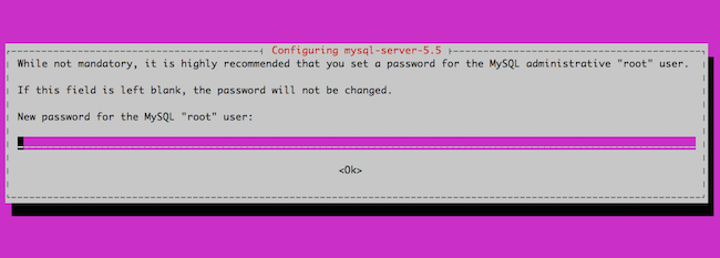

So, you need a database on your pi, I used MySQL as database driver. You have to install this on your raspberry pi.
So first of all, execute the comand
sudo apt-get install mysql-server --fix-missing
This will install the MySQL server on your pi.
You should be prompted for a root password during the installation. Choose a secure password, and keep it safe. You will need this later to log in into the database. You will be prompted to confirm your password.
Once you’ve confirmed your password, MySQL server should finish installing and the service should start.

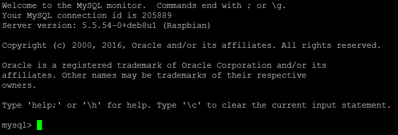

Okay, so we have our MySQL server, but we don't have a database yet, so you first want to login to the server.
mysql -uroot -hlocalhost -p
This will prompt you a password. Type in the password you've typed in during the installation and press enter.

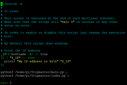

Also, we want some scripts to start at boot, so edit the rc.local file:
sudo nano /etc/rc.local
and add those lines:
python3 /home/pi/Tripmaster/main.py &
python3 /home/pi/Tripmaster/index.py &
Add them right above the exit 0

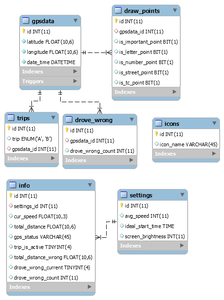

The database file is just ordinary SQL. I'll add views and stored procedures in the feature.
