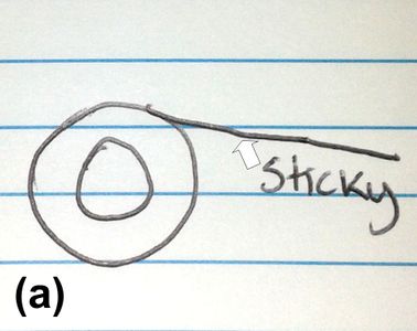

When you pull this tape off the roll it kinda comes in “jerks” which leave lines across the tape. I found you could avoid this by pulling the tape in the opposite direction low down against the surface.
- Place the GPS on a hard surface on its back, with screen up most.
- Hold the tape as you would normally with the sticky side down and pull out about and 5 cm to hold.(diagram a)

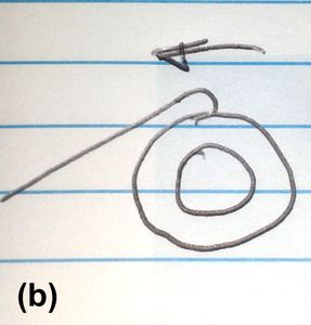

- Then reverse the direction of the tape back over it self so the sticky side is now upper most. (diagram b)
- Take the end that you are holding down low enough so that the non sticky side of the tape just past the bend back is now touching the non sticky still on the roll, (diagram c) holding this angle pull the tape smoothly away from the bend back until you have a length 5 cm bigger than our device screen.
