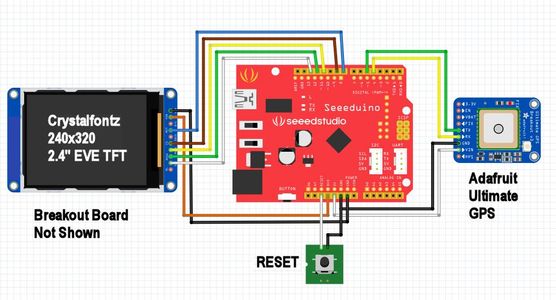

The new 2.4 EVE TFT display came with its own development kit.The kit includes the display, a Seeduino V4.3 (basically a Arduino Uno clone), a breakout board that interfaces the display with the Seeeduino, a ribbon cable that goes between the breakout board and the display, and some jumper wires. I chose not to use the jumper wires. I hardwired (soldered) everything to header pins that make a better connection than the jumpers.
The wiring is as follows:
Breakout to Seeeduino
Pin 1 ----------- 3v3 Orange +3v
Pin 2 ----------- GND Black GND
Pin 3 ----------- D13 White SCK
Pin 4 ----------- D11 Yellow MOSI
Pin 5 ----------- D12 Green MISO
Pin 9 ----------- D9 Brown CS (EVE)
Pin 10 --------- D7 Violet not used
Pin 11 --------- D8 Blue PD_N (EVE Reset)
GPS to Seeeduino
Pin 1 ---------- 5v White +5v
Pin 2 ---------- GND Black GND
Pin 3 ---------- D4 TX Yellow to GPS RX
Pin 4 ---------- D5 RX Green to GPS TX
Reset button to Seeeduino
Pin 1 -------- RST
Pin 2 -------- GND

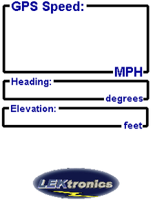

The next step is to load the images for the display.
The code can be found in the demos.cpp file
//----------------------BACKGND LOGO-------------------------------
 //Load and INFLATE our 8-bit A2R2G2B2 (lossless) image into RAM_G
 //You have to know before hand how big the logo is. The INFLATE
 //is not aware of the content or format of the data.
 Logo_Width=BACKGND_LOGO_WIDTH_ARGB2;
 Logo_Height=BACKGND_LOGO_HEIGHT_ARGB2;
 FWol=EVE_Inflate_to_RAM_G(FWol,
                           LEK_GPS_240X320_LOGO,
                           BACKGND_LOGO_SIZE_ARGB2,
                           RAM_G_Unused_Start);
 //Pass our updated offset back to the caller
 return(FWol);
The LEK_GPS_240X320_LOGO (first image above) was created using PaintShopPro 2019 and converted to a .cpp file using the EVE Asset Builder. I will not go into detail as how this is done as I don't have a full understanding of the software. I kind of fumbled my way through it.
The LEK_DISH.cpp file was created the same way. It is displayed in multiple locations on the screen dependent on the number of satellites the GPS is receiving from. The code for this is also found in the demos.cpp file and is as follows:

       // display gpsMph from GPS
       FWo=EVE_PrintF(FWo,
                         120, //X
                         64, //Y
                         16,        //Font
                          EVE_OPT_CENTER, //Options
                         "%d",//"%d MPH"
                         gpsMph);
//++++++++++++++++++++++++++++++++++++++++++++ HEADING +++++++++++++++++++++++++++++++++++++++++++++
       // display Heading from GPS
       FWo=EVE_PrintF(FWo,
                         130,
                         140,
                         28,
                         EVE_OPT_CENTER,
                         "%d",
                         gpsDir);
