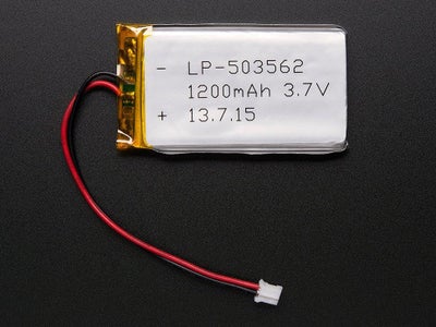

- A battery with a JST-PH connector, for example this one from Adafruit

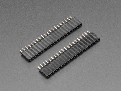

- Socket headers

- Solder socket headers to the pinholes on the board. You might need two in height (to reach over the jumper)

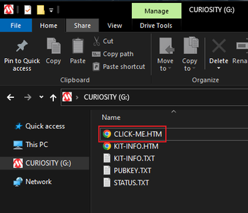

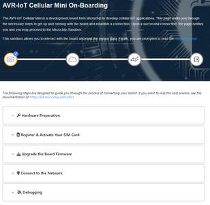

The first step to get started with the AVR-IoT Cellular Mini kit is to register the SIM card bundled with the kit. The easiest way to see how this is to connect the board to the computer using an USB-C cable and click the "CLICK-ME" file in the disk the appears in your file explorer. This will lead to an on-boarding page where it is described how to register your SIM card and how to flash the latest firmware for the board.
