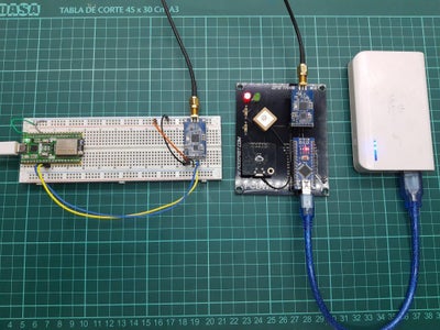

Introduction: GPS Tracker Without Cellular Network With LORA Module
In this tutorial we will see how to make a tracker to GPS tracker, with LORA and Arduino module. We will also see a basic webserver with ESP32, where you can open a URL on google maps, with real-time latitude and longitude data.

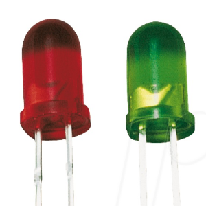

Step 2: Two LED Diodes

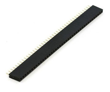

Step 5: Female Pins

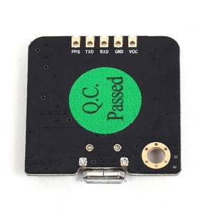

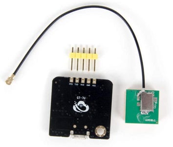

Step 6: GT-7U GPS Module
Note that when the GPS module works, the green indicator on the GPS module will flash (red is for power indication), and relative figures, time(UTC), latitude, longitude, and more. If we establish a connection between the GPS module, and a serial terminal program in our pc we will obtain data. It is important to try to be in a clear area to capture satellite signals, at least 3 satellites, to obtain latitude and longitude data, but the more satellites we get the better the navigation and accuracy experience.
Product description Item Description: Features: GT-U7 module. High sensitivity module, low static deviation, low power consumption and low volume.Miniaturization: Thanks to the extremely high tracking sensitivity, the position of the cover has been considerably improved.– High precision: In a narrow urban sky, in dense jungle environments, the GT-U7 can be positioned with great precision.Easy to use: with IPEX antenna interface you can place the standard distribution of the active antenna quickly. Rechargeable button battery table. Onboard E2PROM enables the storage of parameter data.-Compatible with: The output format is compatible with NEO-6M.– Scope of application: vehicles, mobile devices such as PDA, vehicle surveillance, mobile phones, camcorders and other mobile location systems, bicycle sharing, common mobile power supply.
Package contents:
1 GT-U7 GPS module.
1 active antenna with IPEX interface.
Specification: With IPEX antenna interface, the default distribution of the active antenna, you can quickly place Operating voltage: 3.6V-5V (or direct USB power supply)
Baud transmission rate: 9600 (can be modified)
Rechargeable button battery on board
Onboard E2PROM Memory
NeMA output format of parameter data supports
NEO-6M Size: 27.6mm*26.6mm can be inserted or selected a patch (with positioning holes)
Application areas: Portable vehicle-mounted devices such as PDA Vehicle Monitoring Mobile phones, camcorders and other mobile positioning systems
Step 7: Pinout
PPS: Pulse per second
TXD: Data transmission pin
RXD: Data transmission pin
GND: Earth
VCC: Power voltage 3.6 to 5.5 volts

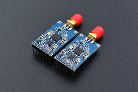

Step 8: Lora Module
About Lora Modules
The LoRa radio module is a type of low-speed long-range data radio modem based on Semtech’s Sx1276. It is a low cost transceiver module of less than 1 GHz designed for operations in the ISM (Industrial Scientific Medical) and LPRD bands without license. Frequency spectrum modulation/demodulation, multichannel operation, high bandwidth efficiency and anti-lock performance make LoRa modules easy to perform thanks to robust and reliable wireless linking. The module can operate in two different modes: standard mode and Star network mode. In standard mode, it acts as a transparent data radio modem that communicates with the host in the preset data format without the need for encoding/decoding. In startup network mode, a module will be configured for the central node and other modules will be configured as node modules. Communication between the central module and the node module is bidirectional, but node modules cannot communicate with each other. Note that the module does not contain the lorawan protocol. Therefore, the star network function of this module is used with the protocol itself, so it is not compatible with lorawan.

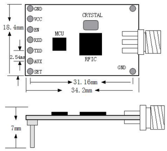

Step 12: PIN OUT
Step 13: Connection Module With Serial USB Adapter
Step 14: SETTINGS
For some applications, default parameters may not be the best
option, so users may need to change the parameters There are two ways to adjust them: by MCU or by PC. In configuration mode, the EN pin must be connected to GND and then the configuration tool or commands can work effectively By PC: DORJI offers a PC-based configuration tool that can be used to change parameters through the graphical interface. Users can insert the DRF1278DM module into serial usb adapter, and connect them to the computer and run the configuration tool.
Step 15: DRF TOOL
This tool allows us to configure the LoRa MODULES DRF1278DM and DRF1276DM
Download—> http://rogerbit.com/wprb/wp-content/uploads/2019/08/DRFTOOL.zip

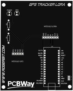

Step 19: Printed Circuit
Download the gerber file in –> http://rogerbit.com/wprb/wp-content/uploads/2020/12/Gerber_GPS_TRACKER_LORA_ARDUINO.zip

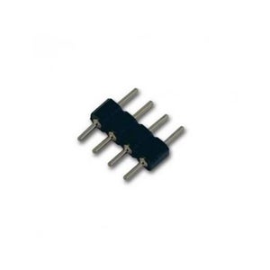

Step 20: Male Pins
Step 21: 30-pin Socket for Arduino

Step 23: Cicuito Web Server
Step 24: Webserver Source Code
