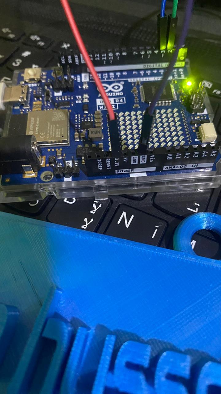

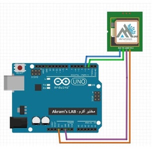

Step 1: Circuit Setup and Wiring
Note: In the circuit diagram picture, I used the Arduino R3, but the connections remain the same for the Arduino R4.
TX and RX Connections: Connect TX pin of NEO-6M to Arduino's digital pin 2 (RX), and RX pin of NEO-6M to Arduino's digital pin 3 (TX).
Voltage Connection: Ensure VCC pin of NEO-6M is linked to Arduino's 3.3V output to supply the correct voltage, preventing potential module damage.

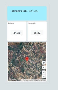

Step 2: Setting Up IoT Cloud for GPS Data Tracking
1- Account Creation:
  • Users open any browser and navigate to Arduino IoT Cloud.
  • An account is created by following the prompts and clicking on "Get Started."
2- Thing Creation:
  • Upon logging in, users proceed to the dashboard and select "Create a Thing."
  • Specifications of the project are defined, and a name is assigned.
3- Device Configuration:
  • Users choose between an ESP or Arduino board.
  • They follow the provided instructions to configure the selected device.
4- Network Connection:
  • Users select their network from the options provided.
  • The network password is input to establish the connection.
5- Variable Addition:
  • In the project dashboard, users navigate to the "Variables" section.
  • They add desired variables, such as latitude, longitude, and cloud location for the map widget.

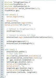

Step 3: Full Code
#include "thingProperties.h"
#include<TinyGPSPlus.h>
#include <SoftwareSerial.h>
SoftwareSerial serial_connection(2,3);
TinyGPSPlus gps;
void setup() {
  Serial.begin(9600);
  delay(1500);
serial_connection.begin(9600);
Serial.println("GPS Start");
  // Defined in thingProperties.h
  initProperties();
  // Connect to Arduino IoT Cloud
  ArduinoCloud.begin(ArduinoIoTPreferredConnection);
  setDebugMessageLevel(2);
  ArduinoCloud.printDebugInfo();
void loop() {
  ArduinoCloud.update();
  // Your code here
  while(serial_connection.available()){
  gps.encode(serial_connection.read());}
  if (gps.location.isUpdated()){
  latitude=gps.location.lat();
  Serial.print(latitude,6);
  Serial.print(", ");
  longitude=gps.location.lng();
  Serial.println(longitude,6);
  coordinate={latitude, longitude};
Step 4: Code Explain
This line includes the thingProperties.h file, which contains definitions for properties used in the Arduino IoT Cloud.
#include <TinyGPSPlus.h>
This line includes the TinyGPSPlus library, which is used for parsing GPS data.
This line includes the SoftwareSerial library, which is used for creating a secondary serial port on digital pins.
This line initializes a SoftwareSerial object named serial_connection on pins 2 (RX) and 3 (TX).
TinyGPSPlus gps;
This line initializes a TinyGPSPlus object named gps for parsing GPS data.
This line updates the connection with Arduino IoT Cloud.
while(serial_connection.available()) { ... }
This loop reads data from the secondary serial port (connected to the GPS module) and parses it using TinyGPSPlus.
if (gps.location.isUpdated()) { ... }
This condition checks if a new GPS location is available. If true, it retrieves the latitude and longitude from the GPS data and prints them.
This code snippet demonstrates how to integrate a GPS module with Arduino IoT Cloud, allowing you to monitor and track location data remotely.
Step 5: Result
The result will be presented through videos and pictures to ensure clarity of the idea.
