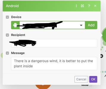

Click on 'Add a new module' choose 'Android', Send text message.
And then add another module for weather and enter your city.
Conncet the weather object to a new router that will connect to 2 new modules, 'Android' and 'HTTP request'.
To the android please add your phone number and the message you want to get for a strong wind.

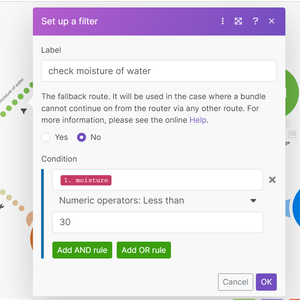

Click on the wrench between the router and the android and choose 'Set up a filter' this is the condition that when it's happening the robot will send text message to your phone.
Fill it like in the picture.
Between the router and the second android do the same but fill it like the second picture, this is the condition for the wind level that if necessary you will get a message to your phone.

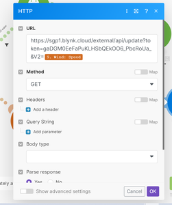

On the HTTP object put the URL below:
https://blynk.cloud/external/api/update?token={token}&{pin }={value}
Replace the 'token' that inside the bracket to your token and 'pin' to 'V2' and the 'value' to 'WindSpeed'.

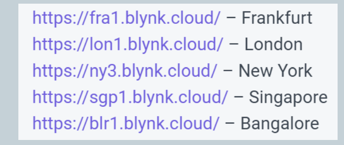

At the URL you should put your location before the word blynk like in the picture.
