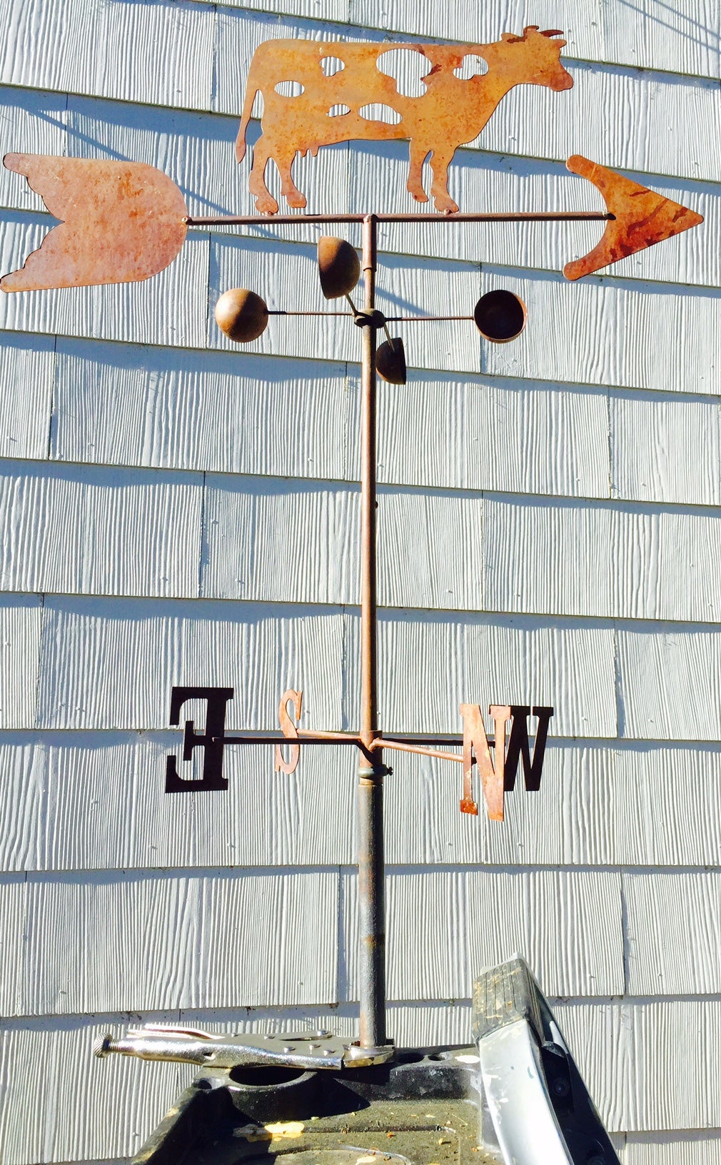

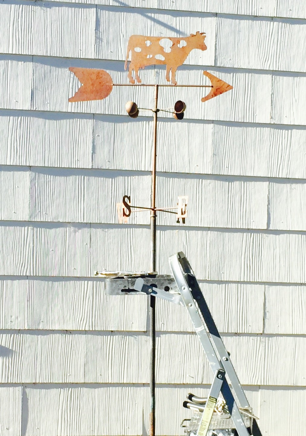

There are some neat details including a whirligig wind vane that was just wasting away standing around on top of a wood post.

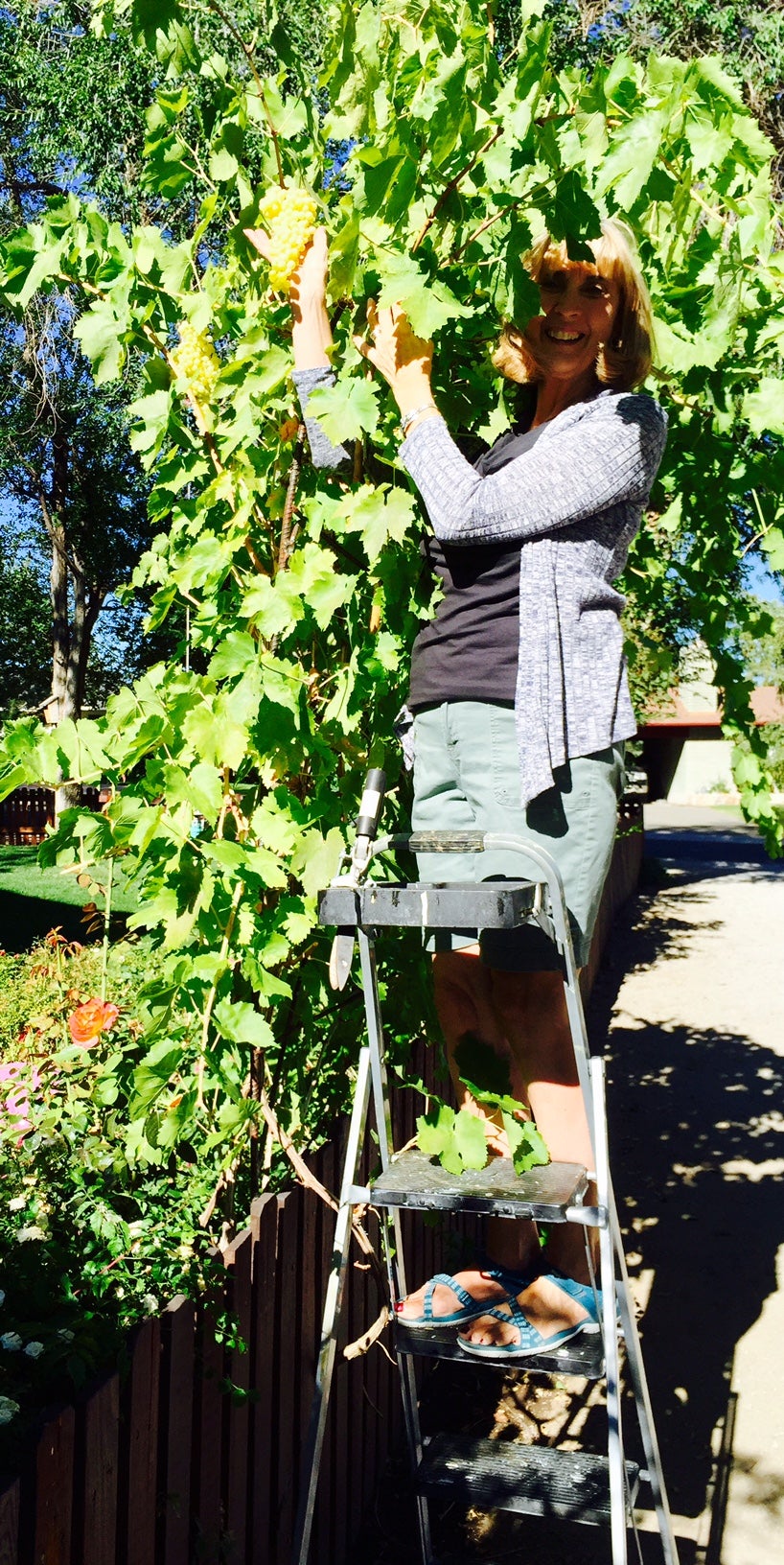

Now we_are_living_off_the_land and my wife likes the Arbor, our grand kids understand the meaning of "low hanging fruit" and when you browse through the pictures you can see the grape vine enjoys living on the trellis.

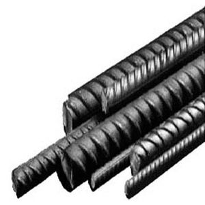

  • You do Not need a fancy contractor's ReBAR bending / cutting tool which makes the effort a bit easier..
  • A metal hacksaw and a vice will do just fine.

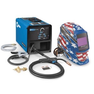

  • You need a welder of any kind that can handle 5/8" Rebar
  • A Heavy gauge power cord for your welder and drill..

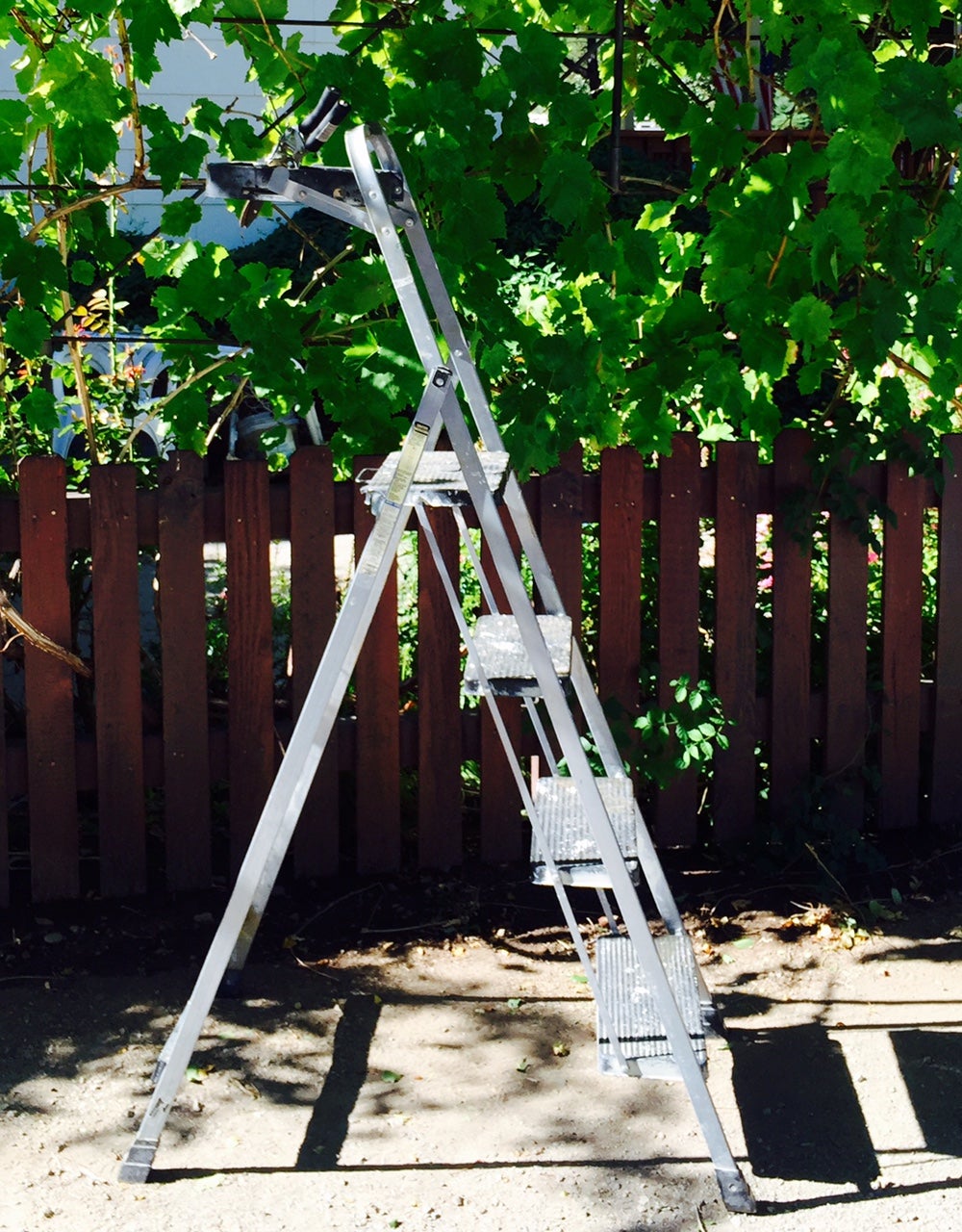

  • And definitely a step ladder like the pictures with a shelf to hold hand tools.

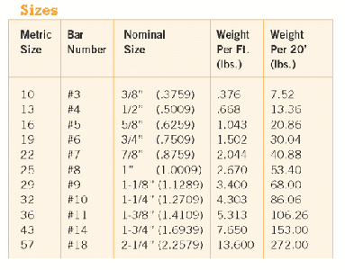

  • ONE_ 10 foot length of 5/8" rebar.
  • ONE_ 20 foot length of 1/2" rebar.
  • NINE_ 10 foot lengths of 3/8" rebar.

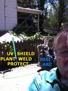

  • One_ 8'x8' tarp or some old sheet rock to protect plants from welding UV damage..

  • The UV protection tarp for your plants
Weld the rods together by clamping them with several locking pliers and while this is not a welding tutorial. It is a good idea to tack them together in two or more places and clean the area with a wire brush..
Also a good idea to wait for a calm no-wind time of day. This will allow you to do a full weld without clamps and prevent scattering the benefits of a covering gas.

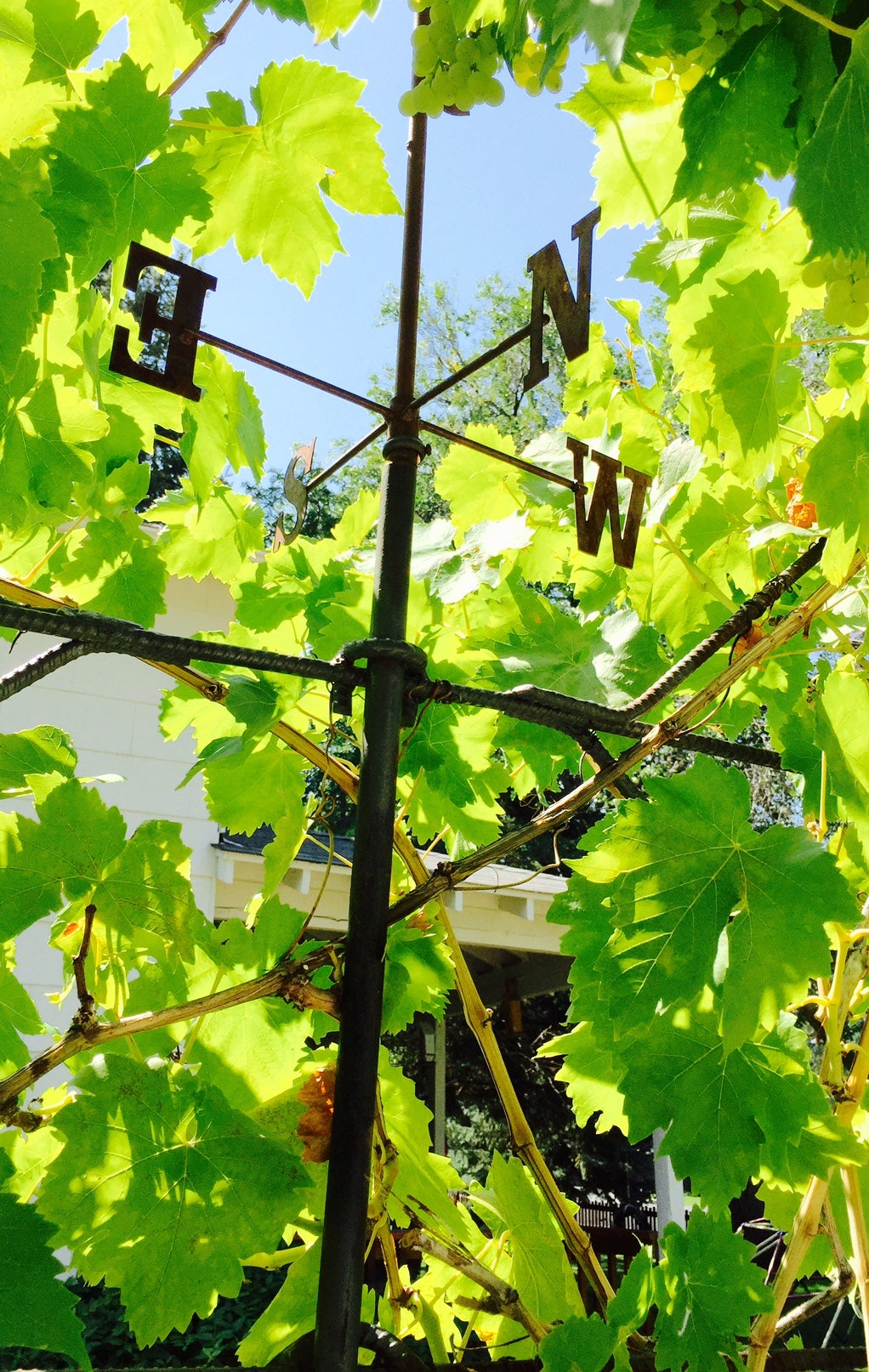

Whirligig Slide ;
  1. Now measure the largest diameter of the whirligig shaft.
  2. Take a short length of the 3/8" rebar and bend a U that easily straddles that whirligig shaft _ see pictures.
  3. Then bend the ends 90 degrees so it can hang over the top crossbar and loosely hold the whirligig shaft.
  4. Find a short metal tube that slides over the whirligig shaft and and file or grind a 3/8" slot _ per second diagram.
  5. Clamp the Tube on 3d crossbar, Whirligig and the top U hold _ per third diagram.
  6. Tack weld the tube and U hold. Remove the whirligig and finish the welding.
  7. Slide the whirligig back in place

Step 10: PICKING COOL MORNING GRAPES
After Four years vine growth..
There is a great pleasure in Picking grapes in the morning while they are still cool..
