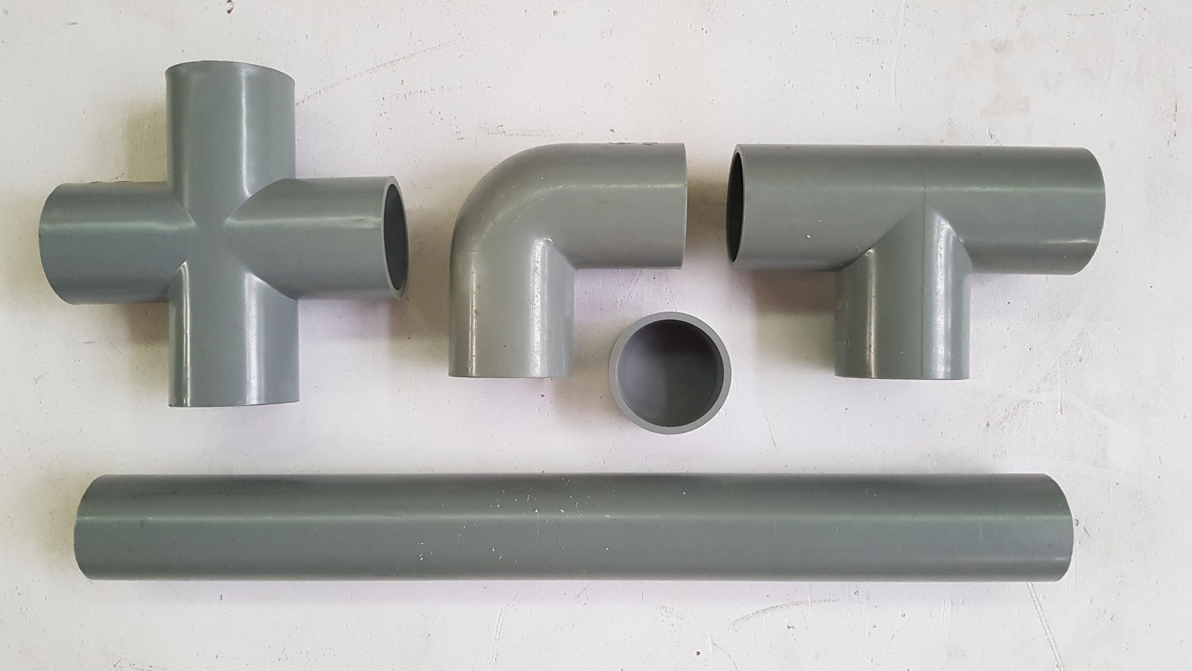

- 6pcs x Elbow PVC Pipe Ø42mm.
- pcs x Straight connector PVC Pipe Ø42mm.
- 2 meter x PVC Pipe Ø42mm.
- 12pcs x Tee PVC Pipe Ø42mm.
- 12pcs x End Cap PVC Pipe Ø42mm.
The pipe and its fittings are shown below:

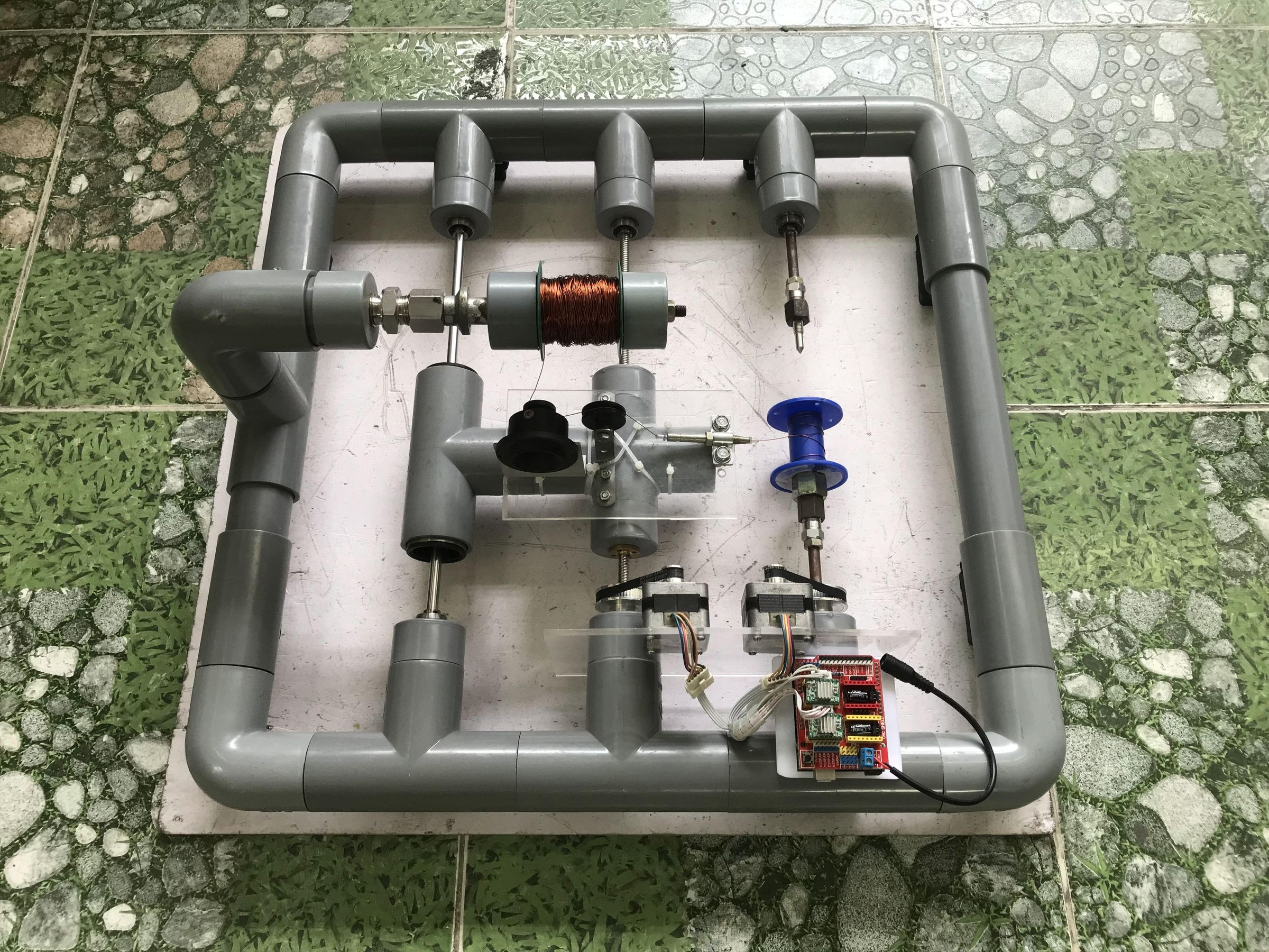

Step 3: Assembly Work

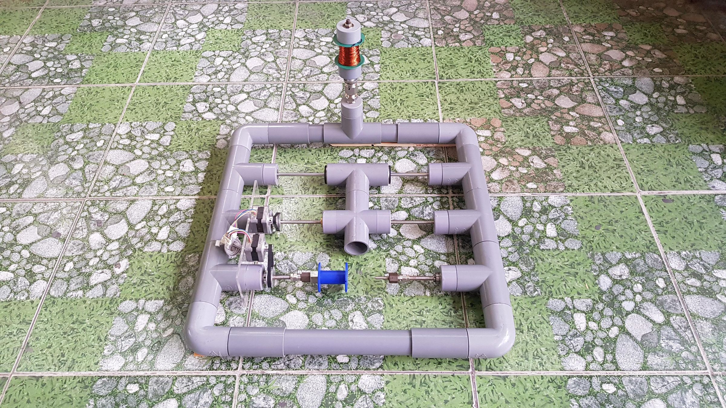

Firstly, I’ve tried to figure out how to build the coil winding machine. And it seems easy with PVC pipes. What we need is patience and carefulness.

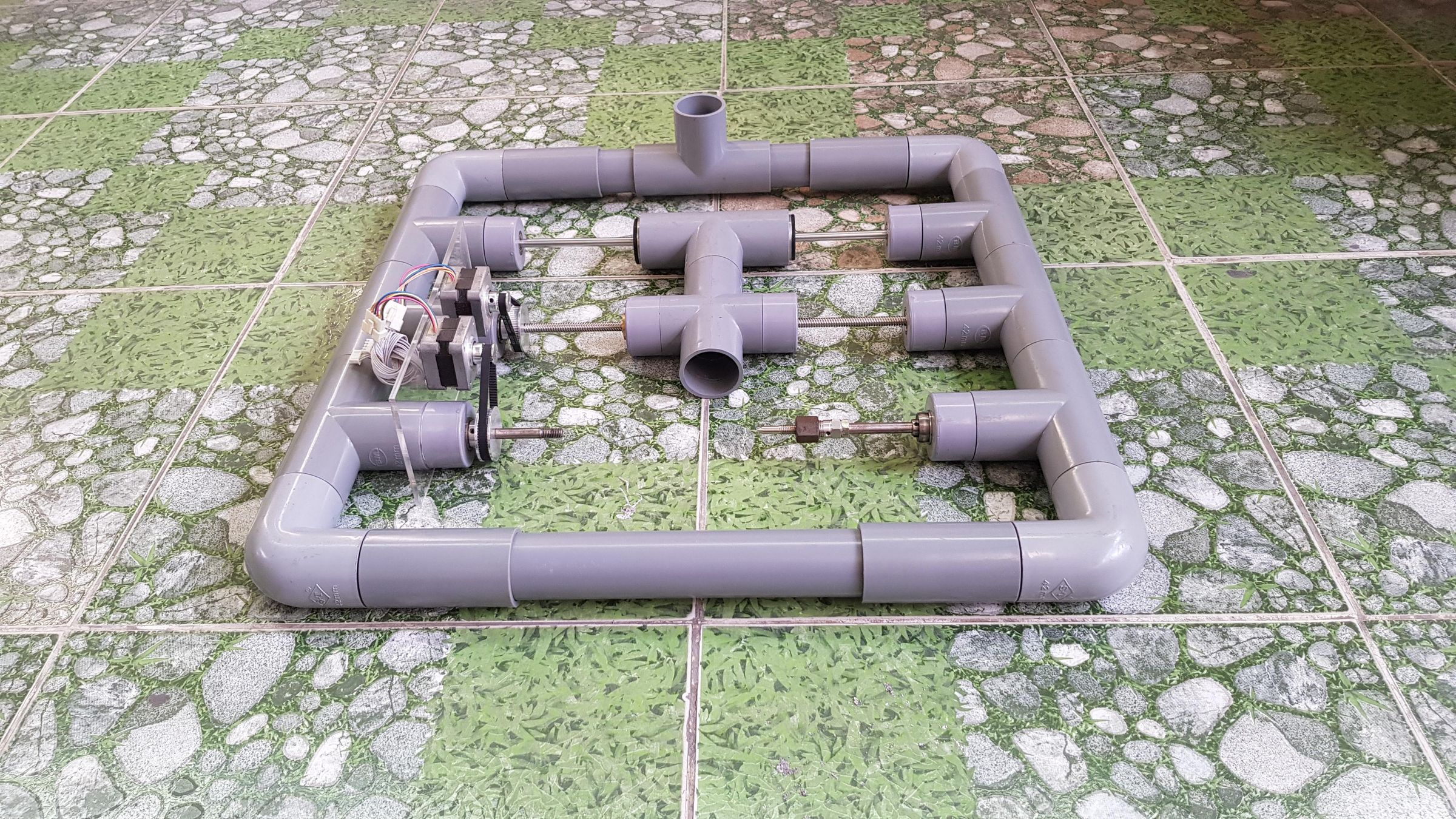

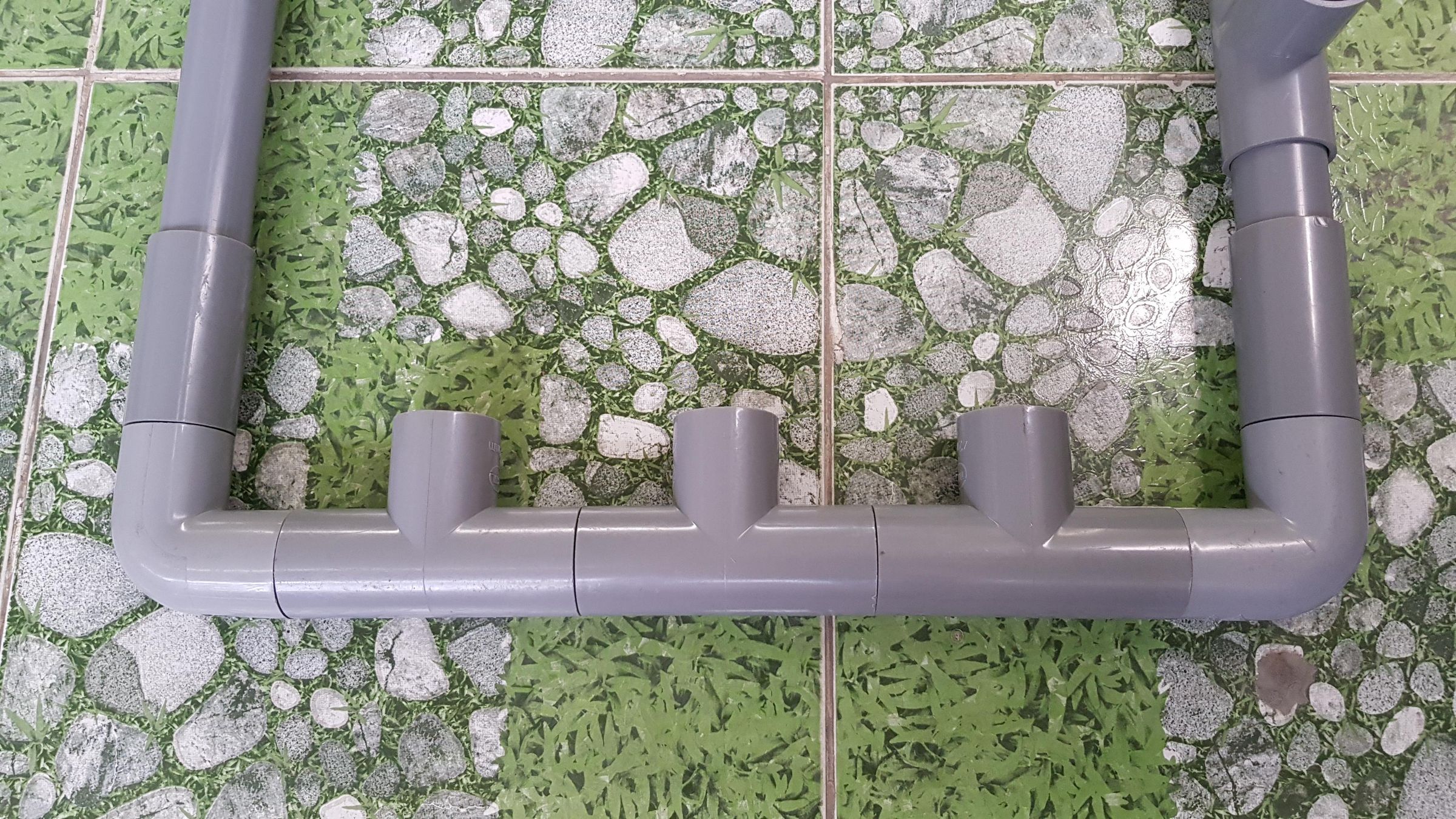

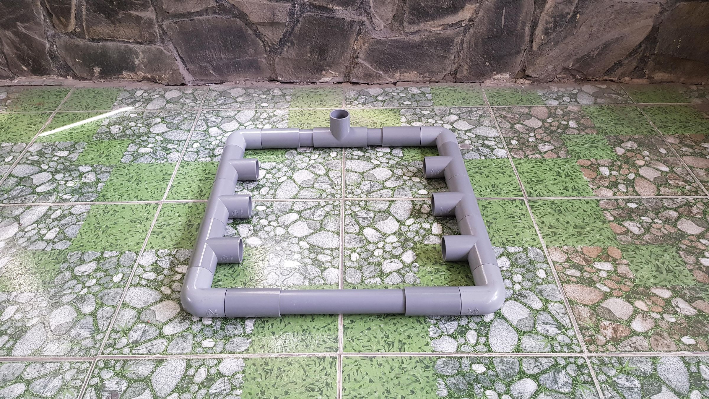

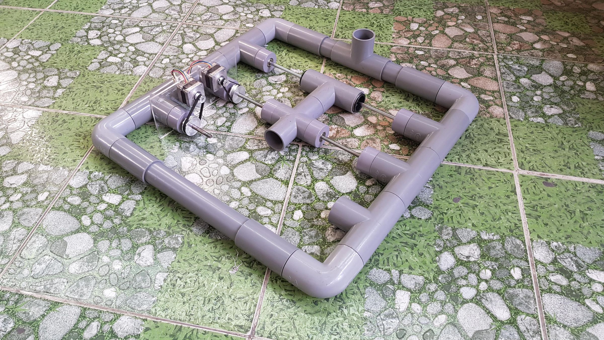

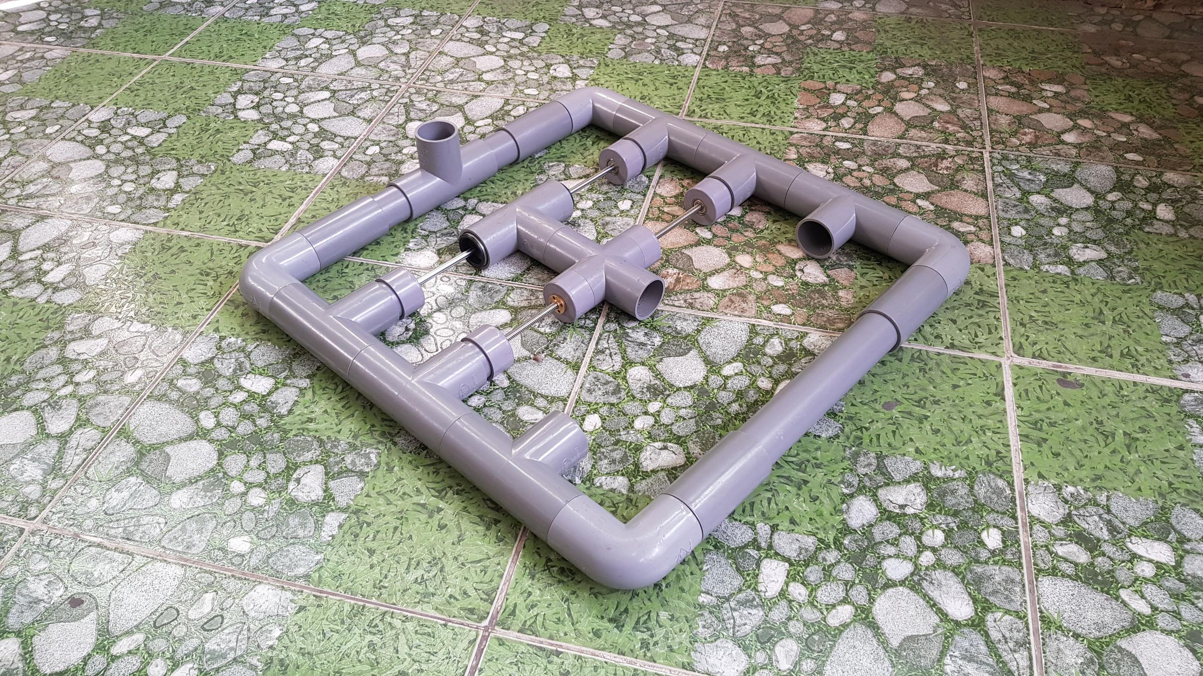

1. Building a coil winder frame:
I assembled a square frame, dimension about 480 x 480mm. It was made of 7pcs x tees, 4pcs x elbows and connecting pipes.
Connecting pipes should be cut in suitable length so that when we connect elbow to tee or tee to tee, there is no gap between them. With this connecting way, we don't need to do any measurements or alignments later because they are the same size and completely symmetrical each other. As the picture above, we have 3 pairs of pipe that are completely symmetrical each other.

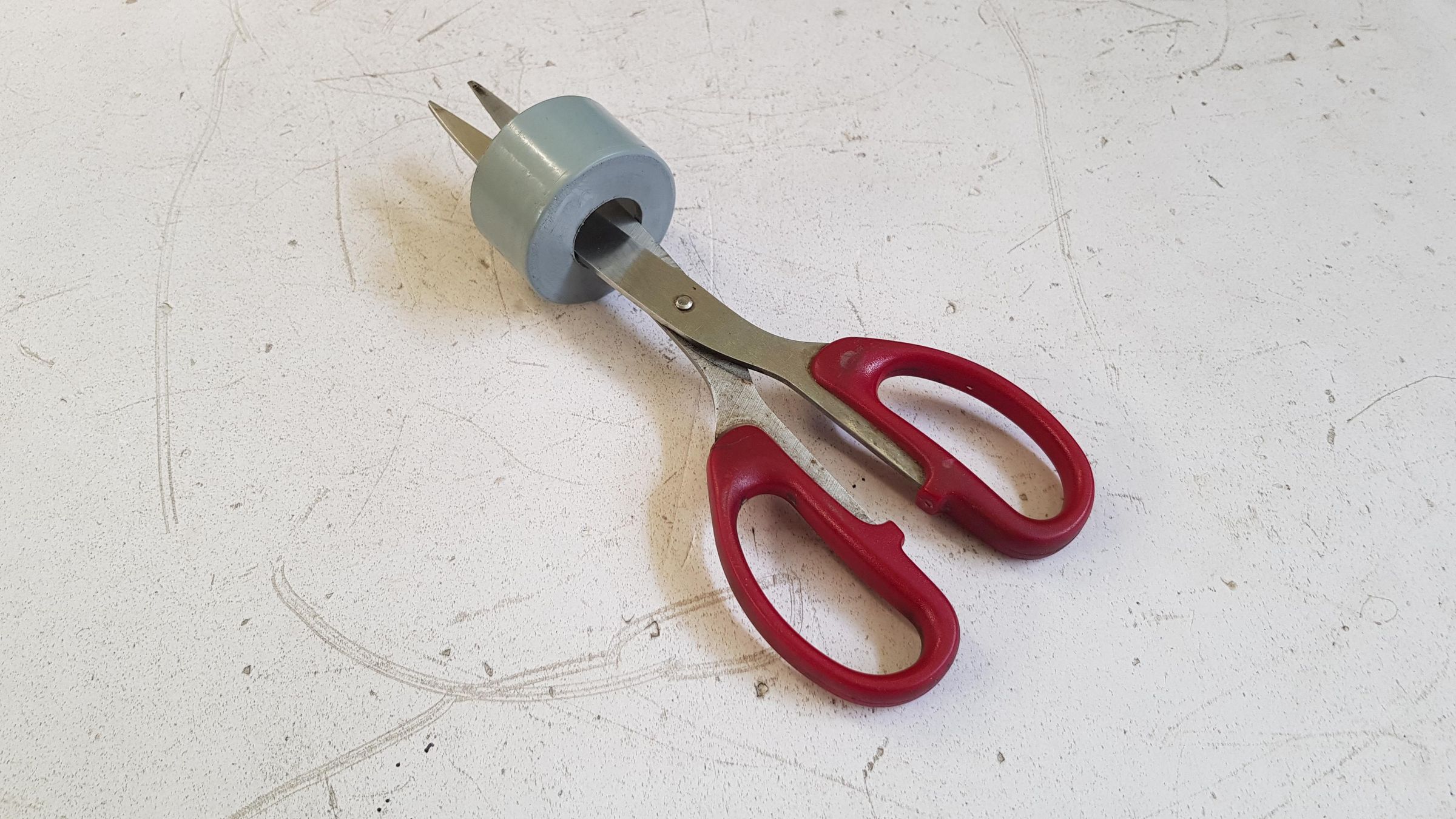

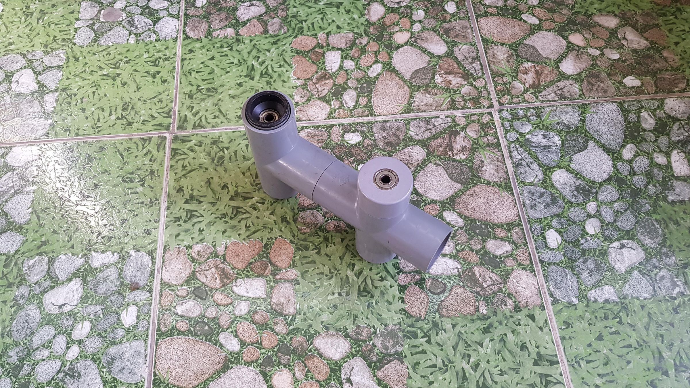

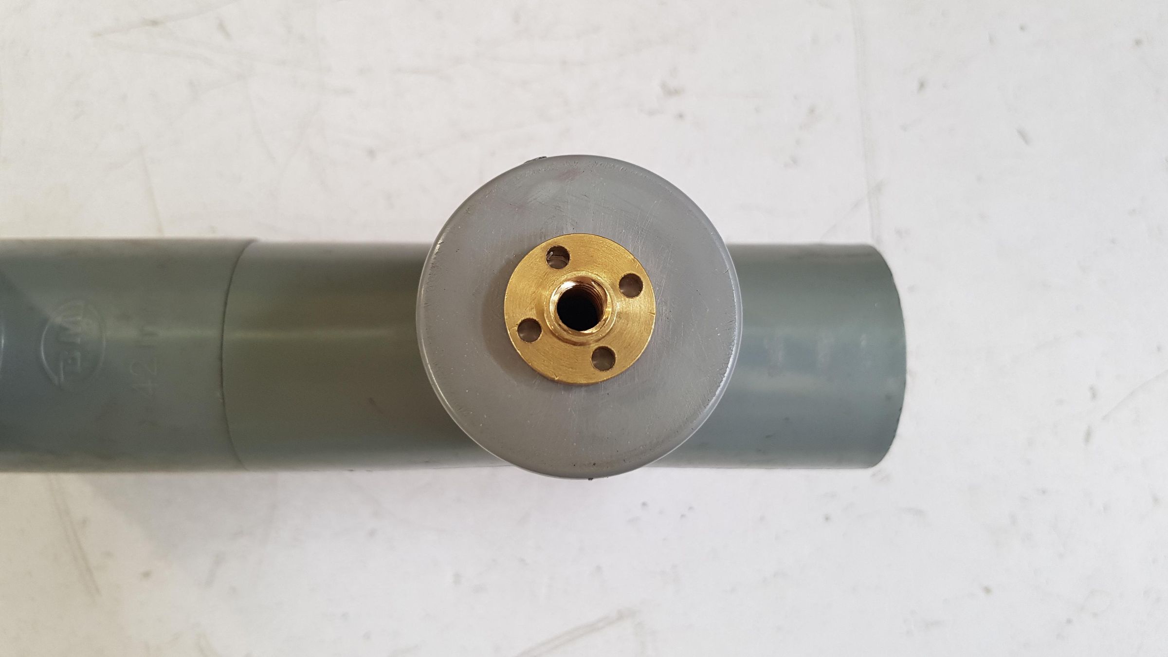

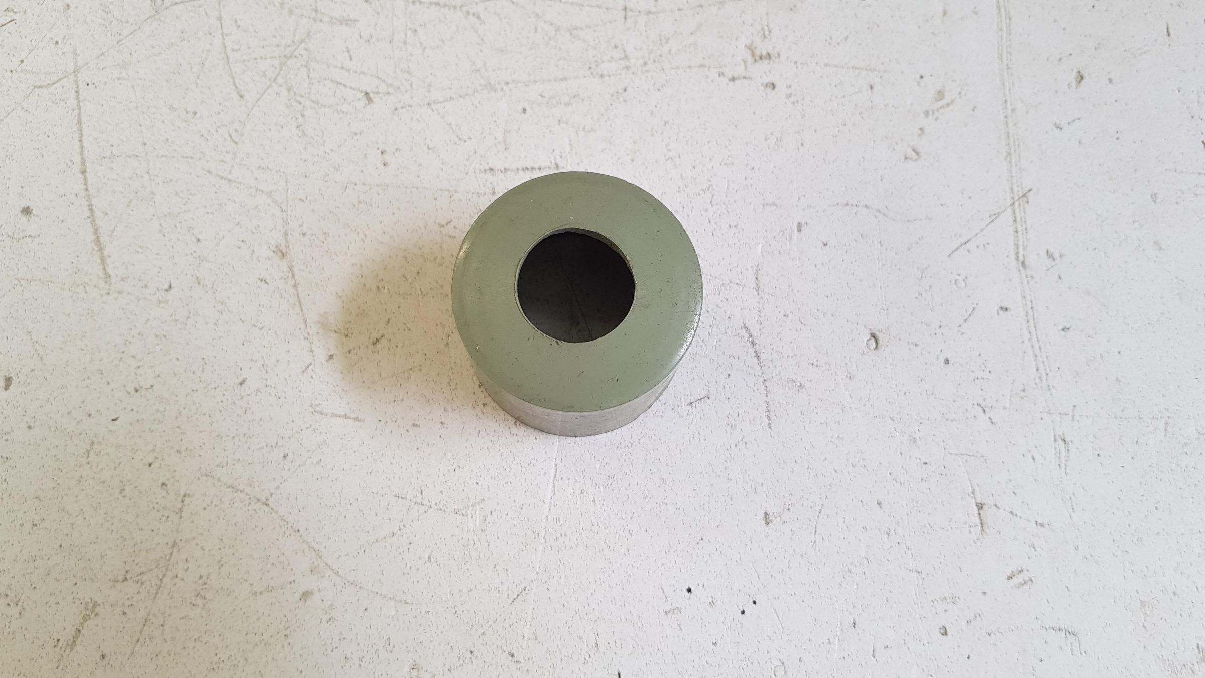

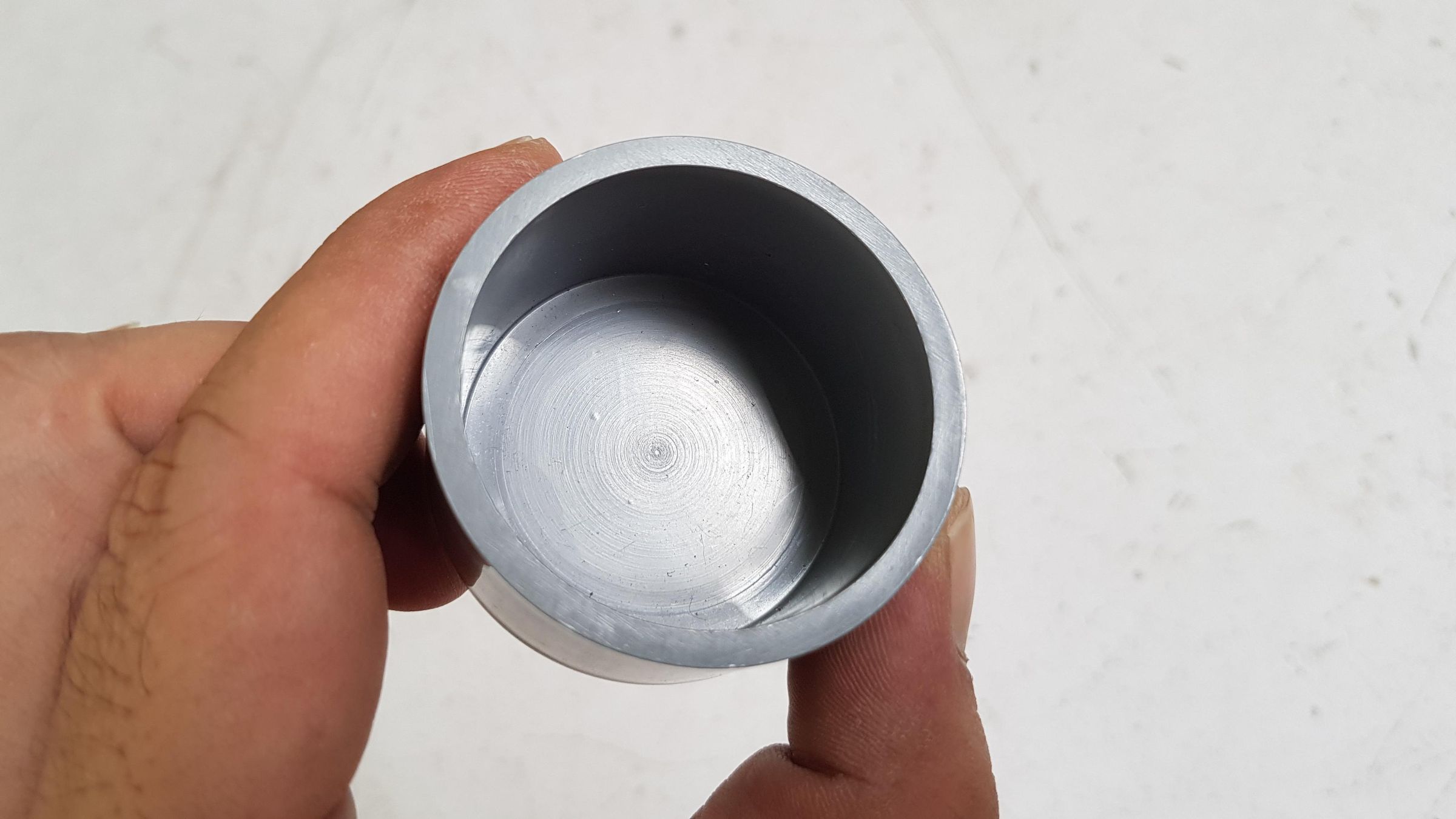

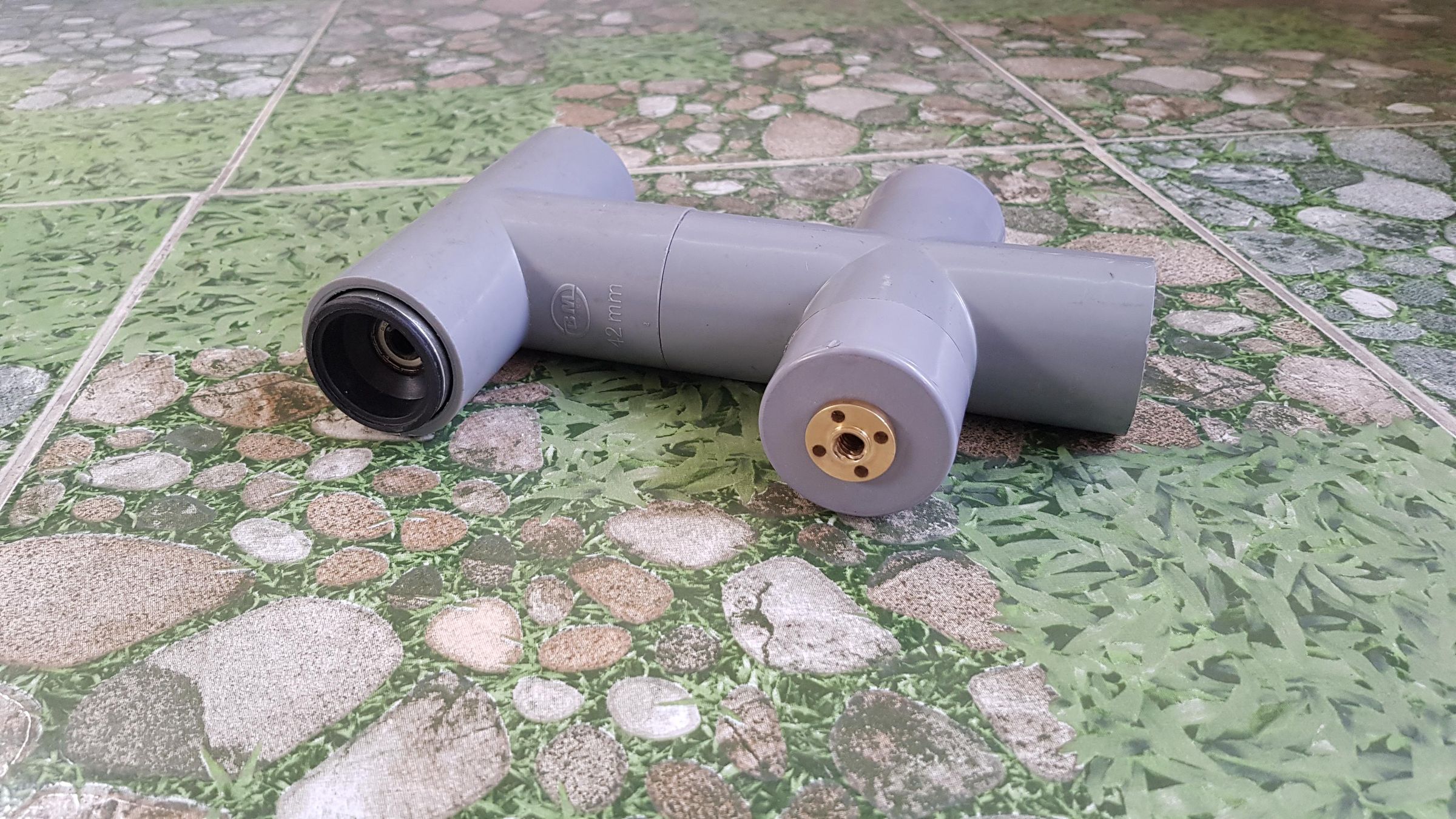

2. Drilling holes on the end caps for bearings and cooper nut:
Since I used a hand drilling machine, it was a bit difficult at the beginning. My goal was to drill about 12pcs x end caps with a 22mm diameter punch drill bit.
They should be drilled in the center of the end caps. When the drilling is complete, the bearings cannot be inserted into the holes. I've used this trick: using scissor's back to cut around the hole by rotating in circle, it made the hole a little wider, checked them thoroughly with bearings, until bearings could be tightly inserted to the holes.
We should turn the end cap upside down, we would see the concentric circles inside the end cap and mark its center before drilling.
It is better to use flanged bearings. I only have a few of this type, the rest are normal bearings but that's okay, when we fit tightly them into the holes, it's strong enough.
For copper nut of leadscrew, I used a drill bit 8mm with above trick.

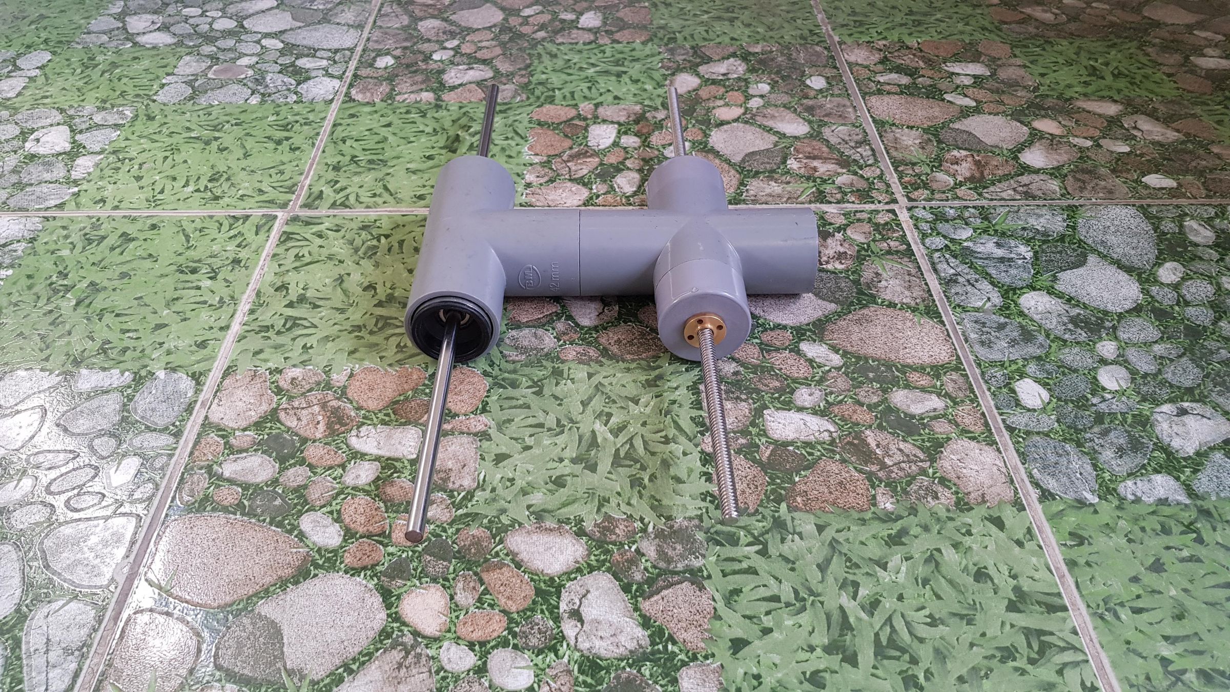

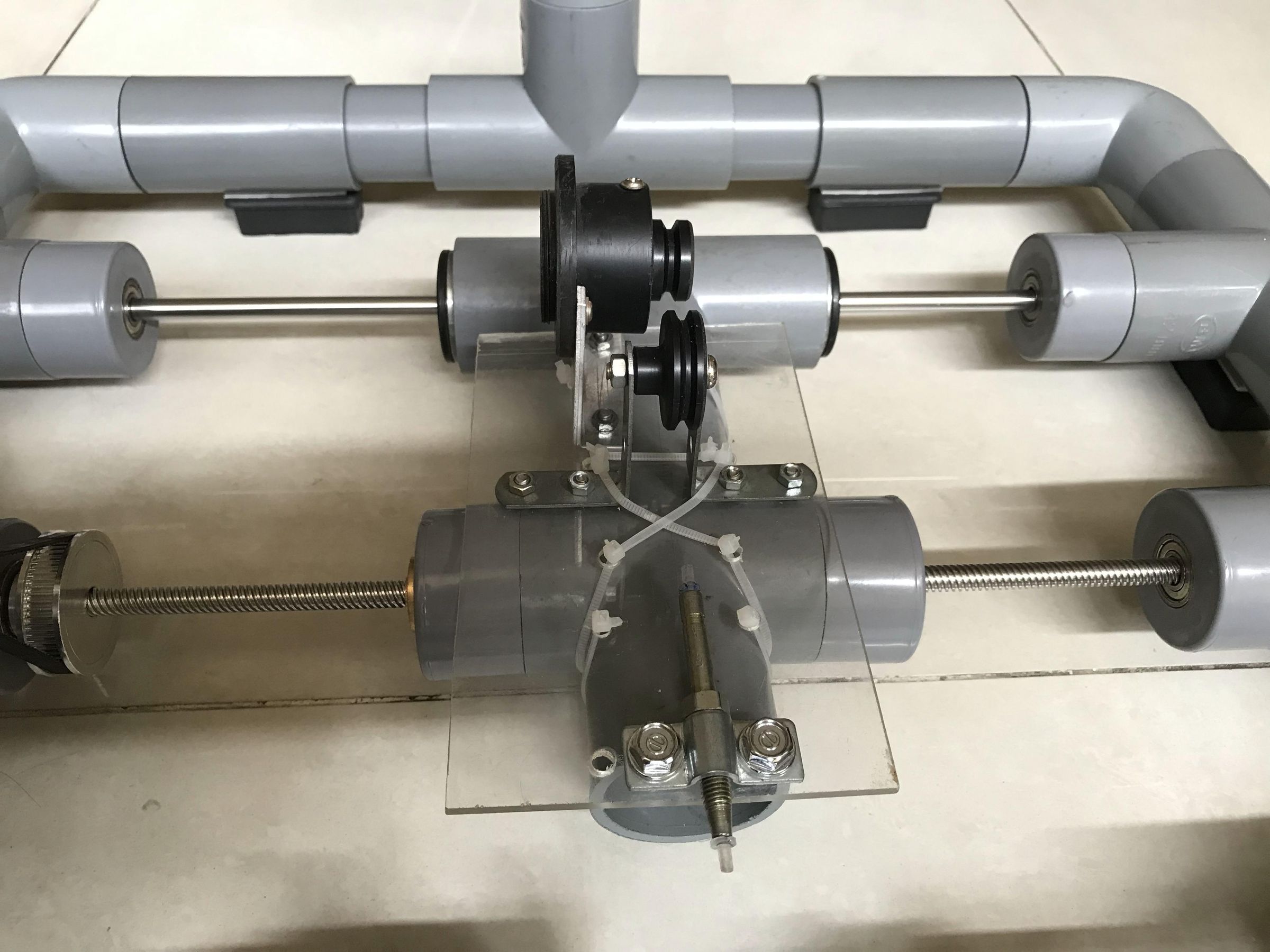

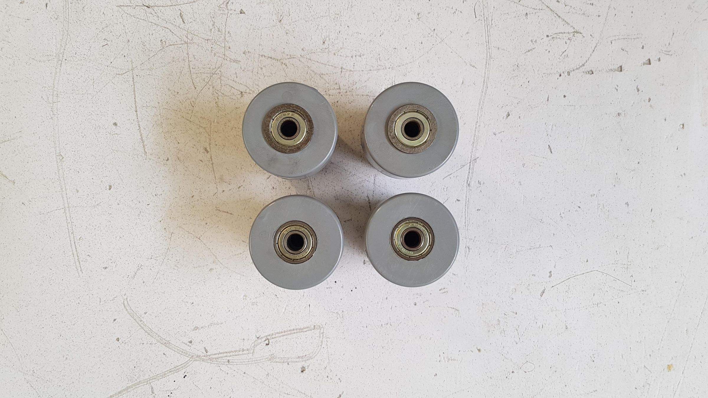

3. Building a feeder axis:
Feeder axis was built from 1pcs x PVC tee and 1 pcs x PVC cross. I installed end caps with bearings & copper nut at the two ends of PVC tee and cross. It looked like this.

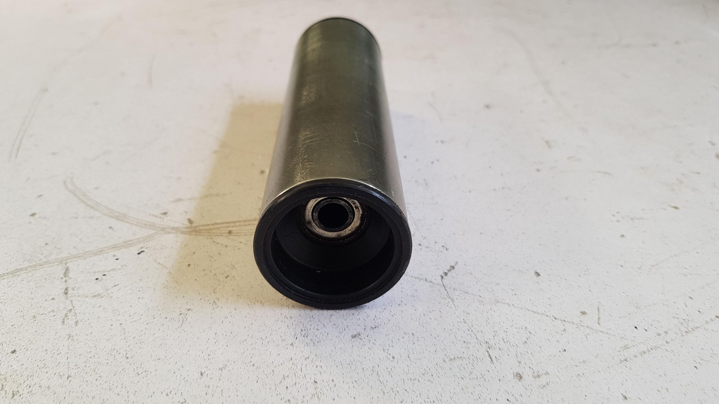

I had one roller with 2 bearings at the ends, diameter about 42mm. I tried to put it inside the PVC tee for sliding the shaft. If we don't have it, we can use one tee plus 2 pcs x end caps with bearings.

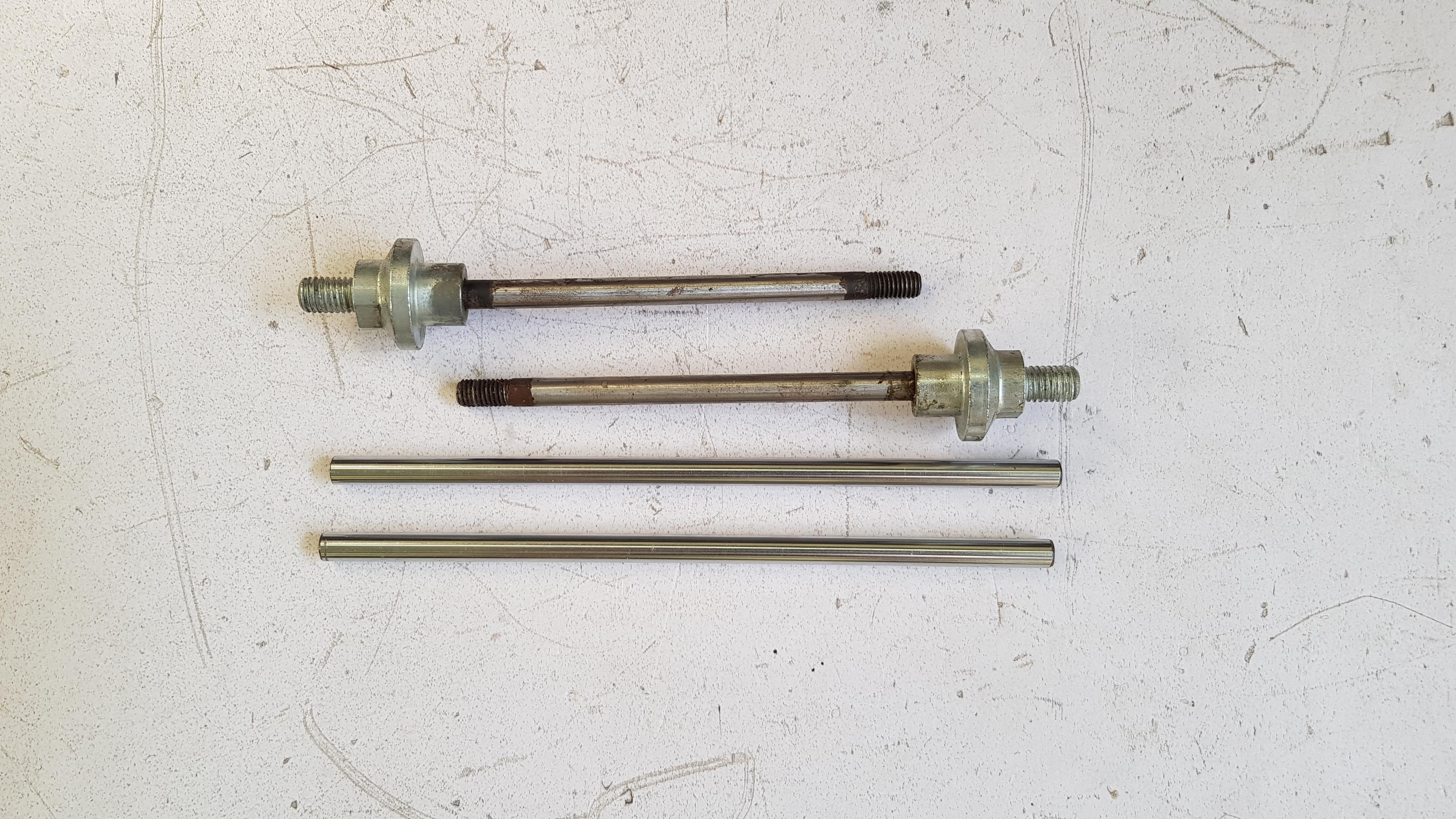

The leadscrew and shaft were inserted into bearings of feeder axis.
The other side view of feeder axis.
I temporarily mounted feeder axis on the coil winder frame and checked by hand how it worked.

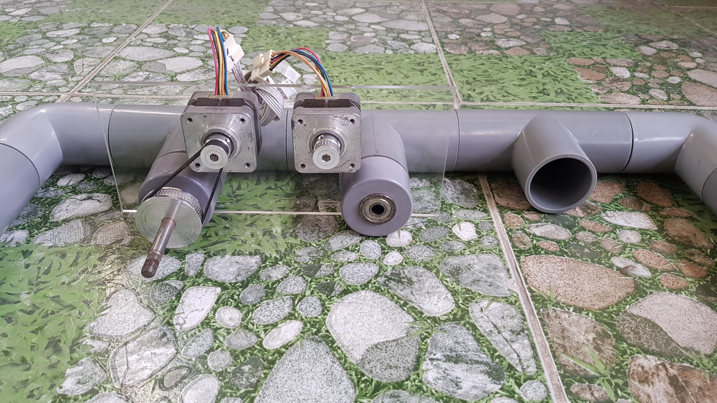

4. Drilling stepper motors frame base
I cut one acrylic plate size 100 x 230mm, drilled 8 small holes for mounting 2 x stepper motors on it. This acrylic plate was then attached on the frame by 2 big holes whose diameter is equal outer diameter of pipe 42.
I have installed 2pcs x end caps with bearings on the front side of the stepper motors where they will be connected to the feeder axis and spindle axis.
Conecting pipes at back side would be connected to the frame. By this way, it looks neat and solid.

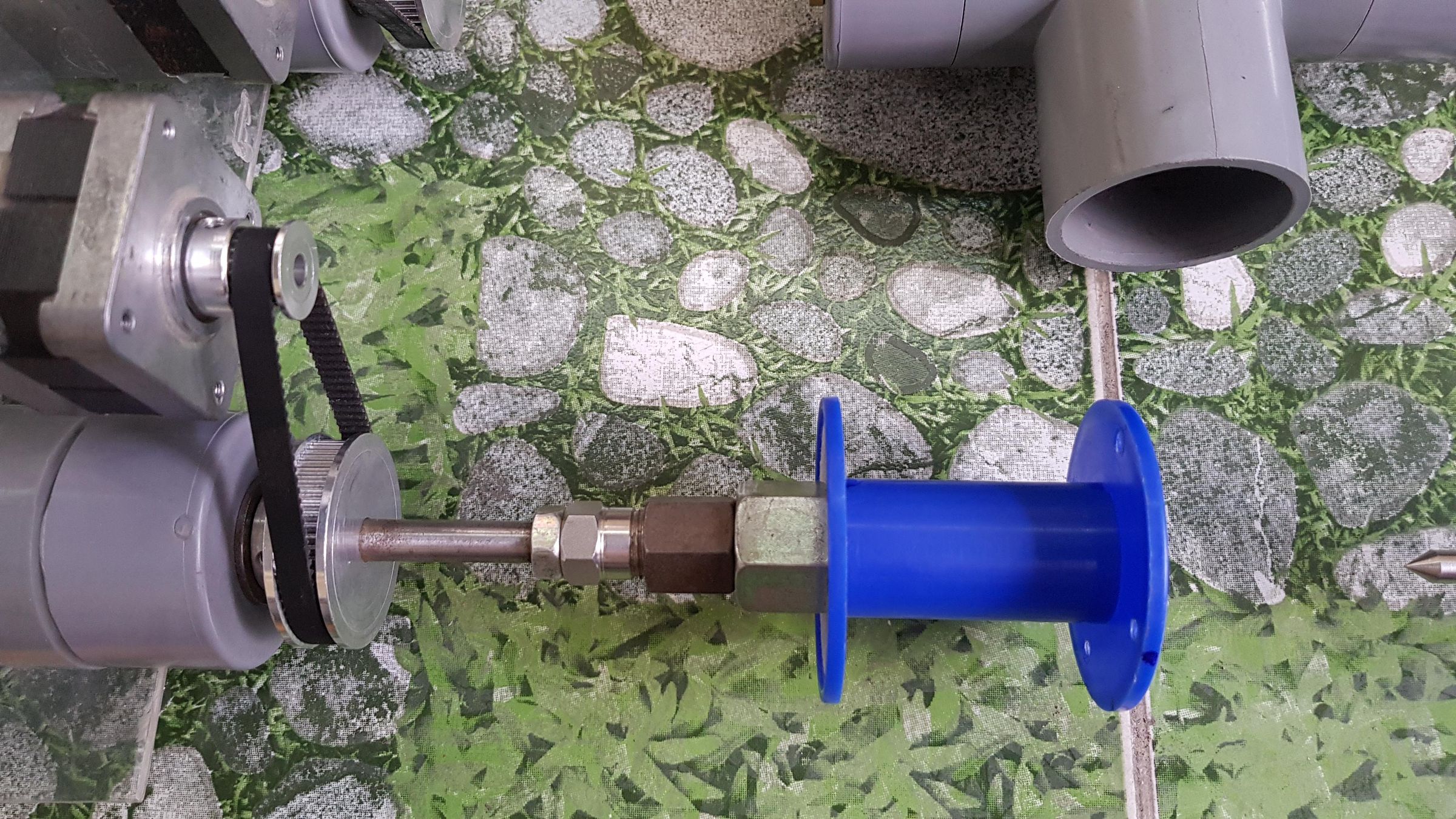

5. Building and mounting the spindle axis
I had some screw bolts with length x diameter about 16 x 8mm and I used them for spindle shaft. Or we can use shaft rods 200 x 8mm as mentioned on BOM list.
Acrylic base was mounted on the main frame. I installed 20 teeth pulley to the motors; 60 teeth pulley to spindle shaft; and closed timing belt 200mm.
Feeder axis was mounted on the main frame. Its pulleys and timing belt was as same as the spindle axis.
I mounting 1 screw bolts on the main frame at the other side of spindle axis and locked it by one bearing.

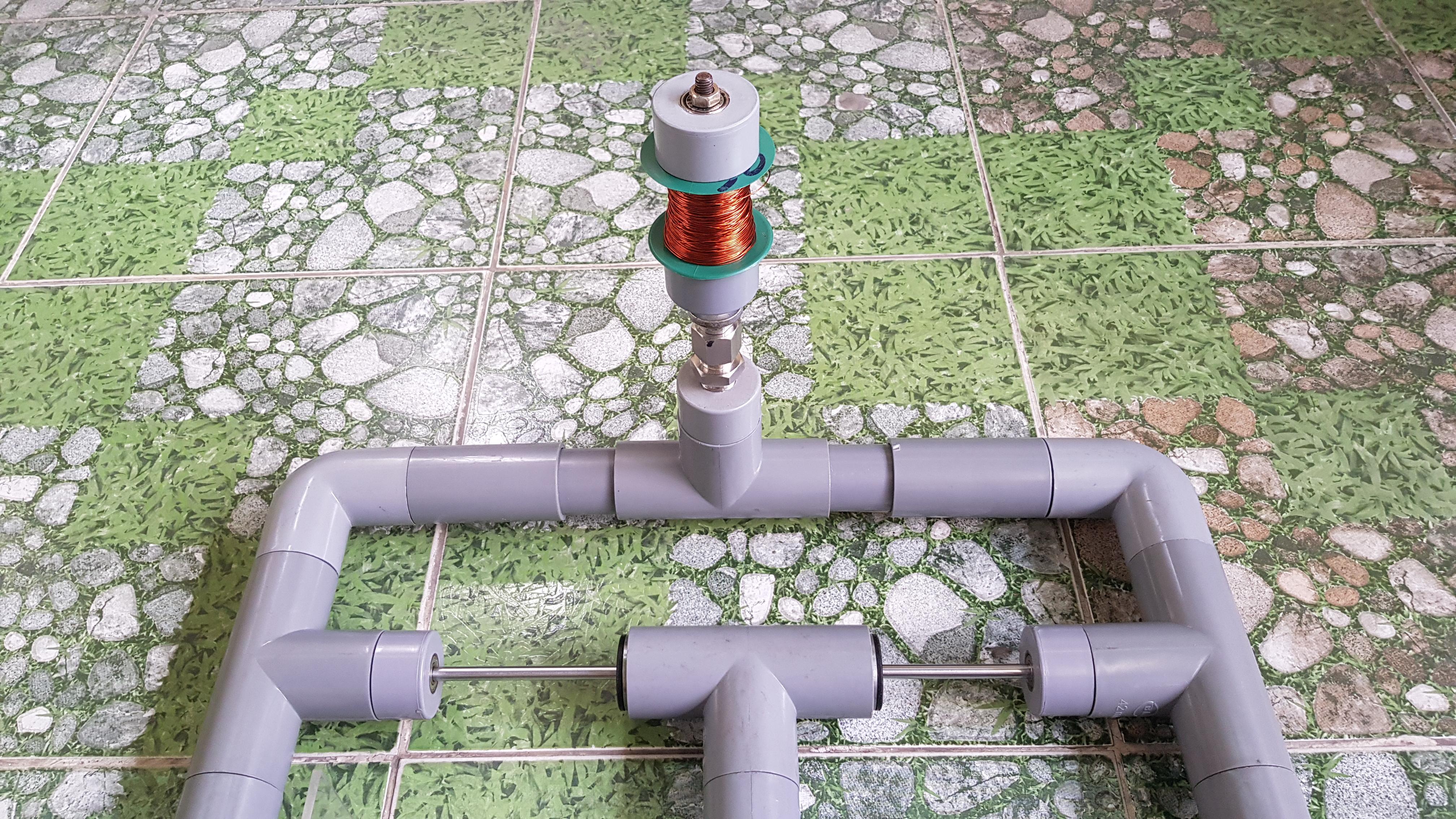

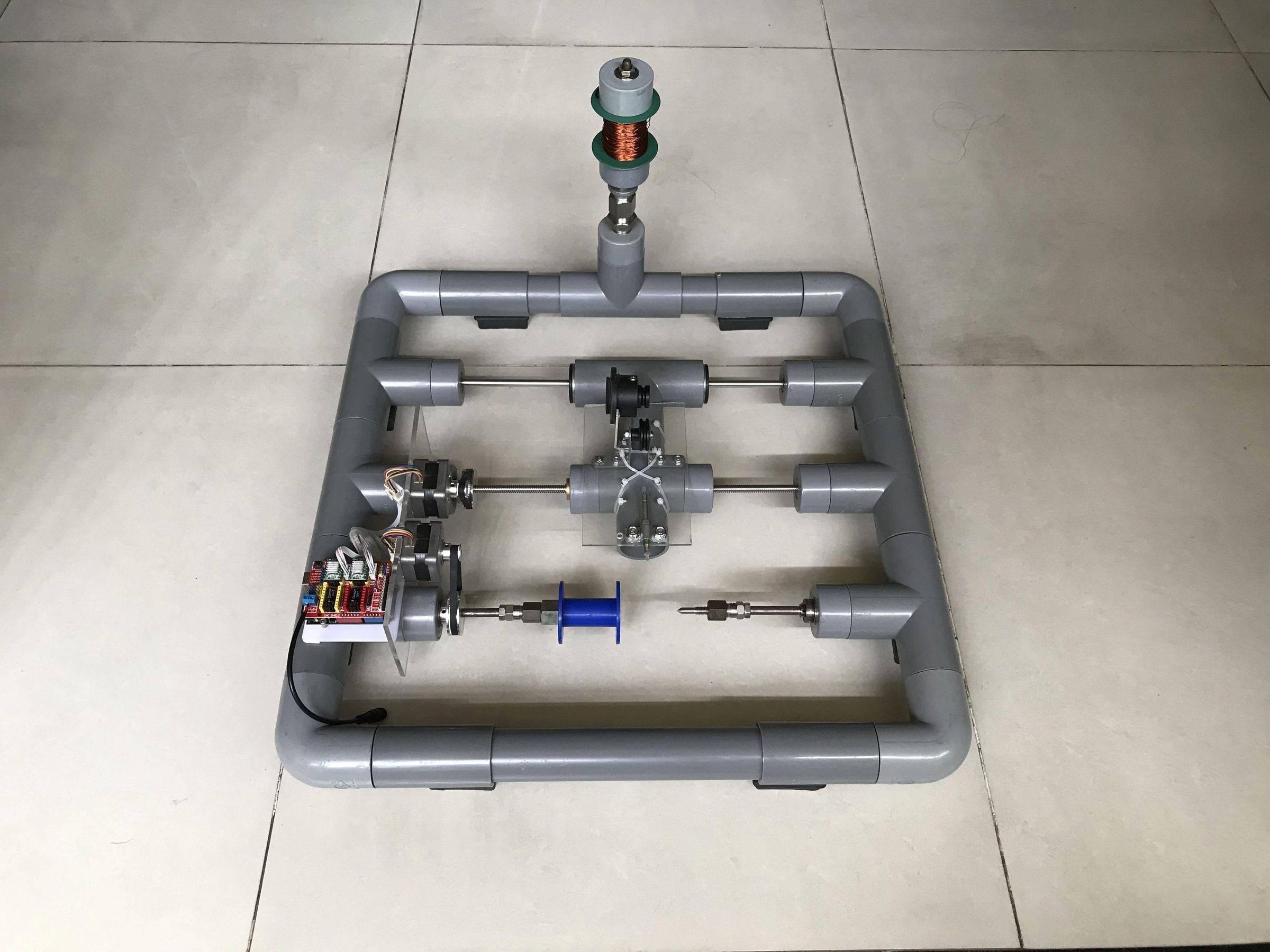

6. Building a uncoiling part

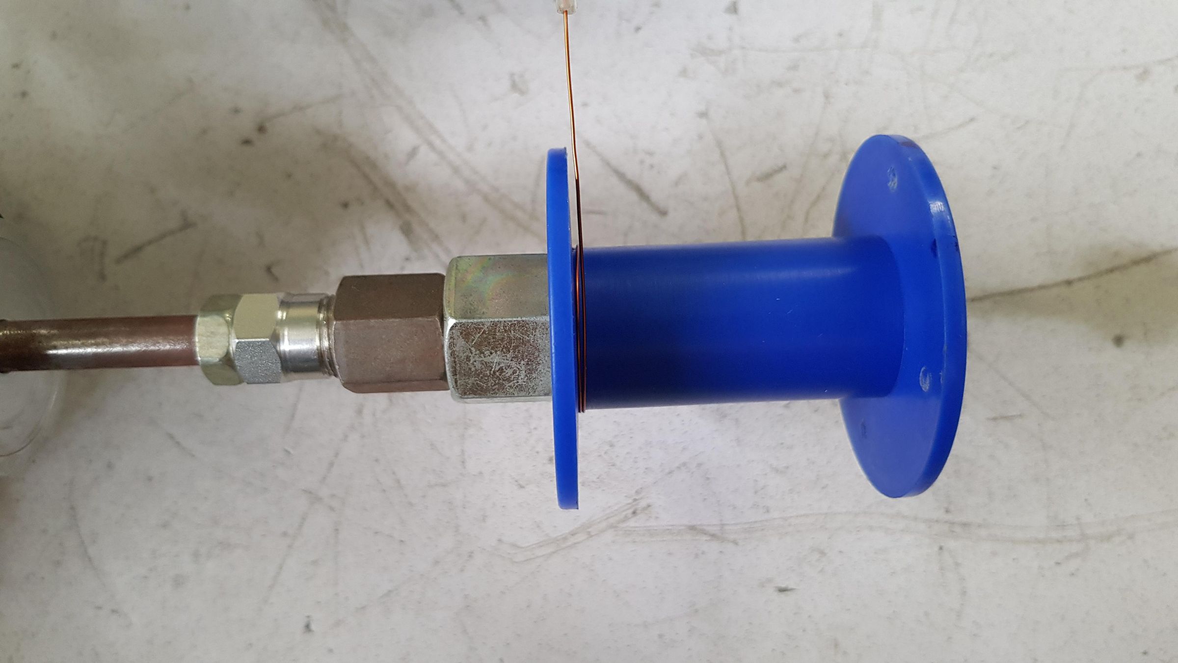

For uncoiling part, I used a bolt and tighten the copper coil by 2 end caps. It can rotate with a specific friction based on tighten force.
One empty spool was also connected to spindle shaft.
It looks not bad!!!
7. Building tension guide roller and copper feeder pipe.
I used some L steel supports to mount 2 rubber rollers on one acrylic sheet, then installed this tension guide roller to feeder axis

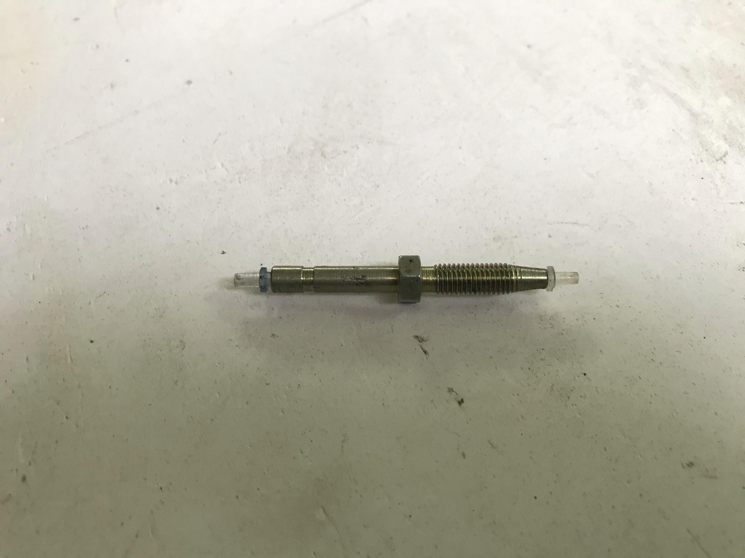

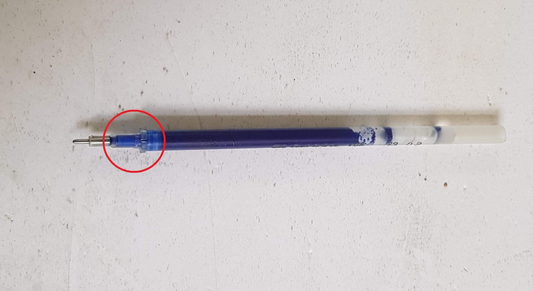

To feed the copper wire to spindle, I used one small steel pipe and inserted 2 plastic pen tips at 2 ends.
Plastic pen tips was taken from this.
Finally, I connected wires from stepper motors to CNC shield.
DONE!!!
The uncoiling part can be arranged like this, by adding one more PVC elbow. It's easy to be rotated to get the best feeding direction.

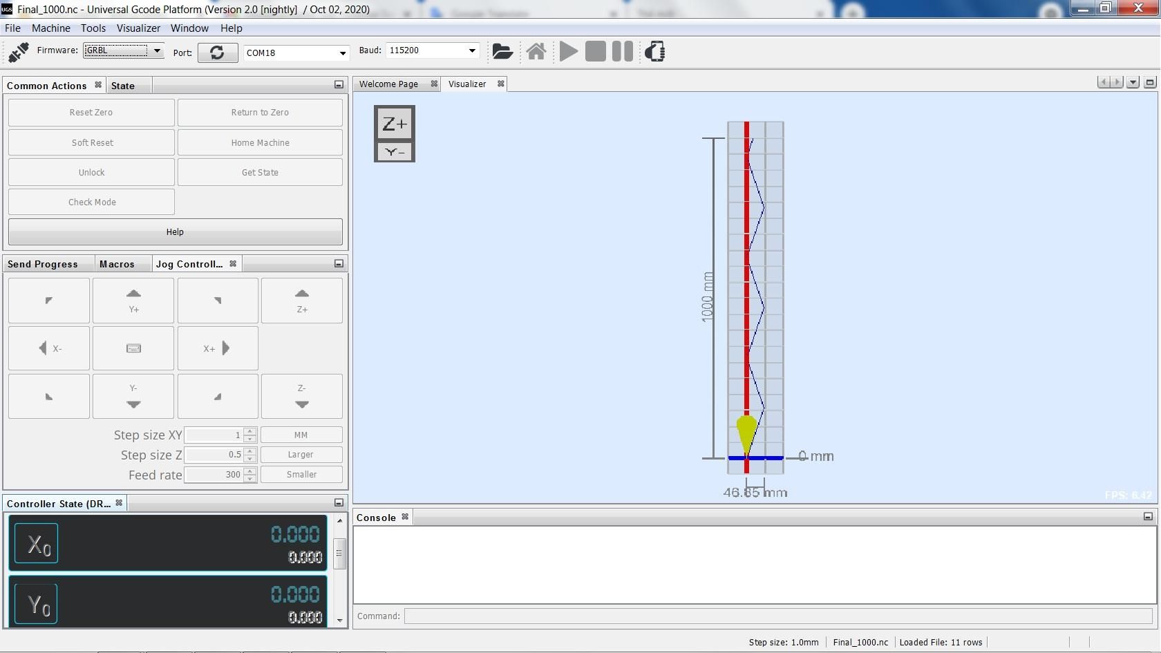

2. Universal GCode Platform (UGS):
- Open Universal Gcode Platform, select Port and set Baud to 115200, click on Connect tab.
- Select the appropriate position by moving X axis left - right, rotating Y axis clockwise - counter clock wise.
- Set the original coordinates by button Reset Zero.

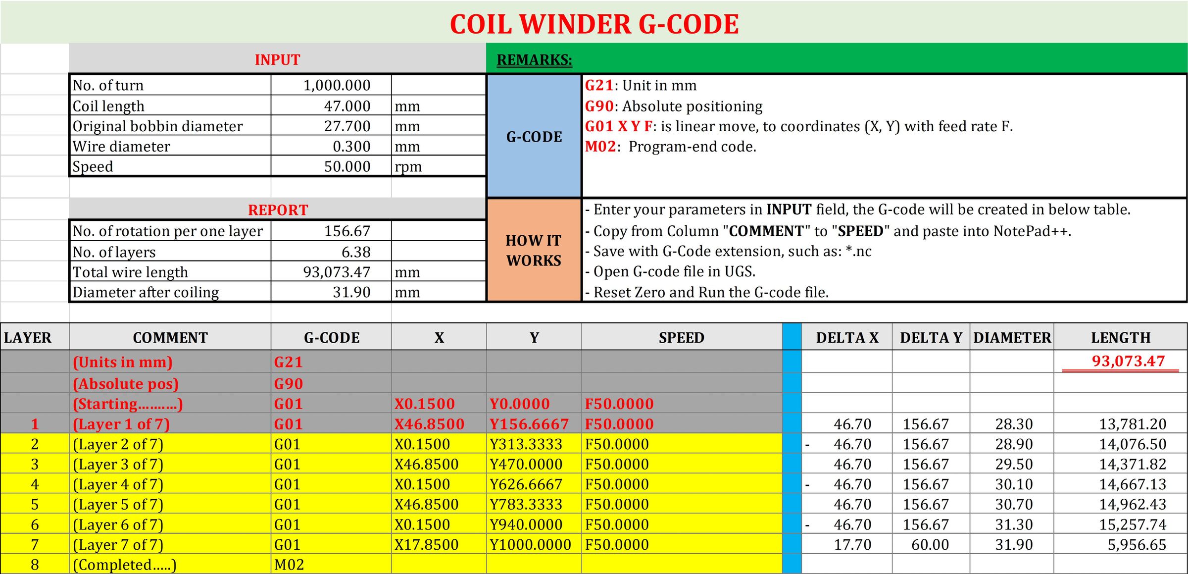

My winder works with cylindrical coils and based on GRBL firmware. To wind a copper wire in the cylindrical shape, we need the following parameters, I should give specific example:
- No. of turn: 1000.
- Coil length: 47 (mm).
- Original bobbin diameter: 27.7 (mm).
- Wire diameter: 0.3 (mm).
- Speed: 50 (rpm).
Thus, we need to stack 1000 turns of wire diameter 0.3mm in layers on a empty spool that has a length 47mm and an original diameter 27.7mm.
The major calculation is as below:
- No. of turn per one layer = Coil length/ Wire diameter = 47 / 0.3 = 156.67.
- No. of layers = Total no. of turn/ No. of turn per one layer = 1000 / 156.67 = 6.38.
To use GRBL firmware, my idea is like this:
- Feeder axis: will move right and left in the range from 0 to 47mm, with 6.38 times and its STEP/mm parameter is precisely defined according to the GRBL firmware. It will reverse when the spindle axis rotates exactly by a multiple of 156.67, that means, when one layer is completed.
- Spindle axis: will rotate exactly 1000 revolutions and then stop. Its setting in the GRBL firmware is STEP/rev. Note that is STEP/revolutions, not STEP/mm.
Because the copper wire diameter is 0.3mm, so the feeder axis would move between 0.15 and 46.85mm (minus the wire radius at 2 edges).

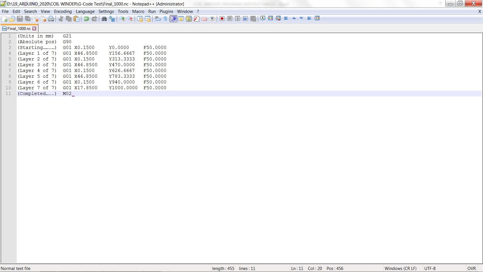

G-code
Following to the example above, there are a total of 6.38 layers, so the last 0.38 layer (layer 7) has 0.38 x 156.667= 60 revolutions. That means spindle axis will rotate 60 revolutions and feeder axis will move to (60*0.3 - 0.15) = 17.85 from 0.15. The feeder movement rule is:
- Odd Layer: From 0.15 to 46.85 (Move Right).
- Even Layer: From 46.85 to 0.15 (Move Left).
Coil winder G-Code can be specified as follows, with feed rate 50. On the next step, I will explain how to generate G-code automatically by Excel template.
| COMMENT | G-CODE | X | Y | SPEED |
(Starting...…) | G01 | X0.1500 | Y0.0000 | F50.0000 |
(Layer 1 of 7) | G01 | X46.8500 | Y156.6667 | F50.0000 |
(Layer 2 of 7) | G01 | X0.1500 | Y313.3333 | F50.0000 |
(Layer 3 of 7) | G01 | X46.8500 | Y470.0000 | F50.0000 |
(Layer 4 of 7) | G01 | X0.1500 | Y626.6667 | F50.0000 |
(Layer 5 of 7) | G01 | X46.8500 | Y783.3333 | F50.0000 |
(Layer 6 of 7) | G01 | X0.1500 | Y940.0000 | F50.0000 |
(Layer 7 of 7) | G01 | X17.8500 | Y1000.0000 | F50.0000 |

Step 6: G-Code for Coil Winder
I wrote a small program in Microsoft Excel to generate G-Code and it worked fine with my coil winder. We can change the input parameters: no. of turns, coil length and diameter, wire diameter and speed to get corresponding G-code. If you want to try it, you should lower the feed rate and run the simulation before attaching the copper wire to the spindle axis.
After entering the necessary parameters, Excel will generate command lines containing G-code. I just copied them into Notepad++ and opened it in UGS then run the program.
It looked like this when I opened G-code file in UGS. Its graphs are linear lines, with 2 end operating points: 1000mm and 46.85mm in Y and X axis. As discussed in the previous steps, 1000mm in this case is 1000 revolutions since I have set $101 as STEP/rev (4800).
In the Excel program, I have added some more calculations in the "REPORT" field.
- Total wire length.
- Diameter after coiling.
Regarding to the number of command lines, it is no problem with Excel at all.

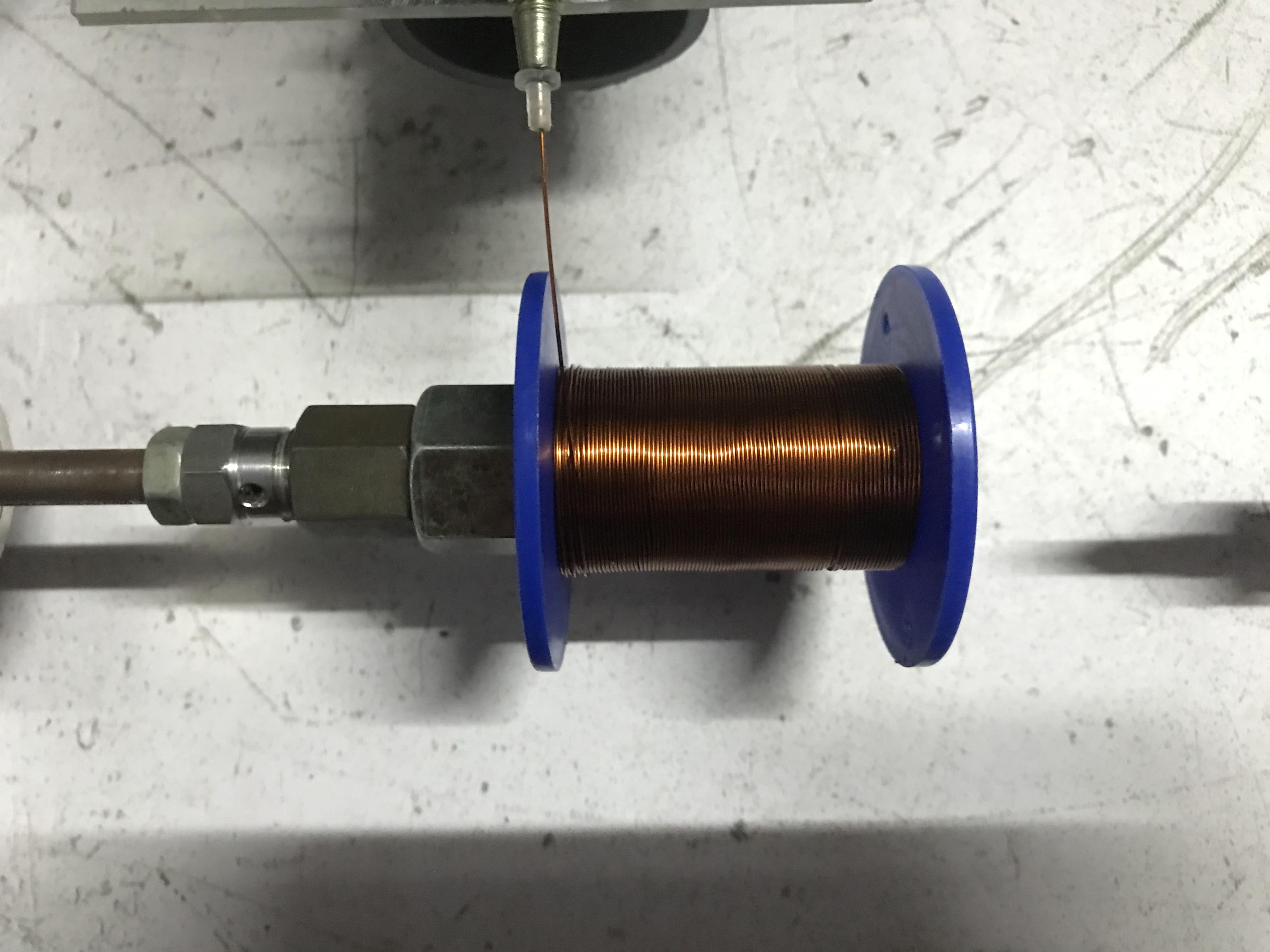

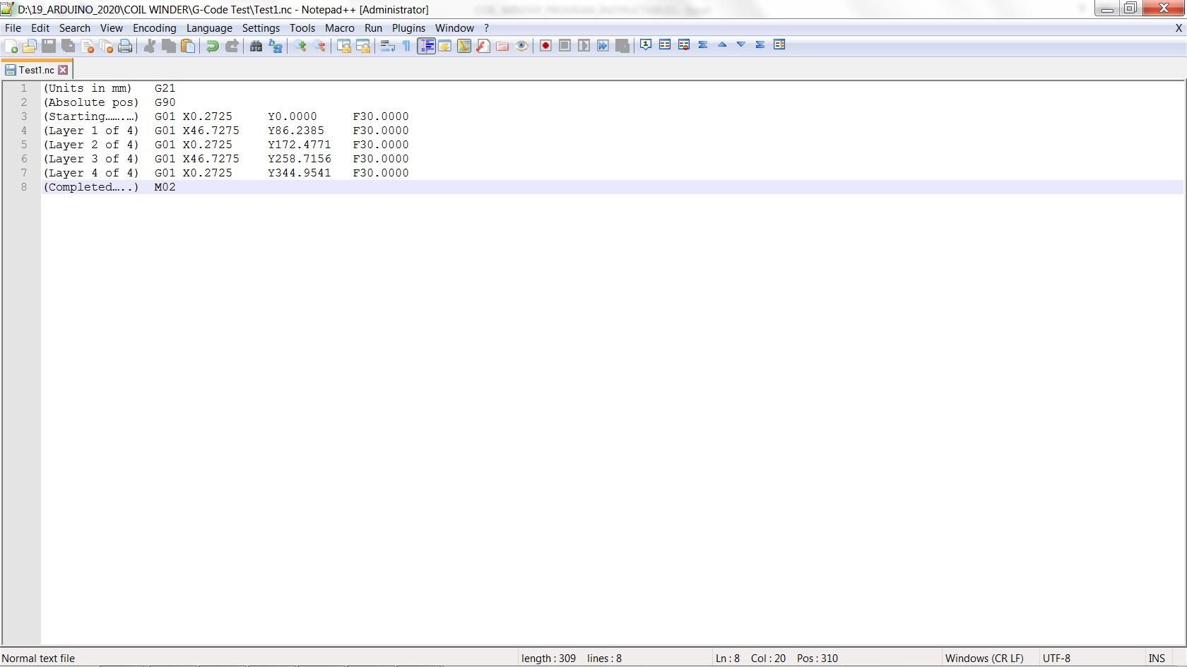

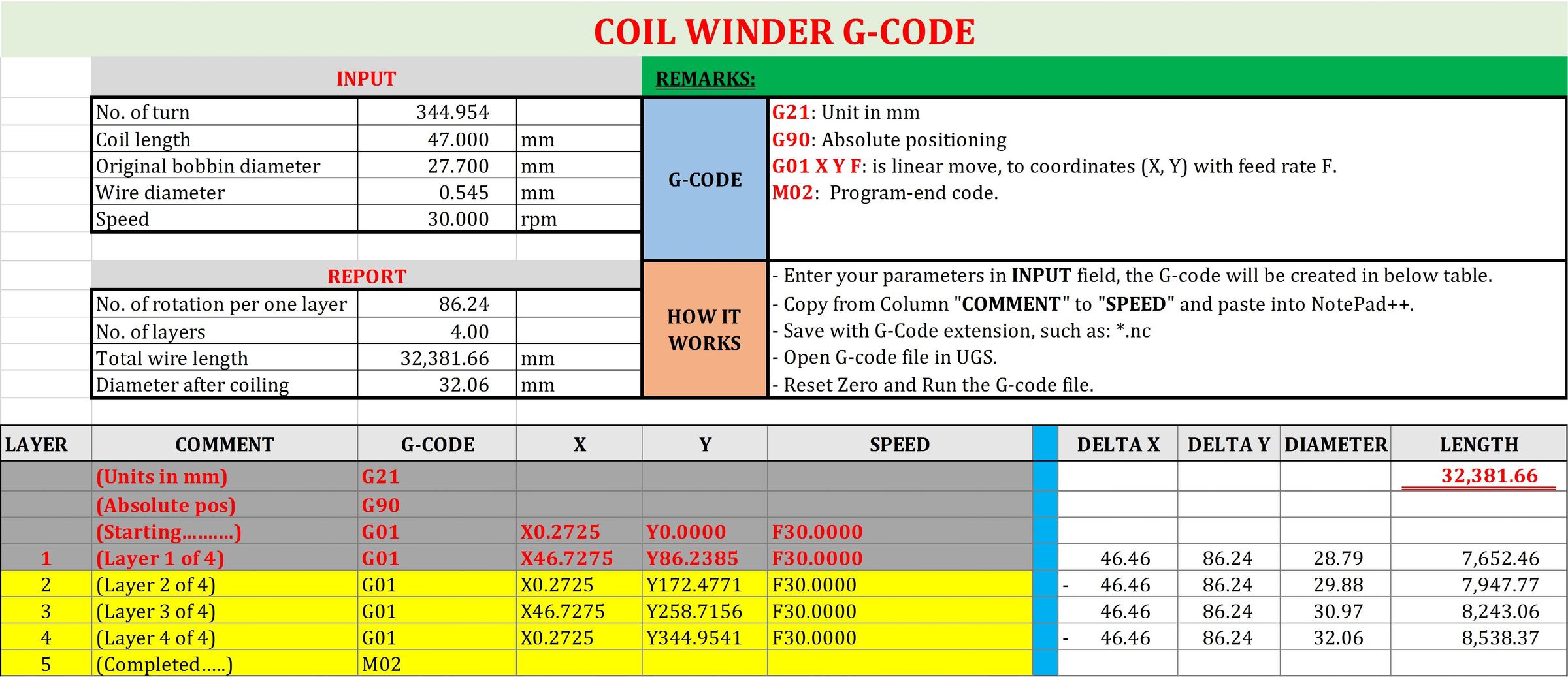

I tested with copper wire diameter 0.5mm with 4 layers, and total no. of turns 345, as below picture . The wire diameter entered into the Excel file should be slightly bigger than the actual diameter, in my case: 0.545mm. Because two adjacent turns of wire could not be able to touch each other exactly 100%, there is always a small gap between them.
Then I copied the G-codes from Excel to Notepad++ and run them in UGS.
We should watch out when the coil winder works in the first layer. If it has a big gap between two adjacent turns, then in the second layer, copper wire will insert into this gap due to tension and affect the whole coil structure.
If you want a perfect coil, then you need to pay attention when the feeder axis reverses because the wire can get tangled at that time. And we can add a G-code command to stop the machine for a specific time, at each feeder reversal time, and make correction, like this:
G04 P5 (It makes the coiling winder stop for a specified time - 5 seconds in this case)
Results achieved as far as the parameters above.
