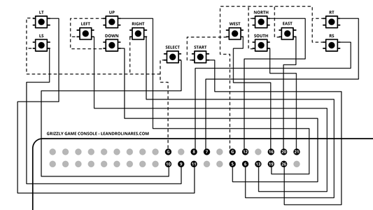

Step 3: Add Your Own Custom Buttons.
- Add all the tactile buttons to the breadboard and wire one of the legs to the ground row (-) of the board.
- Connect the other leg of the buttons (+) to a pin on the Rasbperry Pi using jumper wires. You can connect any button to any available pin but it's important to take note of which buttons you connect to which pins.
- Check out the pins I used here
- Connect to Wi-Fi following the official docs:
- RetroPie → WIFI → Connect to WiFi network
- Access the Raspberry Pi command line either locally by pressing F4 while in RetroPie, or remotely by enabling SSH, assigning a static IP, and running on your computer: ($ ssh pi@192.168.X.X)
- Install the Adafruit-Retrogame utility, which enables you to map the GPIO pins to work as a virtual keyboard. From the Raspberry Pi's command line, download Adafruit's script file retrogame.sh and execute it:($ curl https://raw.githubusercontent.com/adafruit/Raspberry-Pi-Installer-Scripts/master/retrogame.sh > retrogame.sh $ sudo bash retrogame.sh) You will be prompted to select a configuration. Choose any option and follow the steps to reboot.
- After rebooting, access the command line again and edit the retrogame.cfg file to map the GPIO pins to the keys you configured in step 2:($ sudo nano /boot/retrogame.cfg) There is an example of my retrogame.cfg file here. For a list of all the possible key IDs take a look at Retrogame's keyTable.h file.
- Save the changes and exit Nano. You can do both at the same time by pressing ctrl + X.
- Reboot the console and check that everything works as expected. ($ sudo reboot) You should be able to navigate the interface, start games, and play them using your custom gamepad.

- Solder one leg (-) of each button in series, connecting all of them together.
- Solder the opposite leg (+) of each button to a GPIO pin on the PiSugar header. Make sure you connect them to the same pins you chose on step 3.
