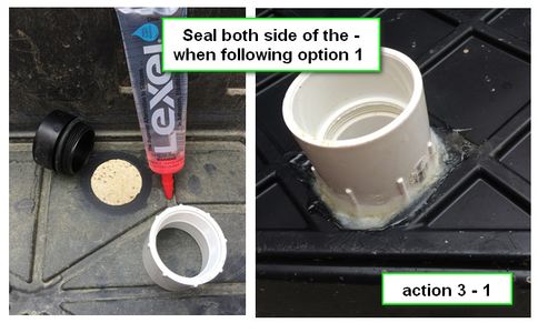

ACTION 5 -- 2 OPTIONS AT THIS POINT FOR SEALING HOLE
First option is the DIY option --
Using rubber washers insert PVC Lock through them. Use of Lexel will be needed as this option does not seal with out the adhesive. If "FOOD GRADE" quality is wanted the adhesive will need to be treated with Ruberize-IT as the adhesive is not food grade material.
Second Option -- USING THE "SEAL KIT"
A grow-bed "SEAL KIT" can be purchase at AGponics Store -- select Store tab
Either option used requires the 1 1/2 bushing to be threaded on to the PVC Lock fitting on the bottom side of the grow-bed.
If Option 1 is used the bushing needs to have adhesive placed between the tote opening and flat end of the bushing to seal.
If Option 2 is used a second silicon 100% food grade seal is placed on the threaded end of the PVC Lock fitting on the bottom side of the grow-bed as well as inside the grow-bed side. Hand tighten the 1 1/2 bushing to the PVC Lock fitting and the connection will seal

ACTION 3 -- 2 OPTIONS AT THIS POINT FOR SEALING HOLE
First option is the DIY option -- Using the 2.25 or 57 MM O-Ring. Place the O-Ring on the 2 " ABS adapter. Screw into the 2.25 inch hole that was created in ACTION 2. Use of Lexel will be needed as this option does not seal with out the adhesive. If "FOOD GRADE" quality is wanted the adhesive will need to be treated with Rubberize-IT as the adhesive is not food grade material.
Second Option -- USING THE "SEAL KIT" A grow-bed "SEAL KIT" can be purchase at AGponics Store - select "AGponics Store" tab -- select Store tab.
Either option used requires the 2 inch T X S coupling to be threaded on to the threaded end of the 2 inch adapter that has been threaded into the bottom of the grow-bed.
If Option 1 is used the coupling needs to have adhesive placed between the tote opening and flat end of the coupling to seal.
If Option 2 is used a second silicon 100% food grade seal is placed on the threaded end of the 2 inch adapter fitting on the inside of the grow-bed side. Just hand tighten the 2 inch coupling on to the 2 inch threaded adapter the extends out the bottom of the grow-bed the connection will seal and it will be water tight.

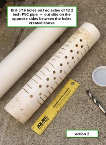

ACTION 2 --
Drill 5/16 holes on two sides of 12 2 inch PVC pipe -- cut slits on the opposite sides between the holes created above.

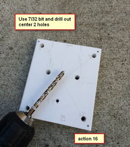

ACTION 2 --
Lay out the BLOCK for holes.
ACTION 3 --
Drill 3/64 hole in upper left corner of the Block and Cover Plate.
ACTION 4 --
Align and screw in the #2 - 3/8 Flat head screw in the holes created in ACTION 3.
ACTION 5 --
Trim off the extra Cover Plate material from around block to match up with Block.
ACTION 6 --
Drill and add the 3 other Cover Plate positioning screws.
ACTION 7 --
Use 1/8 inch bit and drill holes through the block at layout locations marks.
ACTION 8 --
Turn Block over -- drill with the 1/4-Inch Forstner Bit at the 6 locations - only go into the Block the depth of the body of the bit.
ACTION 9 --
Center Block on DRAIN side of tote - right under handle at top of tote.
ACTION 10 --
Using the lower-right 1/8 as a pilot hole -- drill 1/8 hole through tote side.
ACTION 11 --
From inside tote screw in the #8-32 X 1.25 inch Stainless Steel screw
on outside thread Nylon Nut onto screw end and tighten fully.
When tightened very tight there will be no leaks.
Make sure to remove any extra plastic drill fragments so the screw and nut will seal.
Should water leak from this screw on the outside at any time - just seal with Lexel and the problem will go away.
ACTION 12 --
Repeat ACTIONS 10 & 11 -- 3 more times for each corner of the block.
ACTION 13 --
Drill out the 4 corner holes with a 7/32 bit - this will allow the Block to slide on to the mounting screws and over the nylon nuts and sit flush against the tote body.
ACTION 14 --
Mount the Block onto the grow-bed using the mounting screws as guides -- the block will sit flush with the side of the grow-bed because of the 1/4 holes on the back side of the block created in ACTION 8
ACTION 15 --
Using 1/8 inch bit drill and the Block as a guide -- Make the triangle configuration of holes to duplicate the ones in the center of the Block -- the grow-bed pattern will match the Block pattern if done correctly.
ACTION 16 --
Use 7/32 bit and drill out center 2 holes.

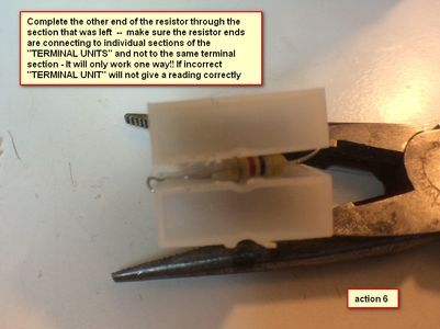

ACTION 2 --
Make two (2) individual "TERMINAL UNITS" from the larger terminal block that was scourced
ACTION 3 --
Cut out a small amount plastic from of the bottom of the "TERMINAL UNITS" created in ACTION 2 between the individual sections of the "TERMINAL UNIT".
ACTION 4 --
Press resistor into gap created in ACTION 3 - bend wire opposite directions around each terminal section.
ACTION 5 --
Bend resistor wire 180 degrees and insert resistor wire through gap between metal terminal holder and plastic housing - resistor wire will come out the other end. Now bend the end sticking out back on to metal terminal holder and solider for the best connection
ACTION 6 --
Complete the other end of the resistor through the section that was left -- make sure the resistor ends are connecting to individual sections of the "TERMINAL UNITS" and not to the same terminal section - It will only work one way!! If incorrect "TERMINAL UNIT" will not give a reading correctly.
ACTION 7 --
TEST - connection works.

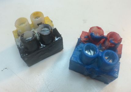

ACTION 8 --
Mix Magic-Sculpt.
ACTION 9 --
Fill in the Terminal Unit gaps with Magic-Sculpt - allow to harden over night
ACTION 10 --
To make things easier color coding is helpful:
DS18B20 needs a "PULL-UP" 4.7K ohm resistor Media Probe needs a "PULL-DOWN" 10K ohm resistor.
Media Probe - Signal "PULL-DOWN" -- 10K ohm resistor (Yellow) -- ANALOG PIN
( - ) Ground (black) "PULL-DOWN" -- 10K ohm resistor
( + ) Positive (red) "PULL-UP" -- 4.7K ohm resistor
DS18B20 - Signal "PULL-UP" -- 4.7K ohm resistor (Blue) - DIGITAL PIN

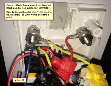

ACTION 7 --
Insert RJ-45 jack into housing.
ACTION 8 --
Add blank insert at position 2.
ACTION 9 --
Pull DS18B20 wires through RJ-45 housing - between jack and blank.
ACTION 10 --
Position nylon lock nuts and tighten until housing is held firmly against Transition Block.
ACTION 11 --
Add Magic-Sculpt to opening on the RJ-45 housing.
ACTION 12 --
Connect Media Probe wires from Terminal Blocks as directed in Connect MAP STEP.
Use 2 additional nylon nuts to hold the connectors in place and tight.
It really does not matter which wire goes to which screw - do what works best at this point.
ACTION 13 --
Connect DS18B20 wires as directed in Connection MAP STEP.
ACTION 14 --
Carefully tuck in all terminals and wires into RJ-45 housing free space.
ACTION 15 --
With Magic-Sculpt fill in the open areas of the RJ-45 housing cover.
ACTION 16 --
Carefully position and attatch RJ-45 housing cover to RJ-45 housing base.
TEST - TEST - TEST - TEST the sensors and connections now.
If a any problem reading sensors FIX THE ISSUES NOW!!
ACTION 17 --
Once all connections are TESTED and proven to be working add the mounting nuts and screws to hold the Cover Plate of the Transition Black firmly in place.
ACTION 18 -- OPTIONAL
To protect the Sensor connections form moisture issues Rubberize-IT can be applied to the RJ45 Housing and Transition Block to prevent moisture getting into the assembly. OPTIONAL STEP
