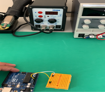

Step 3: Step One Power Connection
Initially link the 5V and GND output from Arduino and place both connections on the breadboard lines, after that connect VIN and GND to the reset of the components by connecting them to the breadboard voltage and ground lines.

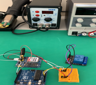

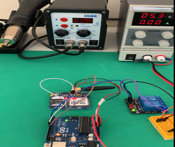

Step 4: Step Two Connections and SIM Card
The second step it to connect the reset of the links to the circuit, by connecting TX and RX from the sim900a to the Arduino and connect IN from the relay module to the Arduino. Follow the figure as the links are specified in the table in the system block diagram section. After that insert the SIM card in the GSM sim900, make sure the card is properly fit in the slot and it does not have PIN number, also it shall have enough balance to send SMS.

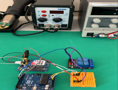

Step 6: Final Testing
At this stage the system is ready to be tested, first reconnect the power back to the sim900, then use the adapter to power the Arduino. Then power on the system and wait until the GSM pairs with the network. First send SMS ON to the system and notice the change in behavior on the relay module, then send SMS OFF to the system and check out the change in the relay module. In order to check the state of the system send SMS STATE and the system will relay by relay on or off.
