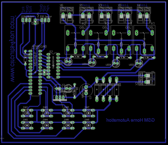

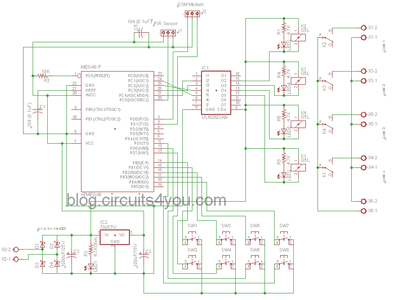

Step 2: Circuit Design and PCB Manufacturing
