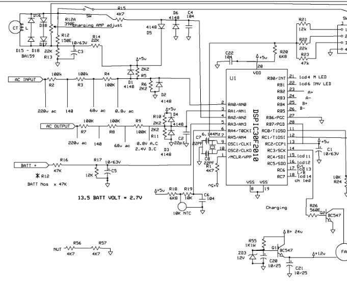

Step 2: CIRCUIT DIAGRAM AND PROTEUS SIMULATION

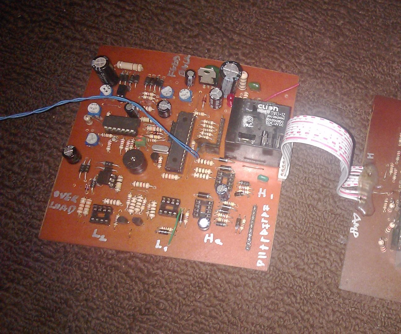

Step 5: PCB CONSTUCTION
Step 6: CHECK AND TEST OF SERIAL COMM. WITHOUT SIM908
Step 7: FINALIZATION AND TESTING
