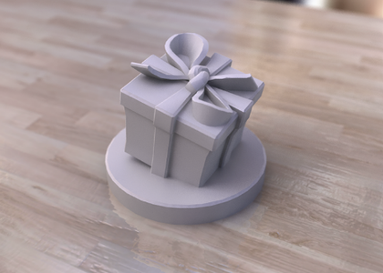

For the final project, I would like to create a gift-shaped hollowed house that contains a series of furniture. If there’ s more time left, I also plan to create a match box-shaped storage box. The house can be considered as a decorated box. The highlight for this model is the opening and closure of the box.
After the assignment about making a press-fit kit, I want to try more forms of connection fit like a drawer or box in which you can pull or rotate some parts of the module. And one day I came across a cute gift box model which inspired me to design the exterior of the box to be a gift shape. But for the interior design, I plan to go with a small house structure that has hallowed walls with windows.
