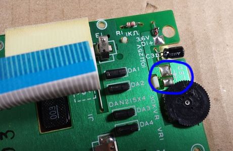

Open your Game Boy by removing the 6 tri-wing screws on the back panel. Also remove the Phillips head screws connecting the front PCB to the front shell. Separate the two units and locate the LED. Use a solder wick to remove the solder around the led leads. Remove the LED.

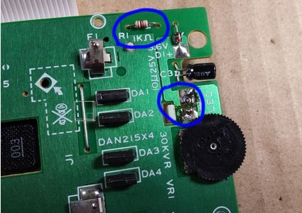

Step 1: Replace Existing Resistor
You will need to replace the "R1" resistor located near the top of the PCB. Use your soldering wick again to remove the excess solder on the front of the PCB. Replace this resistor with a 2K-3K ohm resistor to reduce the brightness of the LED. Otherwise it would be much too bright. Solder the LED and the resistor in place and you are off to the races. Close her up and enjoy.
