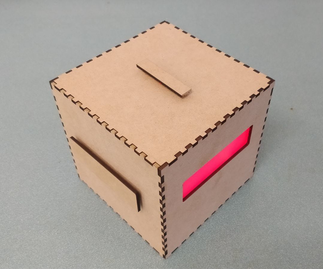

Introduction: Game Boy Reader Controller
In this Instructable I will try to explain how I made the device above.
It functions as a Game Boy cartridge reader, which can read the ROM and read/write the RAM of a Game Boy game.
Afterwards the game will automatically boot so you can play it on your computer. This currently only works on Windows.
