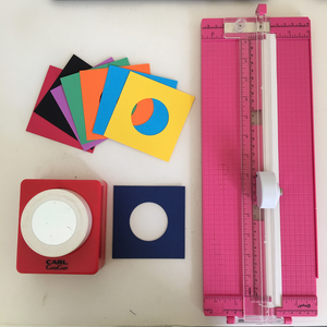

Cut 6 coloured pieces of card into squares with holes in them, I used a craft punch for the holes.
  • red
  • orange
  • yellow
  • green
  • blue
  • light blue

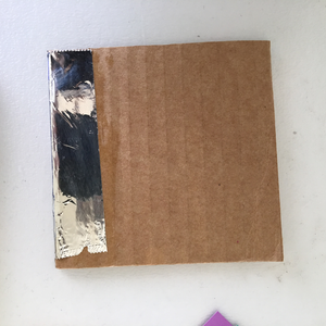

Cut 6 pieces of thicker cardboard as a base, the same size as the coloured cardboard, I used an old box.
Cut strips of aluminium foil, 3 cm longer than the square.

Stick the aluminium foil onto the thick cardboard, folding the longer part of the foil over 1 edge.

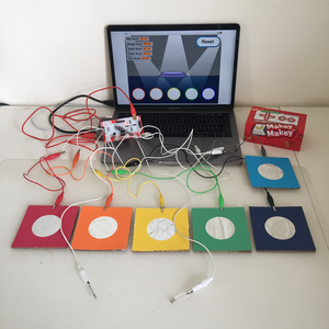

Step 5: Connect Makey Makey
  1. Connect the Makey Makey to the computer via USB
  2. Turn the Makey Makey over and connect the connector wires and alligator clips to the keys mentioned below and the buttons you have made, plus one to the space bar
  3. Connect 5 earthed wires

Step 6: Play a Game Using the Buzzers
Each child holds an earthed alligator clip and touches their coloured button.
If they have touched their button first, their colour will move to the centre of the screen and a sound will play.
To reset the buttons, press space bar.
