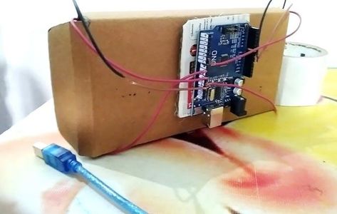

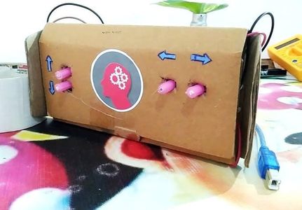

Step 4: ENCLOSURE
First Connect the circuit as shown in the schematic then place everything on a breadboard but do not connect it to the Arduino now. Use cardboard to cover the breadboard and add a little flavor to it(some stickers) and now place the Arduino to the back of the cardboard and connect all the wires to Arduino. And don't forget to put some holes in the cardboard for the pushbuttons. I also hot glued some pieces of pens to the pushbuttons so it will give some height and be much more comfortable.

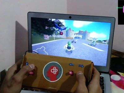

Step 5: Final Part
Just connect it to your computer and run the given python code then take a game and start playing voila!!!
Do not forget to install pyfirmata and keyboard
Game - SuperTuxKart
