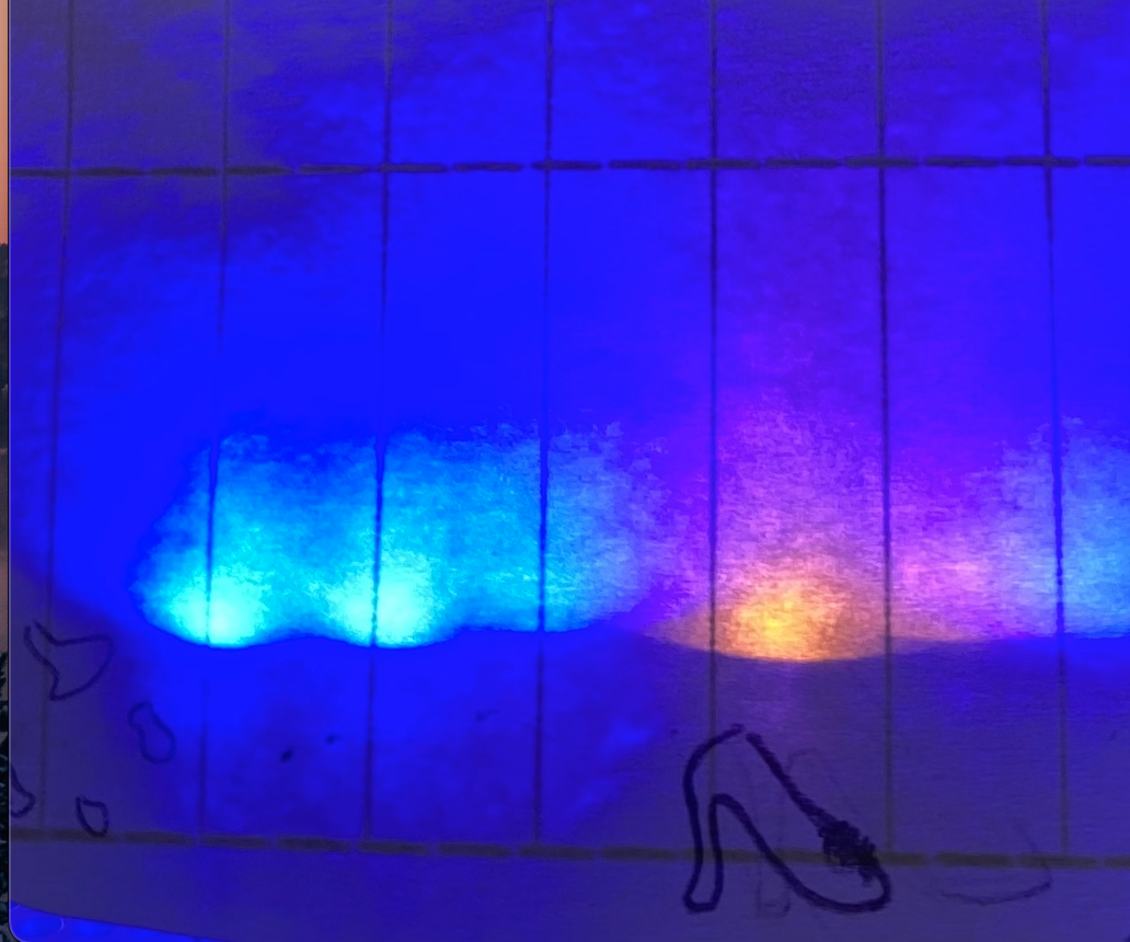

Introduction: Game Countdown Timer-LED Lights
Idea from: https://www.instructables.com/Flowing-LED-Lights-W...
About: I want to make this so that the players or contestants in a game can look at the light bulbs that is counting down and know that when the light in the last light bulb is out, it means the game has started.
Changes made: I changed the last "delay" time into 1000. The purpose is that then it can be a countdown timer for any contests.
