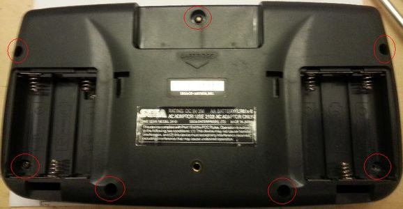

Flip over the GG so the screen is facing down. Make sure to have a napkin or tissue underneath the screen to avoid any scratching of the front screen (which a GG is very susceptible to). Remove the battery covers and the 6 Phillips head screws; refer to Figure (1) for details. The security screw in the cartridge slot is 4.5mm and is the only security screw in the entire unit. Once you have all the screws removed, remove the rear section of the case (3 connectors will keep the case from completely separating.

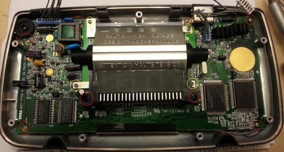

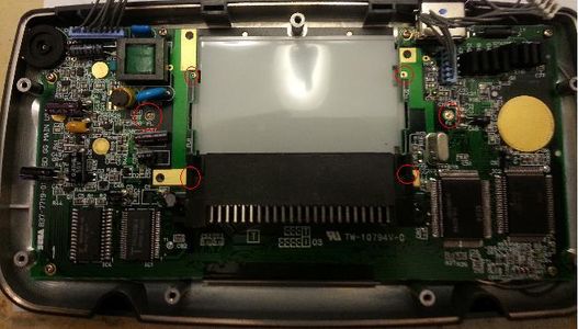

Now, we can see all the inner workings of the GG. There are 8 screws holding the board in the case. Refer to red circles in Figure (2) for the locations of the screws and remove them. At this point you have probably collected a fair number of screws, so hopefully you have them in an area where you can’t lose them. As you can see from the yellow circles in Figure (2), the reflective cover for the lighting tube is held on by 4 screws. This cover has to be removed in order to perform this mod.
Figure (2)

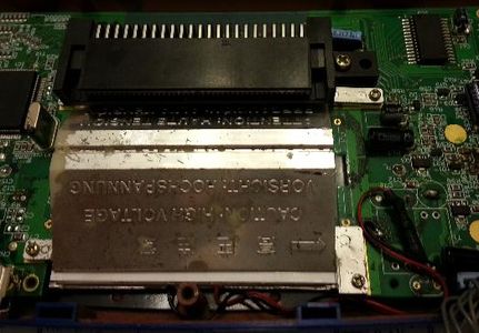

Remove the reflective cover to get access to the lighting tube, refer to Figure (3).
Figure (3)

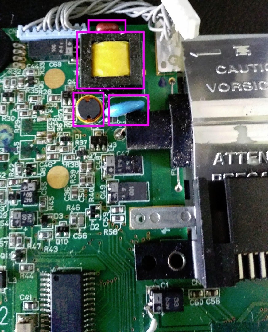

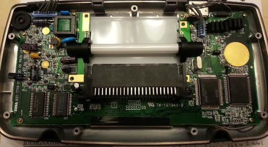

It’s now time to forever remove that power-hungry, battery sucking, monster of a tube. First, you will want to cut the 2 wires holding the tube to the board. There are also 2 resistors next to the ends of the tube, which are no longer needed and can be discarded. Figure (4) shows the location of the wires and resistors to cut. Once the tube and endcaps have been separated from the board, they can be thrown away. This is now the time to begin removing the extra components, which were part of the tube circuitry.
Step 2: Removal
** Images under maintenance**
There are many ways to remove these components from the board. The truly correct way would be to turn the board over and de-solder the parts from the back, but clipping them from the board is perfectly fine as long as there is no chance of a part shorting against something. Once all components are removed, it should look like Figure (6). There is also an area that must be jumpered (yellow line), as shown in the red box Figure (6), which can be done with either a big glob of solder or just a piece of wire. This will also allow the original brightness adjustment to still be used!

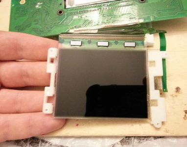

You will need to remove the white light diffuser from the back of the LCD screen. This can be accomplished by using an x-acto knife or razor blade and CAREFULLY slide it into the middle of the 2 pieces, as shown in Figure (8). Make sure you insert the razor on the same side as shown in the picture (the side with the most glue). Gently slide the razor up and down the glued area until the white diffuser separates from the LCD screen. Be very gentle with this step, the LCD screen is glass and can be easily broken.
Figure (8)

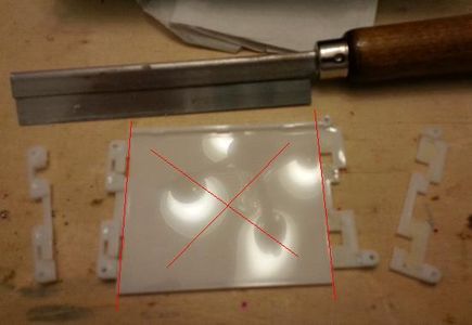

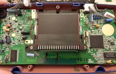

This white diffuser has to be cut in order for the backlight to fit. Take your straight saw and cut along the edges of the white diffuser as it shows with red lines in Figure (9). The center part of the diffuser can be tossed, but the 2 outside pieces need to be kept to be able to reattach the reflector cover.
Step 4: Install
Its time to begin reassembling the board and the LCD screen. Place the LCD screen back in its original position under the board. Take the 2 pieces of white diffuser cut from Figure (9) and place them back in their original location between the board and the LCD, as shown in Figure (10). They should somewhat grab the sides of the LCD screen as they did when they were whole. Line up the holes in the board with the holes in the pieces as best as you can, again refer to Figure (10). It is important to make sure the holes are lined up with the same placement as the reflective cover, since the reflective cover will be re-assembled to those holes later on.

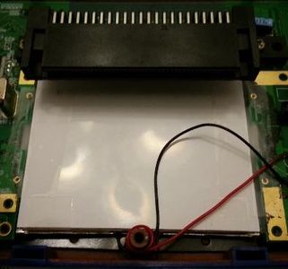

Finally, its time to install the backlight! Take the backlight and place it into the space where the white diffuser used to be. Make sure you keep the wires at the top of the unit and that the backlight itself is facing the right way (the opaque part is face down towards the screen and the white part is up facing you). See Figure (11) for details.
Step 5: Resistor

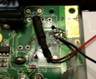

If you have a different PCB than the one shown, solder the resistor to the one in the middle of the 5 leads.
