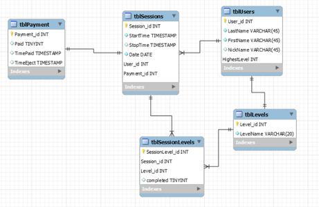

Step 1: Create the Database
If you have sensors that collect data you will want to save that data into a database. In this step we will make that database. The database we will make will contain 5 tables. In the picture above you can see the ERD of the database. This is the structure of the database.
The first table is a table with all the users in so we can select the user that we want to play the game as on the website later, or scan in on the RFID. The 'user' entity will have an id to identify the user. The user will also have a first - and nastname and a nickname. The nickname will be unique to every user. The database will also keep track of the highest level the user has completed.
The second table will contain all the available levels. In my project i made 8 levels in total. These are levels 1 through 8. The number of the level indicates how many times the led's will light up. Every level has an id (the number of the level) and a name.
The third table is a session table where we will keep track of when a user logged in. This means the timestamp and date (the date is optional) of the moment the user is logged in. This table will also keep data on if the user paid or not.
The fourth table is a table to keep track of the payment system. This table will keep the time of a difference in value of the lightsensor. This means that if a coin is placed on this sensor, the coin will block the light. This means that someone paid. Afterwards you can take your coin back.
The last table will keep track of every level that is played within a session. While logged in as a user, you can play different levels. Each time a level starts, a record will be added in the database.

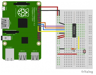

Step 3: Program the Second Sensor
For the second sensor I didnt use a library, just a coded class. I found a really usefull guide to program this sensor. If you follow it correctly it should work pretty quick.
https://tutorials-raspberrypi.com/photoresistor-br...
I let this class run every 10 seconds on a thread in my project and if there was a big difference in the result I collected the data and wrote it to the database. If you want to do this the difference has to be pretty big because the sensor will always differ with a few values even if you dont touch it (the sensor is sensitive).
To be able to read the light resistor you will need an analog/digital converter. This is the MCP3008. It is also important to connect an 10k ohm resistor with the light resistor. Don't forget this.
If you connect everything to the Raspberry Pi like told in the guild, you shuild be able to copy the code and run it smoothly.

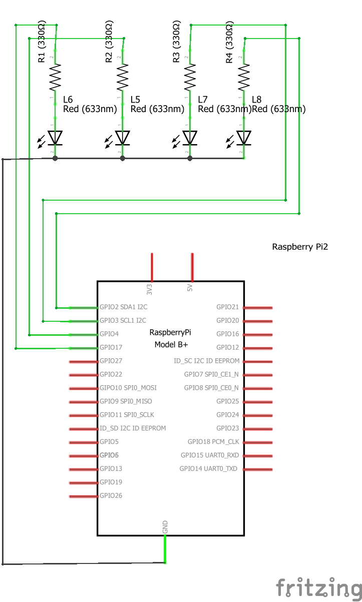

Step 5: Code the Leds
The last part of the electronical devices that we will program are the leds. There aren't that hard just like the joystick. In the scheme above you can see the pin layout i used for the leds. The pins are next to each other so it is easy to find all the leds on the Raspberry Pi, if you need to find them later on in the project to build it inside a casing.
I wrote the code when these pins are in use so if you connect them this way you can just use the code I wrote. If you used other pins you can just change the pins in the pin layout section of the code.
At the end of this class you can add the code from the joystick to it and create a class that will run a level when you give the level number as parameter to the function.

I also set the physical pin numbering next to it if you want to use this numbering instead. I also made led variables again to make the programming a bit more easy.
north_led = 2 # physical 3
east_led = 3 # physical 5
west_led = 17 # physical 11
south_led = 4 # physical 7
