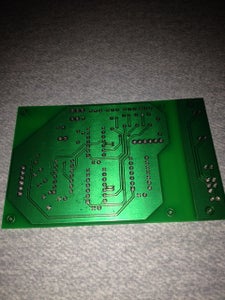

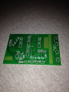

Step 5: Printed Circuit Board
A printed circuit board was designed to hold the components. It is a two sided board, where most of the bottom is left as a ground plane. This reduces the noise in the circuit during operation.
The board layout for creating the PCB is below. There is also attached a picture of an improved layout I developed. I manually laid out the printed circuit using ExpressPCB. The first one shown is the one I actually used in the build. The second one is a picture of an improved layout, where by using slightly different pins, I was able to create an orthogonal layout, simplifying wiring. Note that in version 2, I used a 4k7 resistor SIP instead of discrete components.
I have attached the ExpressPCB files in a zip file; note that version 2 has never been built and tested, but it has been validated.
