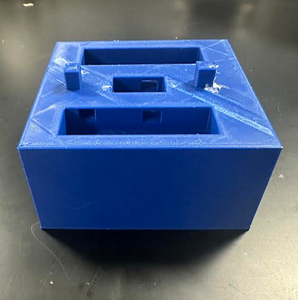

  6. 3D Printed Base - To hold the CPX and internals
  7. 3D Printed Dome - Covers the CPX to avoid damaging sensitive components
  8. 3D Printed Legs- Supports the dome
  9. Hot Glue Gun with Hot Glue - To attach the Dome to the Base
Step 1: Printing
Go into Tinkercad https://www.tinkercad.com/
  1. Upload each file and print them separately
  2. The Box
  3. The Dome
  4. Leg supports

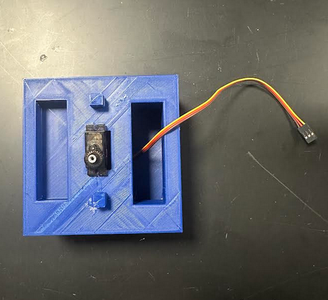

  1. place the motor into the blue base, leaving the wire poking out as shown

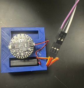

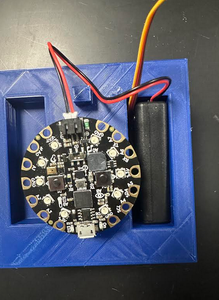

  2. slide the battery pack into the designated slot and connect it to the CPX

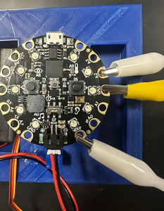

Connect the male end of the alligator clips to the female end of the servo motor
Put the CPX on top of the motor
Attach each alligator clip to the CPX onto the following:
  1. V-out
  2. GND
  3. A2

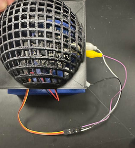

Glue the 4 support legs onto each corner of the base
Glue the dome onto the top of the support legs
