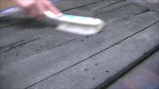

I saw another person on YouTube named Laura Kampf use this aging technique. Basically you sprinkle sawdust on to wet paint. You can see the close up of what it looks like and then the whole surface which shows the entire piece covered with sawdust.
Step 5:
Next I spray painted it black right on top of the sawdust. Once the black paint is dry then I brushed off the sawdust with a stiff shop brush. This leaves a weathered look that adds a layer of "character" to the background.
