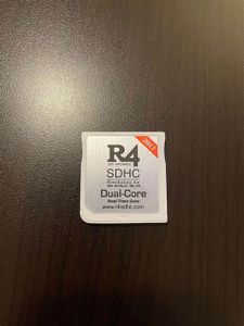

Step 2: Flash Custom Firmware to the DS Lite
I didn’t do anything exciting for this part, I just followed the instructions listed on the lost Nintendo History Website Lost-NDS-TV/fwpatch at main · LostNintendoHistory/Lost-NDS-TV · GitHub
This is a good guide too DS lite screen switching mod – Facelesstech (wordpress.com)
The main thing is that you need a flash cart like the ones below. Once you have done that, you should be able to go to the next step of disassembling!

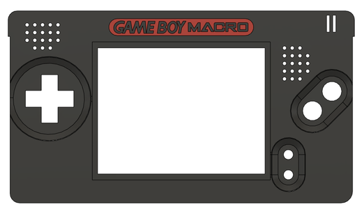

Step 4: Design and Print Out DS Lite Face Plate.
- I designed the front shell using Fusion 360. Using my trusty calipers and the ds lite shell, I went ahead and started modeling the front.
- One main challenge I had was covering the slot 1 cover to make room for the TRRS jack but still be seamless with the rest of the case. There was a lot of trial and error, but eventually I settled upon a fit that worked out well.
- I recommend getting it printed in Resin at JLC, it almost feels like it is injected molded with how smooth everything is.
- I never tried a final draft with FDM printing, so the tolerances may not suit that well.
- The STL is attached here.

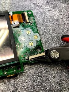

- Using a thin razor blade, or your flush cutters, you are going to remove this connector to make room for the switch speaker.
- You will want to desolder the proprietary jack Nintendo put on there. You can use a solder sucker or flush cutters to remove it.
- You will also want to use the flush cutters to remove the slot 1 for the DS lite cartridges.
- You want to do each of the 4 mounting points like circled here, and then you can bend it back and forth slowly to remove the pins that connect the cartridges to the motherboard. You don’t need this part anymore.
- Also, you will want to go ahead and sand down the light pipe to fit the new faceplate. I used flush cutters to make it slightly proud, and then I hand sanded them until they were flush with the front. You may need a dab of super glue to keep it in place. When you install it at the end

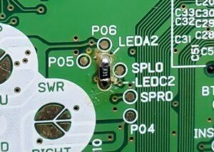

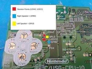

- Next you will want to go ahead and solder in the 330R 0805 Resistor as in the picture. This tricks the DS lite to thinking there is still an upper screen connected. I followed this guide when installing it Macro Tutorial (DS Lite) – Game Boy Macro

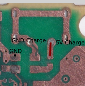

Step 6: Install USB C Board
1. I used the usbc board that can be found here GitHub - rorosaurus/nds-lite-usb-c: A USB-C port for the Nintendo DS Lite
2. Solder the necessary resistors and jack onto the PCB like the picture shown.
3. Next you will want to line up the board to the pads like the picture here.

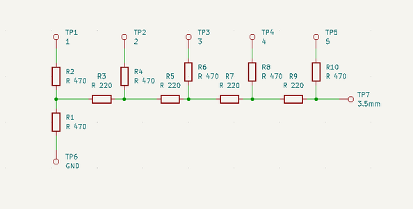

Step 7: Prepare the AV Out Board
- I designed the board in Kicad 7. You will need to order the board, I used JLC, I have the link to the gerbers here https://drive.google.com/drive/folders/1baJBIqonX8mu55CanD9qSCSAJhEqG4QE?usp=drive_link
- Solder the components like in the picture.
- I start with the resistors; you can follow the schematic here.

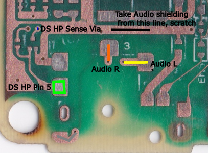

Step 8: Wire AV Board to DS Lite Motherboard
- Solder the pads like in the pictures using the magnet wire. The points on the pcb are labeled, and I have diagrams that show where each point goes.
- One thing to note, you will need to solder the “sense” pad to the “DS HP Pin 5” part in the diagram.
- Some tips when soldering magnet wire:
- Burn off the enamel coating with a blob of solder, so that you have a strong point of contact.
- You will want to scratch the vias with something sharp like a x-acto blade or fresh tweezers. This is to make sure there is fresh copper when making the connections.

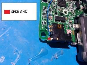

Step 10: Install Switch Speakers
- I put some Kapton tape on the back of each speaker to prevent shorts.
- I then put a dab of super glue on the back of each speaker.
- I placed the speakers in the front DS lite shell Faceplate so that the alignment would be correct.
- I then placed the DS Lite motherboard in place so that the speakers would be glued to the motherboard. This would make assembly and disassembly way easier.

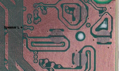

- Solder the switch speakers to the appropriate points on the motherboard as per the diagrams to preserve stereo sound.
