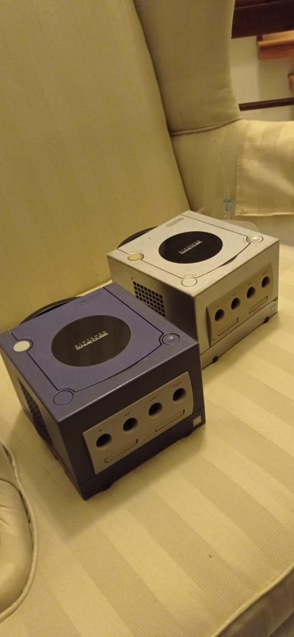

This guide follows the steps on how I repaired four gamecube's on which three of them were DOL 001 and one DOL 101 with basic tools and google knowledge.

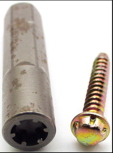

  1. Remove the four screws on the bottom with the special socket

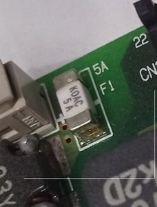

Step 2: DOL 101 Fuse Repair
Symptoms:
  • NO VIDEO
  • NO AUDIO
  • NO LED
  • FAN TURNS ON
Fix:
  1. After taking off the disc reader unit just check on the terminals on the side where the fuse is soldered there used to be a smaller fuse with "KOAC 5A" on it
  2. Check fuse with a multimeter on continuity setting if there is no continuity replace the fuse by removing the old one with a soldering iron and installing an electronics fuse as I did, you can find them in electronic stores easily.

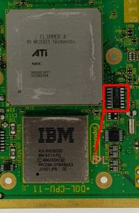

Step 4: DOL 001 Resolder Chip Fix
Symptoms:
  • NO VIDEO
  • NO AUDIO
  • LED TURNS ON
  • FAN TURNS ON
Fix:
  1. When you get to the main board, remove the heat sink screws and pull it upwards gently then you can locate the IPL chip
  2. Apply flux on all connections and resolder every pin by heating it up with the soldering iron be sure to clean after you finish with isopropyl alcohol

Test your console by just connecting it and see if it comes to life, in this case, the indigo Gamecube had no video, no audio, led turns on and fan turns on, problem but by just resoldering the IPL chip it's good as new.
