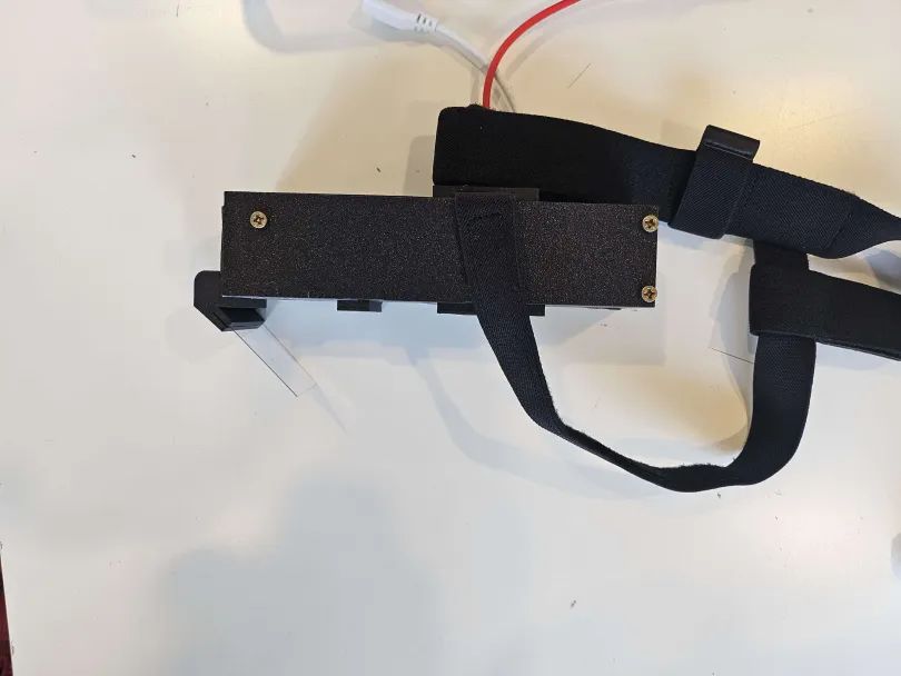

Step 4: The Case
I went trough several iterations of the case trying out different things.
I included the stl files of the final product I ended up using.
The pi zero 2 w can be screwed in the bottom using 2.5mm screws.
The screen can be screwed in with the screws that came with it.
On the latest version (the black one) you can see where the other parts can be mounted.
The slid going diagonally inside the box is where you can put the mirror.
The part that sticks out is where you can slide in the PET film.
On the outside you can slide in the magnifying glass for a bigger screen(optional)
The lid can be screwed on with 3 3mm screws.
The headband can be pushed trough the handle on the other side of the glasses.

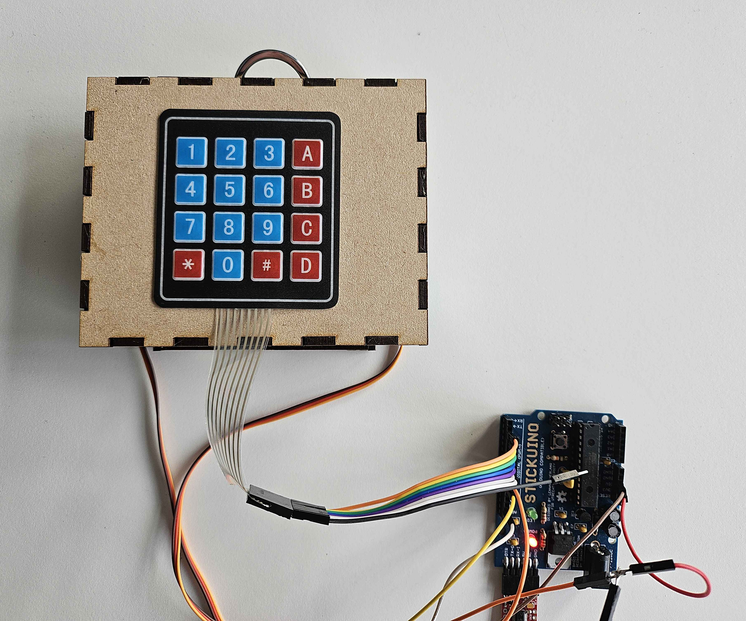

Step 6: The Controller Design
For the controller I wanted to make something inspired by the n64 controller. Why the n64? Because it is the most ergonomic controller for if you have 3 hands I guess and I find it funny.
I ended up cutting the Home button due to my button not working and I did not use the click function of the joystick because it is not that usefull.

Step 8: Making the Physical Controller
I made some tests to see how big the controller would become and if all the buttons would fit. After some iterations I arrived at the final version. Which had an issue, the pins for the screws in the bottom part were not high enough. For the top two pins I added in the 3mm screws and let the lid rest on them. For the 2 pins on the bottom I took them out and replaced them with an extra piece. From the panel I could use the 3mm screws and attach them to the extra pieces.
Step 9: Soldering the Controller
I put all the buttons into the top panel and soldered them from the bottom of the panel to the arduino shield.
Then I screwed the Arduino into the bottom using 3 mm screws.
I screwed the joystick onto the 4 pillars with the same type of screws.
The buttons can be put into the 2 holes.
I soldered the joystick and buttons with cables to the shield.
