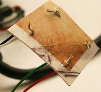

Step 4: Pokin' Holes
Poke four holes in the card and thread the wires through them.
Step 5: Tin Time!
Glue four pieces of tin foil, one for each corner over the wires.
They should almost meet in the middle.
Now glue a piece of foil in to the springy thing's bottom as shown...
It should be wide enough to span the gaps between all four...

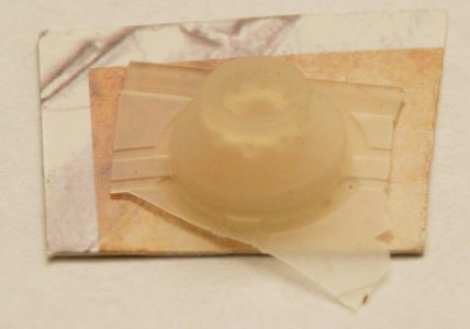

Step 6: Assemble the Button
Glue the spring over the tin foil contacts like the picture.
Plug it in to the computer and test it out on an open window...
Should do the trick - if not check all your connections...
